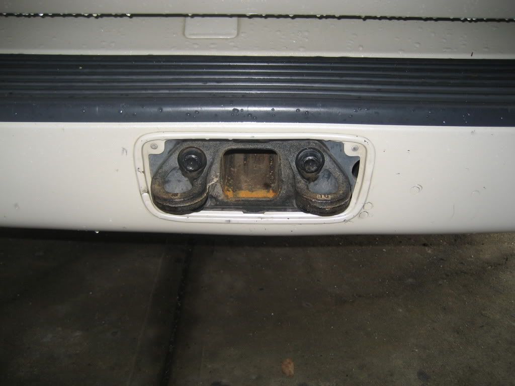

Does anyone know why they changed the style of OEM hitches? My LX had the hitch integrated into the rear bumper via 4 mounting bolts. Most 100's i see have the hitches as an add-on below the plastic bumper.
If this is the factory hitch you speak of, then the BIO bumper will not allow keeping it.
Good point ... didn't catch that the OP had an LX. The LC have the bolt holes for a cross member mounted hitch, but I have never seen a NA spec LC with the Lexus style hitch ...
The Slee bumper will not coexist with the pictured hitch without some significant mods ...
