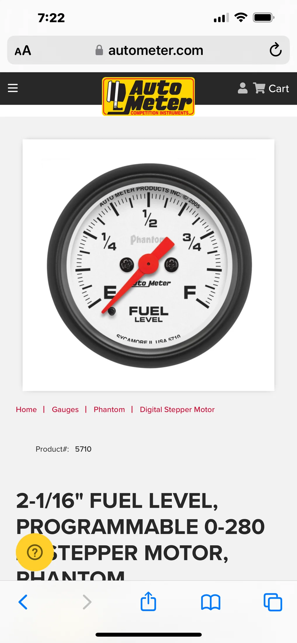

I have a 68 FJ40 with Auto Meter (Phantom) fuel gauge. It’s not playing well with OEM tank. Does anyone have experience with Auto Meter gauge or has a recommendation I should use to work with OEM tank?

The result is the same it swings it’s to full and stays there. I’m thinking I have a bad sending unit or the ohms output is too low for sensor to read correctly.

ATM-990345 or ATM-3262. These are the Autometer sending units part #'s from Summit Racing. I am not sure which one I used as it was many years ago. All of my gauges are electric. Happy to help!
And during the procedure it showed empty when empty and full after you filled it?
Have you tried either of the pre-programed civic calibrations?
I am not an expert on the auto meter fuel gauge, but the early FJ40 fuel sender is a voltage regulator, not a variable resistor. I assume the gauge is programmable for a range of resistances. The later FJ40 sender is a variable resistor and may work with your gauge.
Yep, that may be my issue. I didn’t know that about voltage regulator on early rigs.
It sounds like I’m fighting a loosing battle.
