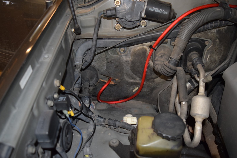

Big ass power wire because that's what all us Fast and Furious types need.
Found a good spot to breach the firewall. This comes out right under the glove box and makes it easy to run to the amp under the rug. Added rubber grommet and some silicone pooky to seal it up.

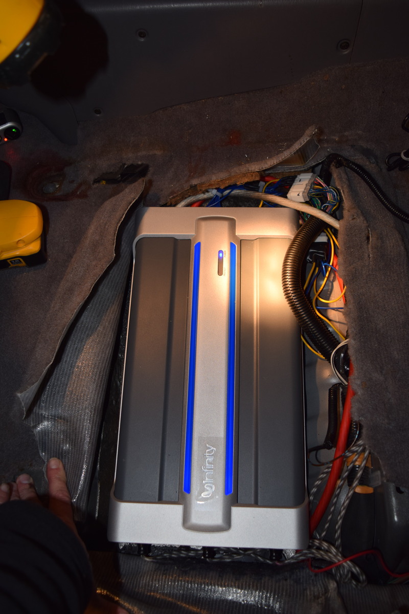

Amp fit just fine after removing the stock amp and brackets along with some foam ridges. And just a little carpet trimming.

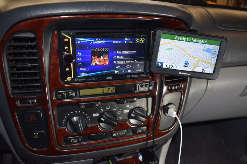

Command central. This unit has a rear USB port so I bought a panel port and installed it in the blank panel lower right. Works a treat.
I also dissected my old amp to remove the connectors. Reused them to connect to the speakers and the power stuff to the head unit, so that wiring is still stock. Did run new RCA cables from the head to the amp of course.
You really should use a fuse near the battery for the run of the un-switched 12V to the amplifier. I dare not think what can happen in case of collision.
