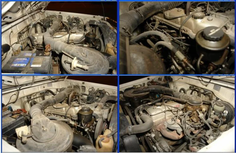

hi again,
please see the attached engine pictures of my Land Cruiser 1991 70 Series, please let me know what do you think about the engine?
thanks

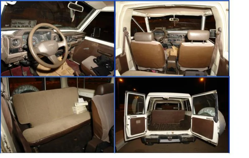

oooh, the Devils own vehicle, cool!! (666 in the serial number)

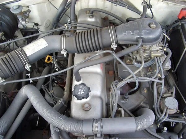

yep that engine bay looks a lot like this one: (in this truck Luxury Imports - Calgary, Alberta )
Crushers....having you notice the 666 (as the devils vehicle ) only enhances your reputation ( for good or bad):).....1978HJ45

Actually, there are a few 5 valves per cylinder motors out there but definitely none you'd ever find in a Land Cruiser. Bugatti, Ferrari and Audi have made them.
Dennis
Hello,
Nice FJ73 you got. Lucky you, I have not been able to find one in decent shape so far.
There is a 24 VALVE badge on the rear door. The engine, however, looks like a 3F.
I think the previous owner got the badge from a 1FZ-powered Land Cruiser and fitted it to this one.

Thanks for the feedback, I’m happy to see it.
Yes, it is in decent shape and i will work on it with ARB accessories and you will see the outcome in few months :)
Actually it is "3F" engine, so i assume it is 12 valve? .. this weekend i will work on its fluids and some gear/ mechanical issues, i dont have time during the week days ...
Hello,
Yes, it is a 4.0 L 3F engine. Properly tuned, it runs well and is quite unstoppable. And it is 12 valve, carbureted.
There should be a label with carburetor tuning data on the head.
Enjoy your build.
