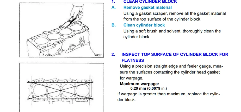

hi im slowly rebuilding my lj78 with a 2l te that cracked a head so i got some quotes from a couple machine shop in Christchurch new Zealand with the cheapest quote being in 4 hundreds that is to resurface head block, hone cylinders and wash everything i know it might be the best price i can get but wondering if its even necessary as the spec for block and head warp is .2 mm people say that the spec is unacceptable but idk as im new to the world of diesels. i would also need to get the pistons skimmed as its at max protrusion and thickest grade of headgasket which is also included in the price.

i tried to measure warp using a steel ruler and even went to smaller .05mm feeler gauge and seems to be straight but can i trust a steel ruler lol?

By dressing the block I mean a light skim to make it flat, but if it still has the milling marks from the previous work that probably isn't necessary. Make sure you use an experienced machine works that can verify the surface roughness is good enough for a multi layered steel gasket. If you can't find any warpage I would definitely not take anything more off the block. If there is still cross-hatching on the cylinder bores and the pistons are still fitted, I wouldn't touch that. If the head is flat I would not do anything to it beyond very careful inspection for cracks and checking that the valve margins and seats look good and seal a vacuum.

sorry bit busy with school i will upload photos at some point but I'm still confused by multiple machine shops telling me that by their experience that the 2l,3l is "tough" on the head bolts and need surfacing every time they are apart, they also say the Toyota manual spec of .2mm warpage limit is unacceptable and should be .05mm idk if they are just trying to get more money out of me or if that is actually the case.
Personally I would always resurface the head if you are taking it off. As well as check the block for straightness.
New headbolts aren’t “that” much to do it right.
