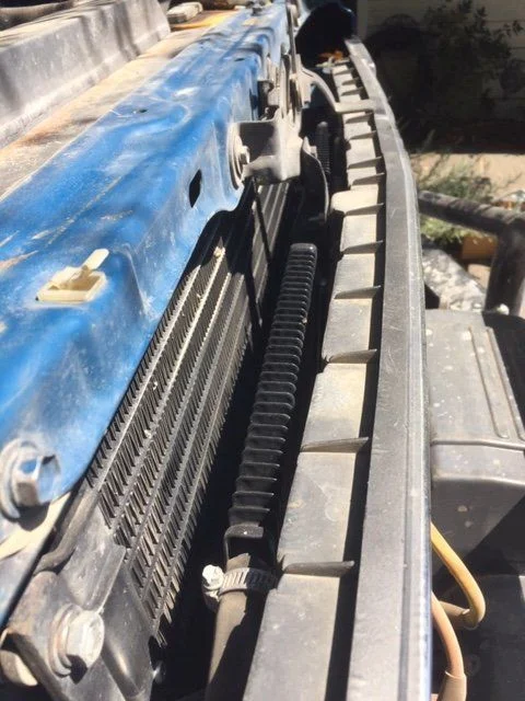

So, I should have given more details. We have two large transmissions coolers in front of the radiator. We were overheating the transmission in everyday driving, but these new coolers fixed all that. And the radiator is a brand new aluminum Rod Davis. And it has a fan shroud.
I say ditch the supercharger. I don't know that you can stay with a stock size radiator, even a hi-perf one, and keep a setup like that cool reliably. You need to figure out how to mount a larger(ie wider/taller) radiator and get good airflow through it.

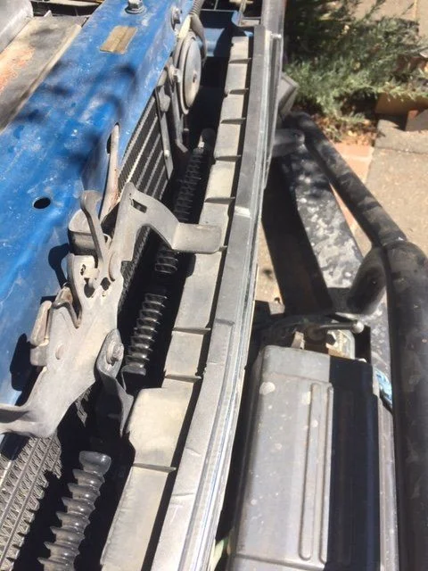

Here are shots of the fan, shroud and transcooler.

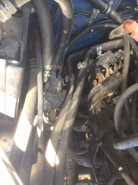

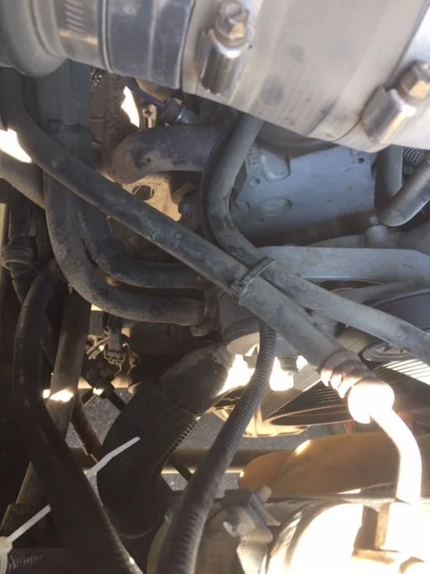

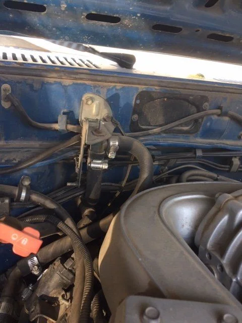

Won’t address the trans, but how are your heater supply and return lines routed from the water pump? Could you post a pic of them? They have to be tied together so that coolant can return to the pump even if the heater valve is closed.

Heater hose pics

I’m not seeing a way for the coolant to return to the water pump when the heater valve is closed. This creates a dead end. Chevy systems are set up to constantly flow through those heater lines, different than the Toyota design. Just to test it out, bypass your heater core and tie your supply and return together to loop that coolant back in the water pump and see if your cooling capacity improves.

Yeah, those heater lines are an issue. Put an “H” in them as a first step and see what that does. Excess heat in your engine bay also means excess heat on the transmission coolers.. you might see a slight drop there too.

As above you need to sort the heater hose.
