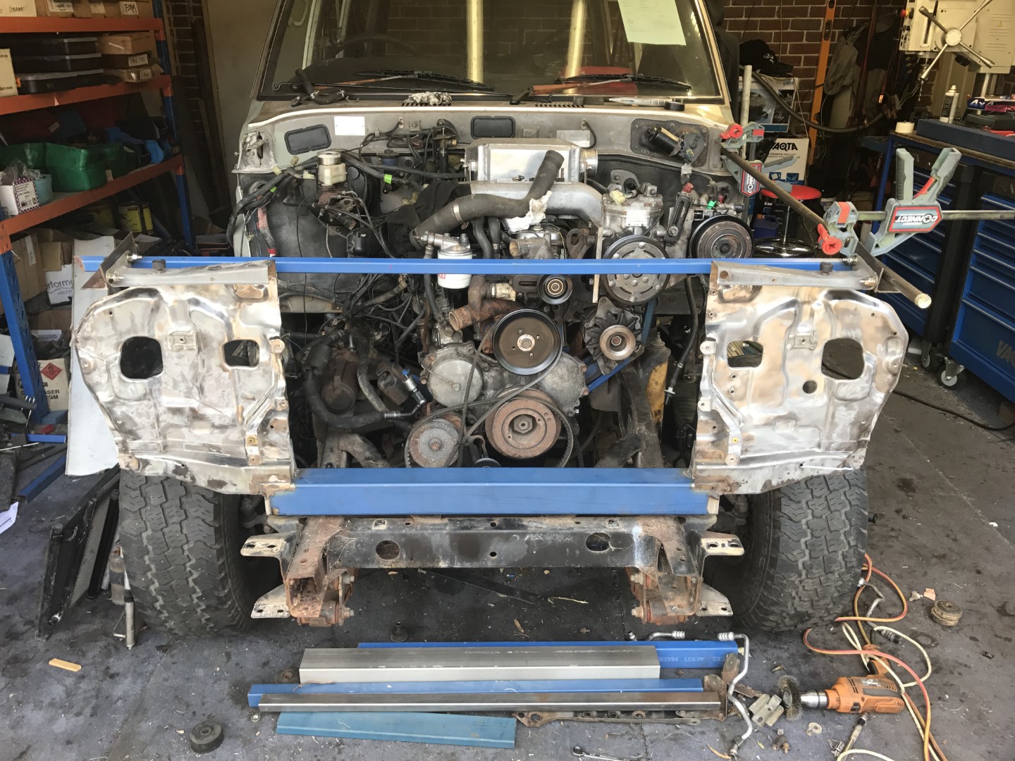

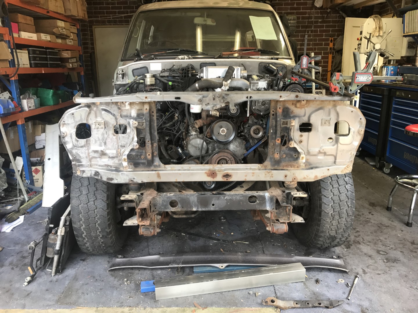

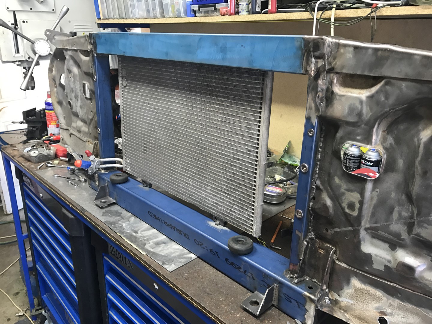

So having said all of that, here was my design....
Standard front panel
Modified
As you can see i have considerably increased the size of the opening allowing a "rectangle" type radiator to be installed. This means i can run electric dual thermofans for a much more even spread of air flow over the core and being electric the shroud gap to blades is considerably less than with a mechanical fan.

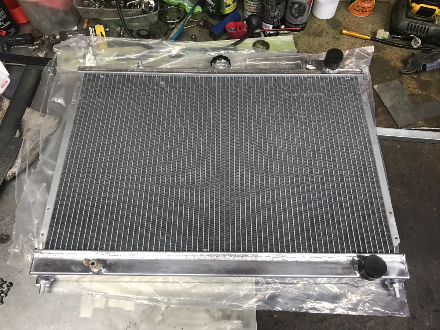

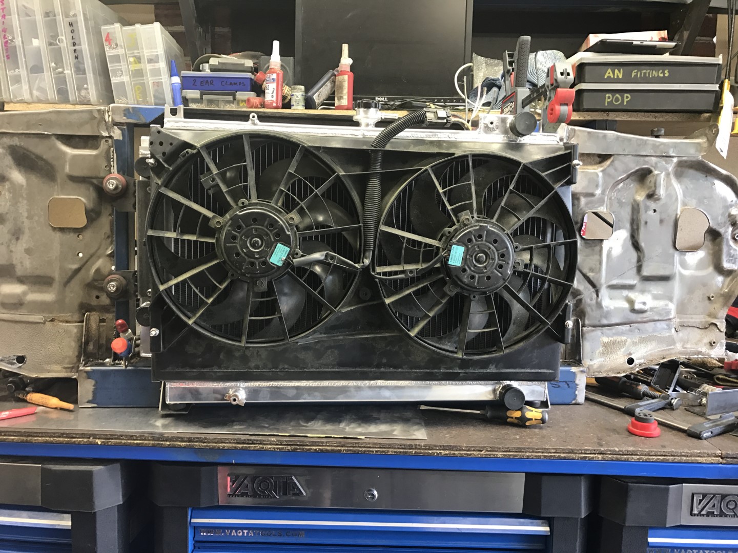

So this is the radiator i choose...

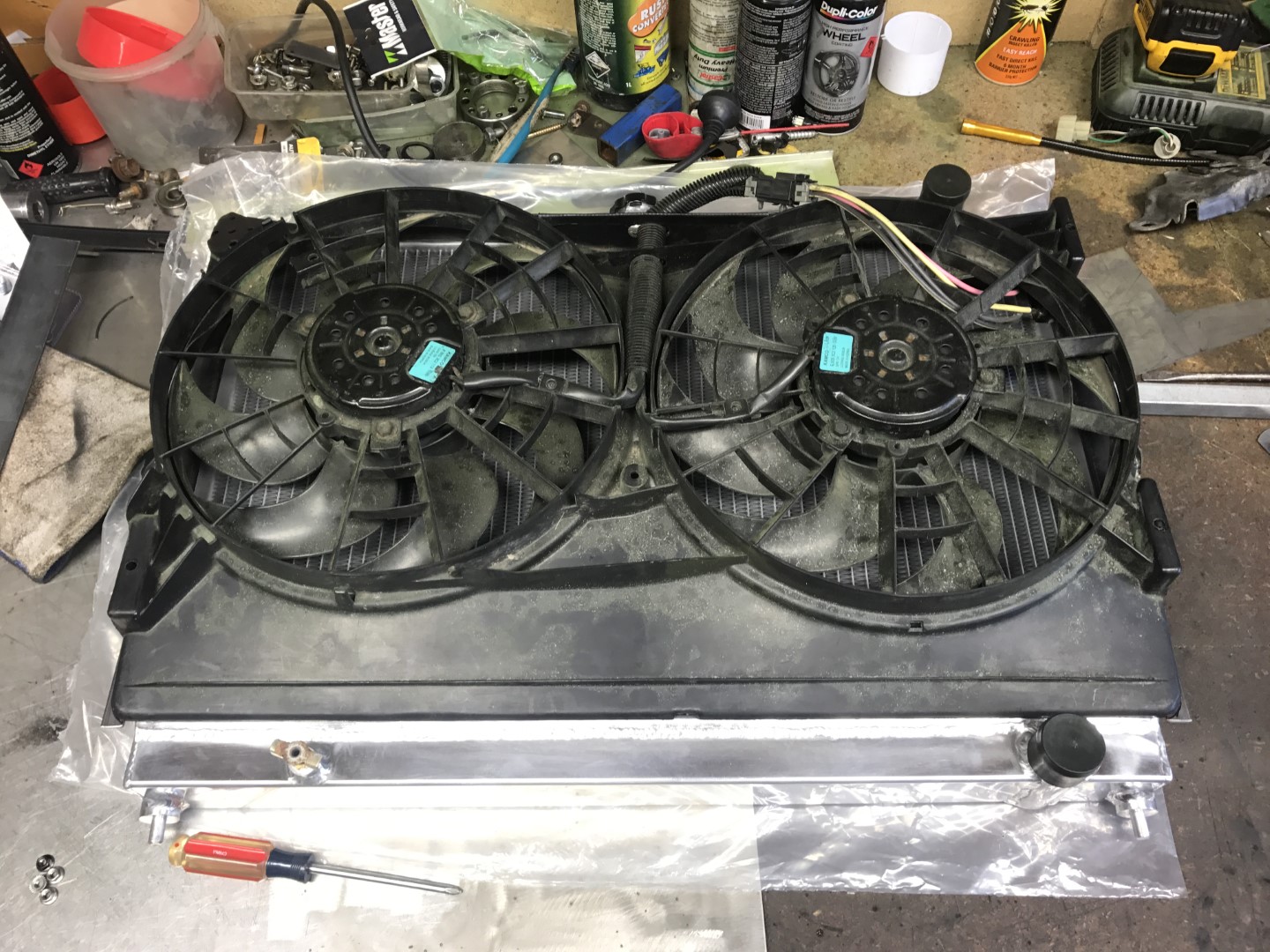

And as you can see the twin thermofan fits almost perfectly.

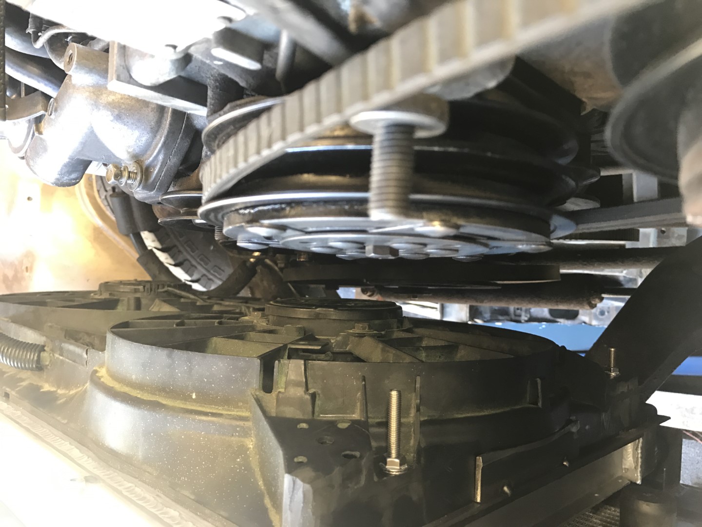

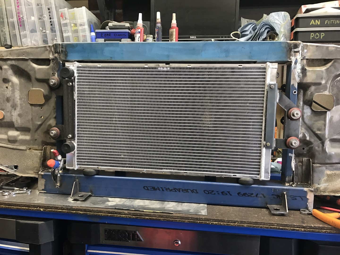

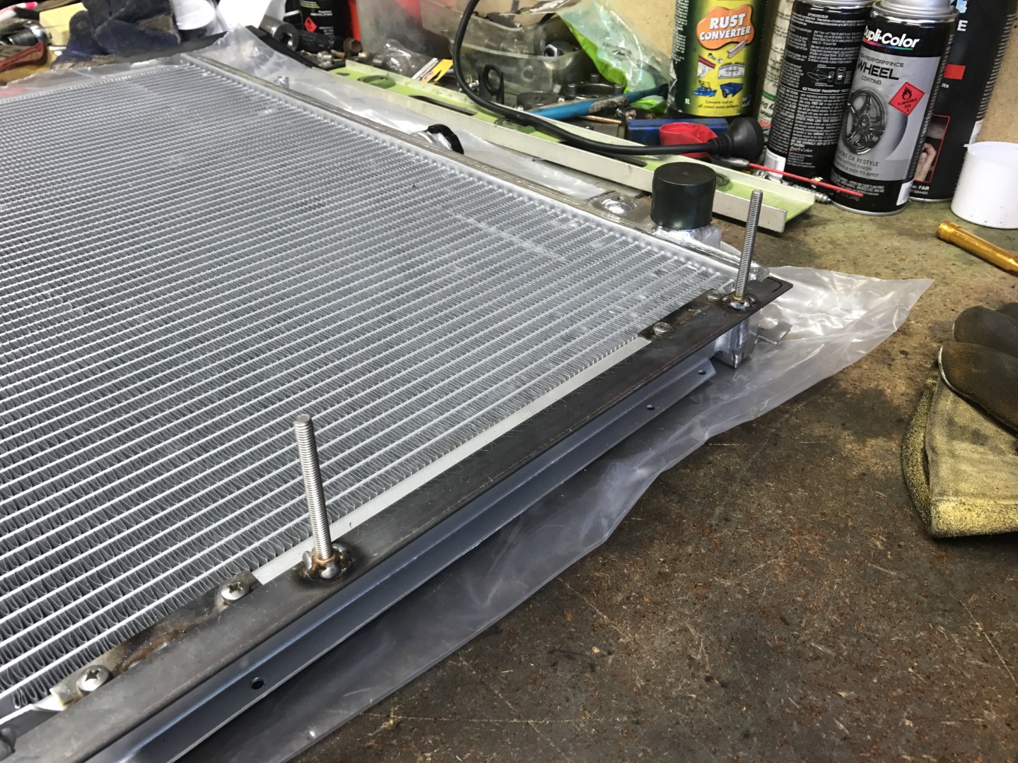

Here is the bracket i made to bolt to the radiator which supports the thermofans. It is critical to get this "level" with the radiator to ensure minimal gaps.
Just to show the reasoning for the design this is the new heat exchanger for the airconditining at the front
The middle radiator is actually being used as the heat exchanger for the water to air intercooler (Its a 12HT turbo diesel)
And now the GTR radiator is mounted on the outside
Now it is close to the engine but does fit. A V8 should be considerably shorter than the I6. The main reason for using the GTR radiator is it has the inlet/outport on the same side which suits the 12HT
All those gaps around the edge will be sealed up (using various techniques of rubber strips and metal brackets). This should ensure all the air being drawn by the thermofans is through the radiator cores and not leaking in from the edges.
Now the reason i choose those thermofans is they are a VERY common choice here in Australia for burnout cars. So if they can cool a 750+ HP V8 on a skid pan for minutes at a time (Eg the engine constantly producing 500HP while stationary) then they shouldn't have any problems cooling an engine producing 50-150hp on the trail (I know its a much more powerful engine but you shouldn't be producing 500HP while actually 4wding, however even if you did it should support it).
So as I've said previously electric thermofans are BETTER PROVIDING they are designed and installed correctly. A simple SPAL bolted on WON'T WORK. A shroud bolted on with big gaps around the side WON'T WORK. You need an even spread to ensure airflow over the WHOLE core.
