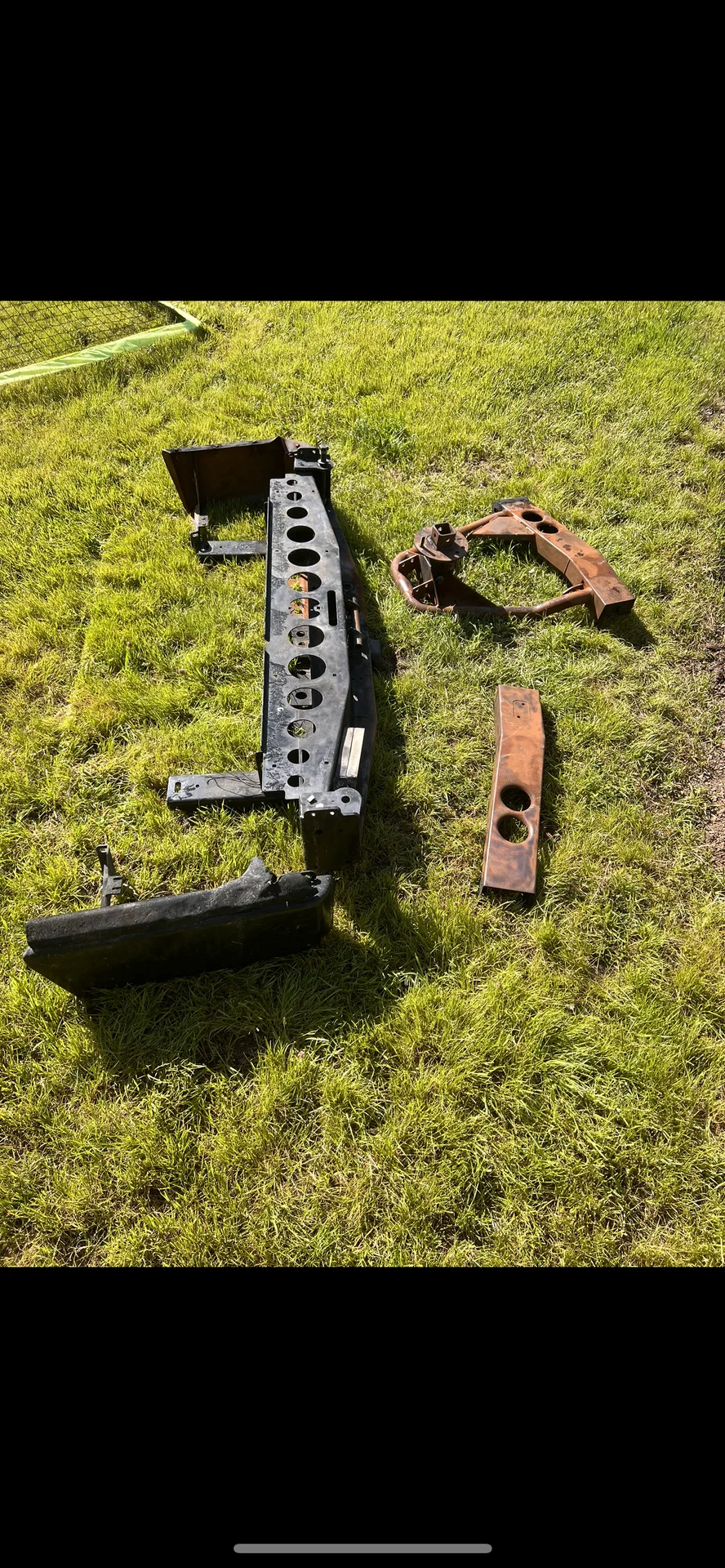

Hey y’all, seems like this is the place to ask. I acquired a rear bumper that’s missing the top plate/step plate. Ordering the replacement part from ARB would cost a small fortune, so I want to fab one myself if I can. I’d like it to look similar to the one it came with originally, but I don’t know where to source the material, or what it’s called. Seems to be what door thresholds or stair treads are made of — it’s a sheet metal with ridges for tread. Any idea where to looK for this, or any other advice? All ideas are welcome.

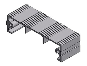

That is machined from a custom made aluminum extrusion. You can have your own extrusion dies made for around $20k and get a mill run of material for another $5000 or so.

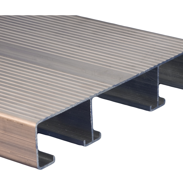

My first impression was that it was cut from an aluminum bleacher seat/tread plank:
If you really want to match the pattern, you may have to look a bit. It comes in a variety of "patterns" from different manufacturers: Dock/Decking/Bleacher - https://eagle-aluminum.com/dock-decking-bleacher/
That would be a bit difficult to cut the ribs off the underside, though. Off the top of my head, I can't think of a flat piece with that "tread" on it.
