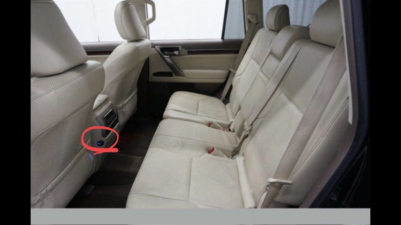

For the rear; I went through the same exercise on my GX, and will do the same for the LX. I drilled out and mounted two double USB outlets below the rear AC controls. For the front I replaced the two cigarette plugs with double USB outlets and then also put one in the back of the glove box.

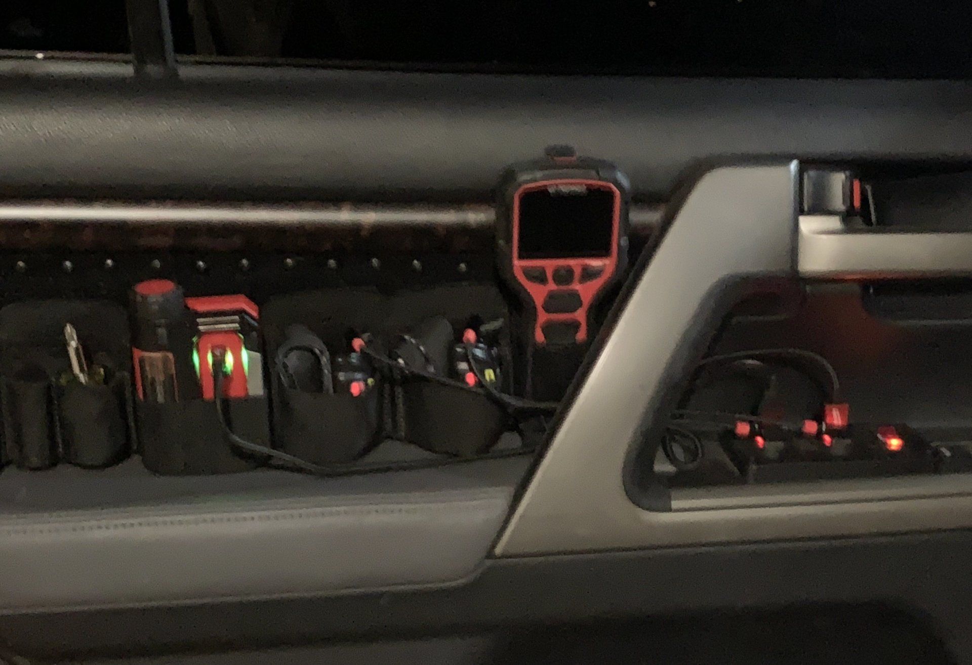

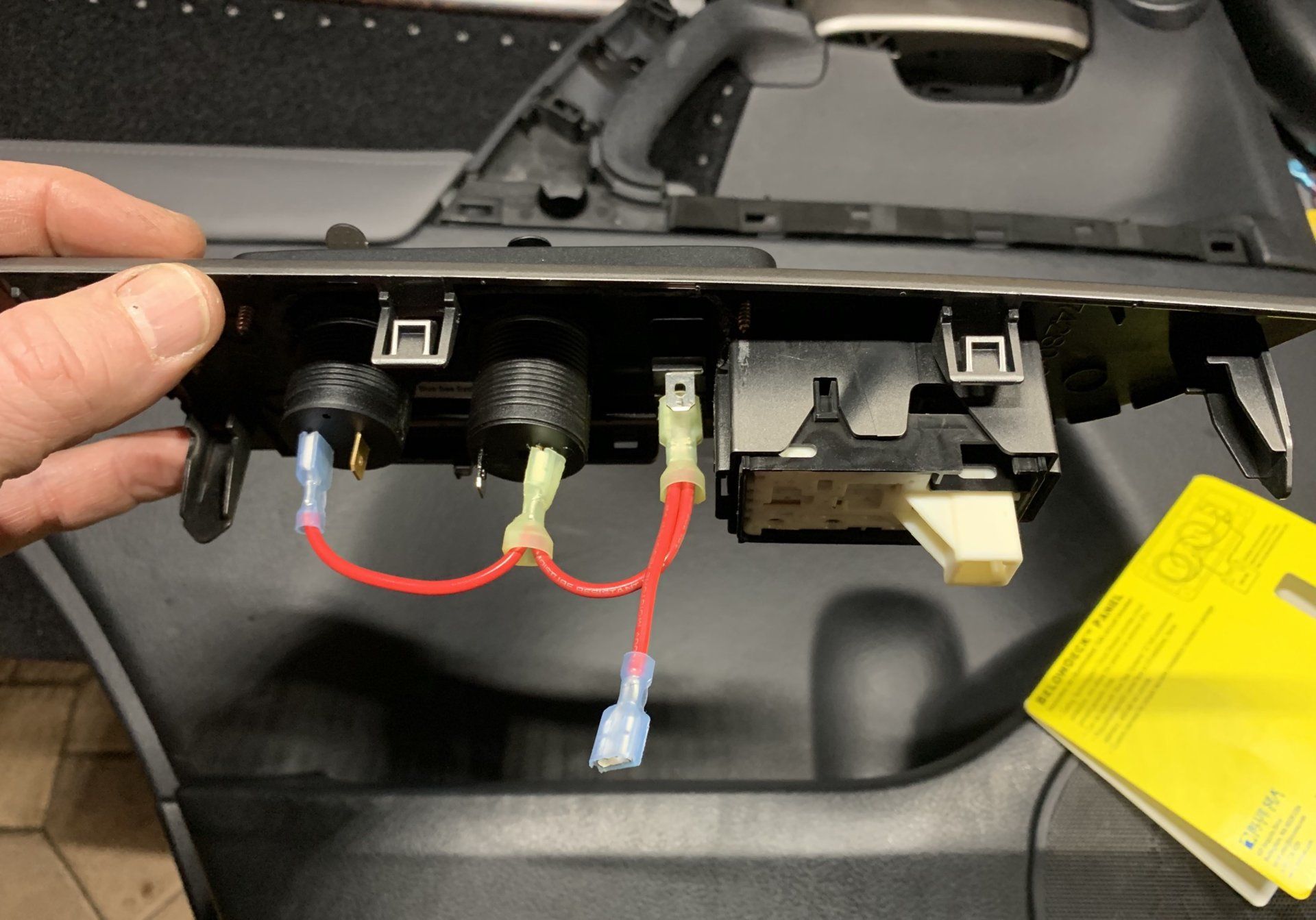

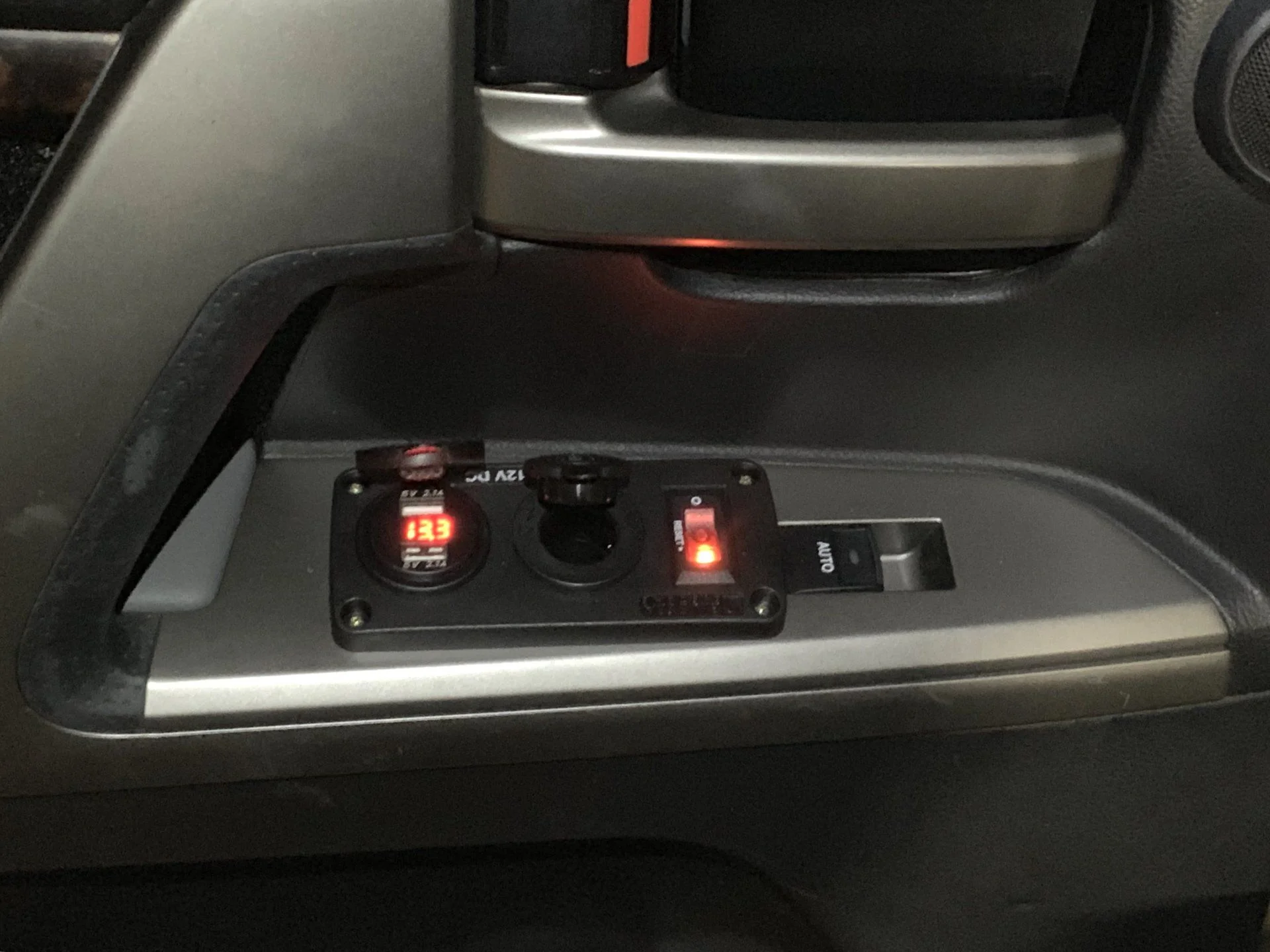

I thought the same thing some time back...and came up with this solution I am very happy with.
I cut out the ash tray frame and made hole large enough for this...
(wired through door wire tube and down through door jam/pillar)
1913360

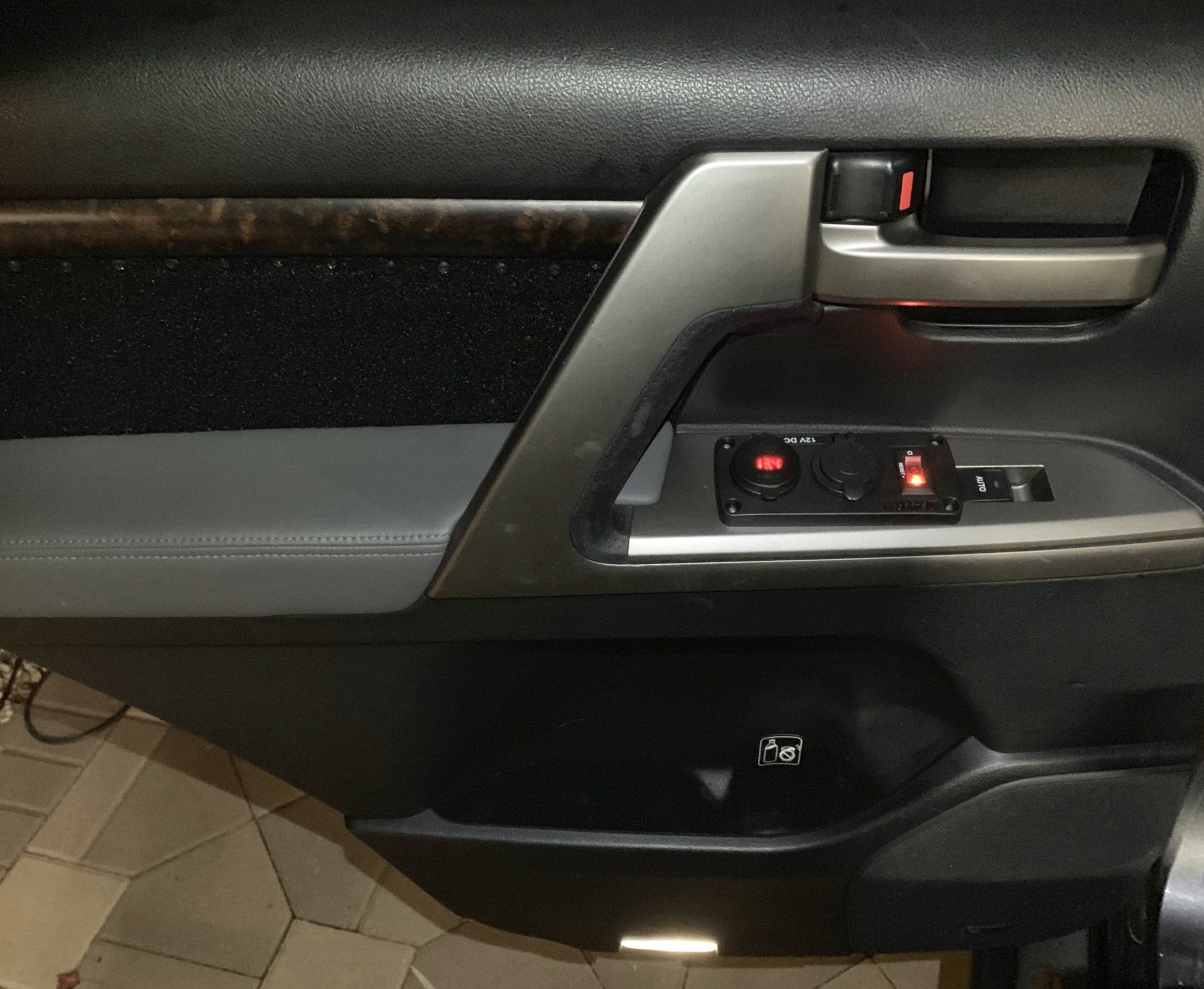

Which ended up like this:
1913362

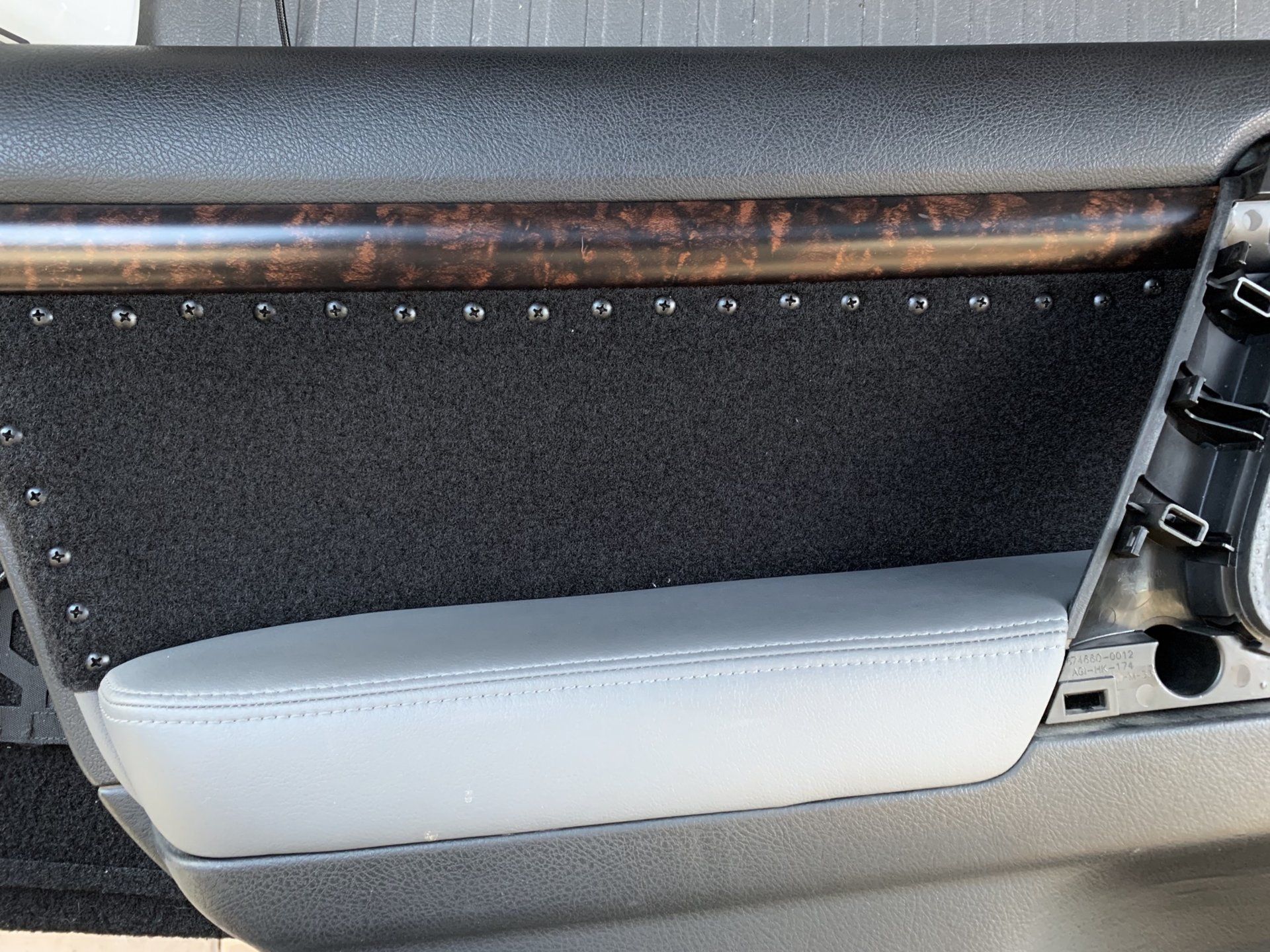

Then attached Velcro here:
1913363
1913364
(Switch from 12V socket on the right for another double USB (so 2.4A x4 +on/off master switch)
Then created a a nifty little charge station for various USB-charged items on the Velcro like this:
1913361
Works a charm.
Since it’s powered whether running or not...the on/off lets me easily turn it off if parked longer term.
This is easily one of my favorite little concoctions because it took a tidy, but-otherwise-wasted “shelf” and turned it into a great little easy-access charge station.

Well… -Takes all of maybe 5 minutes to pop this plate off and swap in a USB-C, or whatever other kind of plugs you may want in the future. 🤷🏻‍♂️
1913811
And ya. .5A, 1A, 21.A, 2.4A etc. per USB port are out there...36W quick charge, USB-C...and a zillion others. These are 2.4A per port and lower draw items draw only what they require.
Only part I’m not a fan of is that nearly all of them include voltage meters, which are not good judges of exact voltage anyway. Good news is they seem to consume a TINY bit of power only, and also serve as indicators they are powered/functional, so meh...
As for the old standard 12V socket (cigarette lighter style) receptacles—They have arguably the poorest electrical contacts of all, and are notorious for losing contact off-road.
No thanks.
