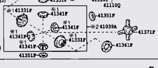

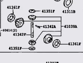

98-02 use a weaker diff (2 pin) with a 4.3 ratio, 03+ went back to a 4.1 but was stronger (4 pin)

Negative, 1/98 and newer... all 4 pinion rear. Front is 2 pinion to 8/99, 4 pinion later.
1/98 to 8/99
8/99 & newer
Fwiw, e-lock 80's were all 4-pinion, non e-lock are 2-pinion front & rear

That is a great question. Toyota epc shows that the LSD and open rear diff were both available in 1999. Whether or not they were actually ordered and shipped that way to the US I don't know bu a VIN should determine that for you. I've personally not run across an LX470 rear LSD diff. Either way every rear 100/470 diff be it open, LSD or locked is 4 pinion.
