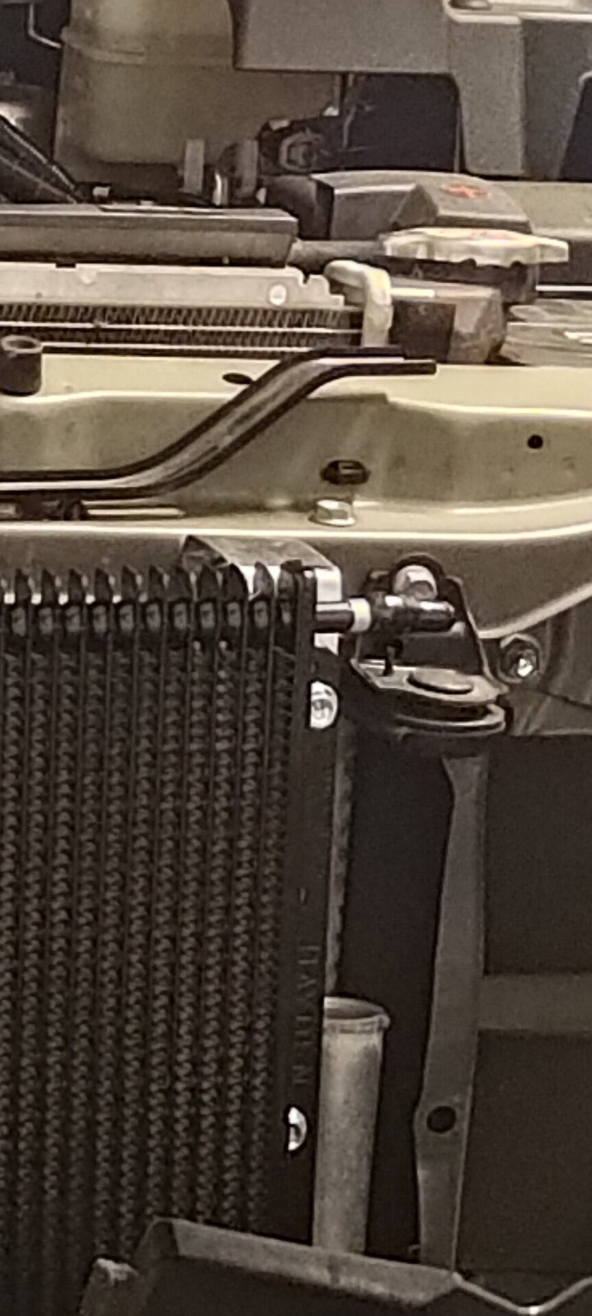

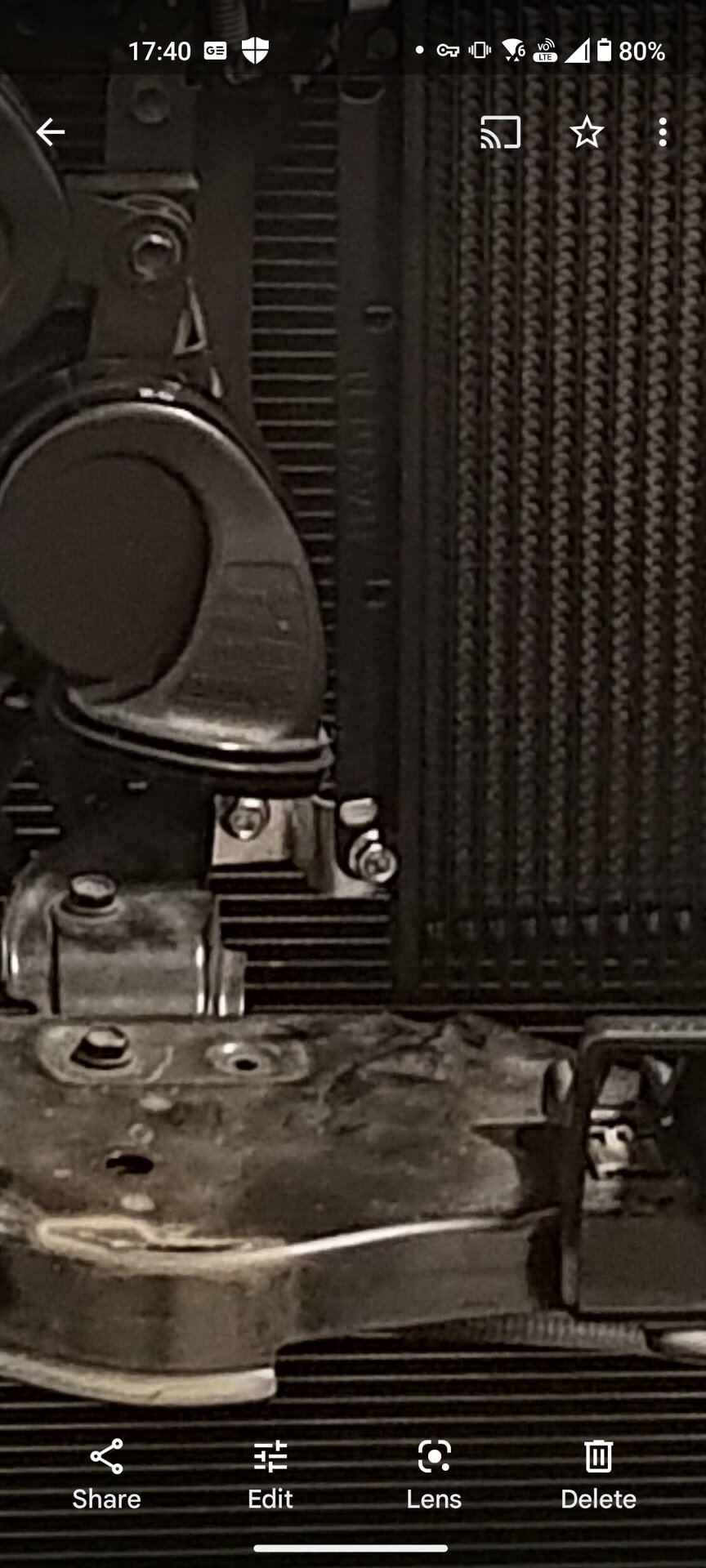

You shouldn't really need to run a fan on these off-roading. Lots of folks wheel in these at low speeds and the trans don't get hot under those conditions (presumably due to the Toyota design). The trans in these can get cooked by long grades where a low gear is retained, a lot of throttle is applied, and the TCC doesn't lock up, or when towing. Even with the TCC unlocked at low speeds (i.e., cruising in 3rd gear and below off-road), they don't really generate a lot of heat. Mine usually stays 160-170F off-roading in the summer with a Hayden 678.

Perks of having a vehicle with Land Cruiser roots! I just ordered a Hayden 678. I really appreciate the input.

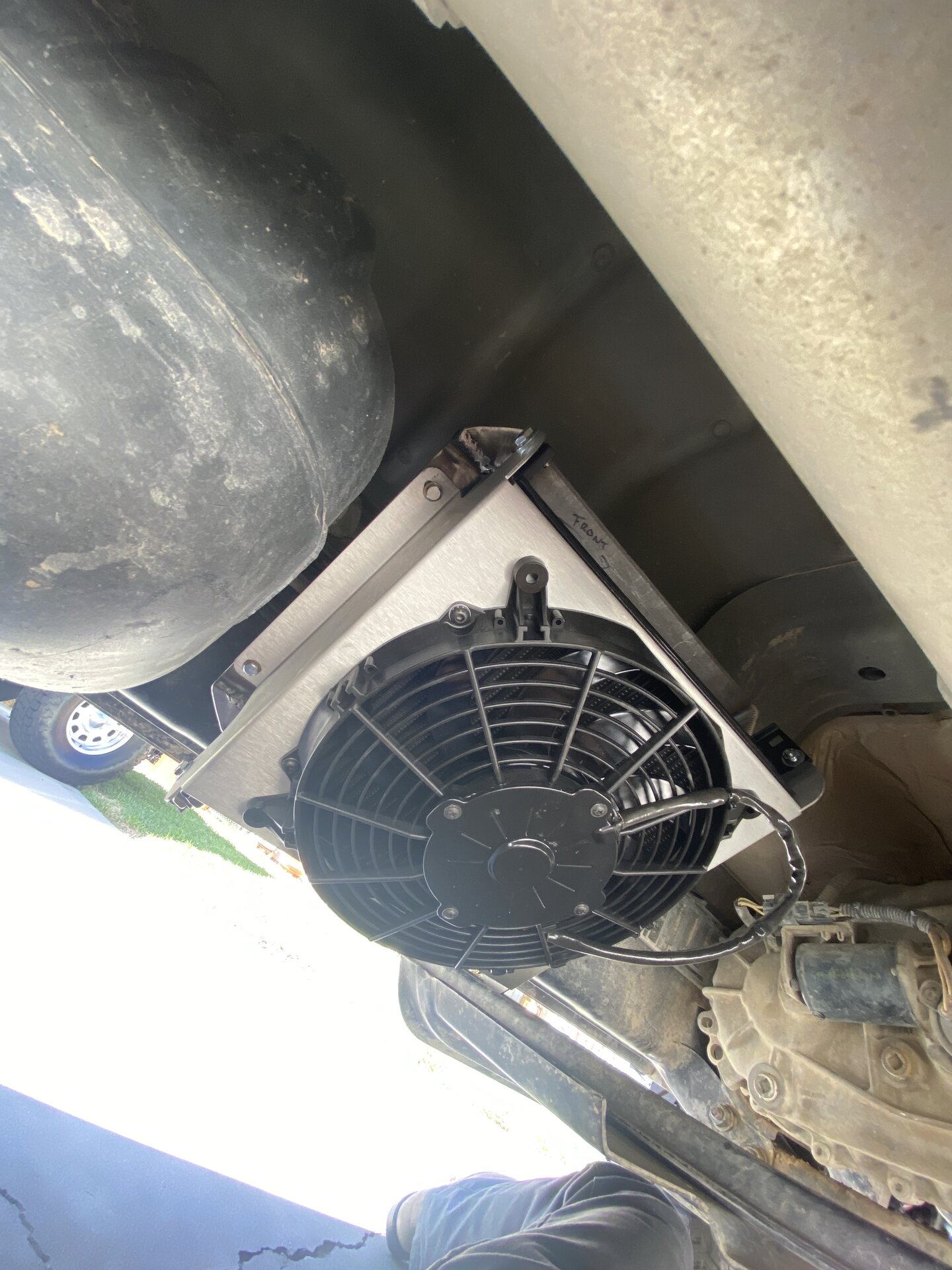

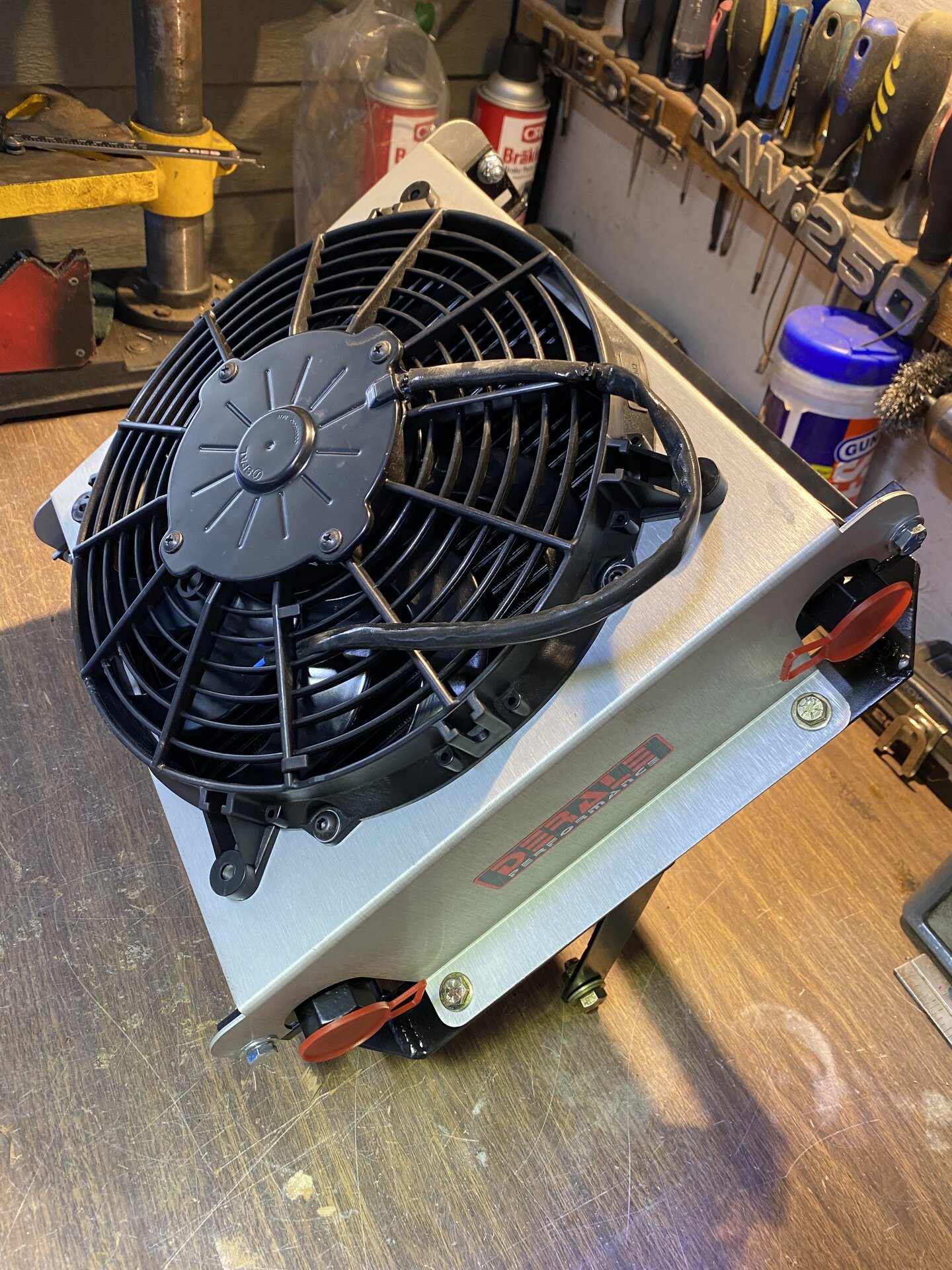

Here was the setup I fabbed and installed on my old Ram 2500. Derale uses Spal fans and from my experience these things CRANK and hold up to the elements really well. This under belly cooler set up worked amazingly.
