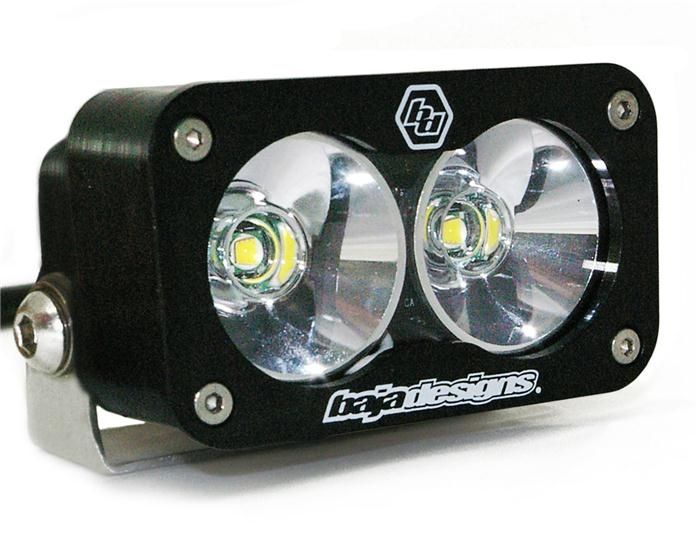

I am considering one of these on the bumper corner.

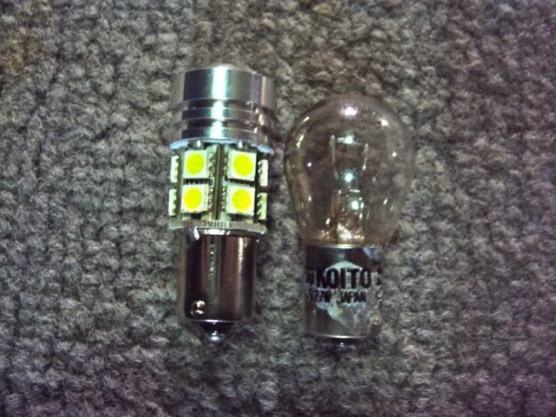

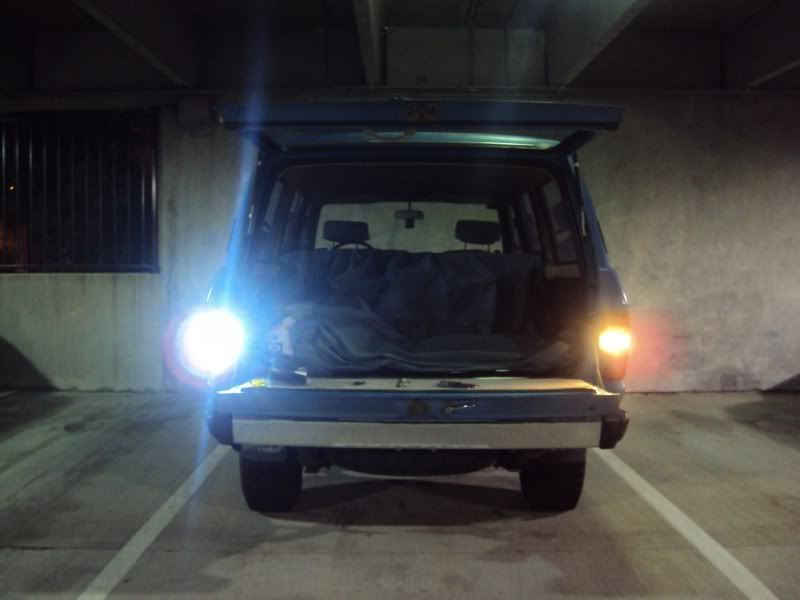

CREE 7W LED 1156 lights.
CREE on left in both photos.
I know it's not an external light, but another option for ya!
These made a big difference for me.

I went CREE and they are amazing. I wouldn't even consider an additional light at this point. I bought them from a mud vendor.

I got my CREE lights from "FullyLitLED" on this forum. Another LED vendor is pfran (don't know the exact username)

I got paul's (pfran42). he's in the vender section. he also has some really great LED dome lights. They are super easy to install and are bright as hell!!

I went the cree route from JLClighting. Awesome brightness and not real mods involved. I had a hella 6" all lined up to throw back there but now theres no need.
