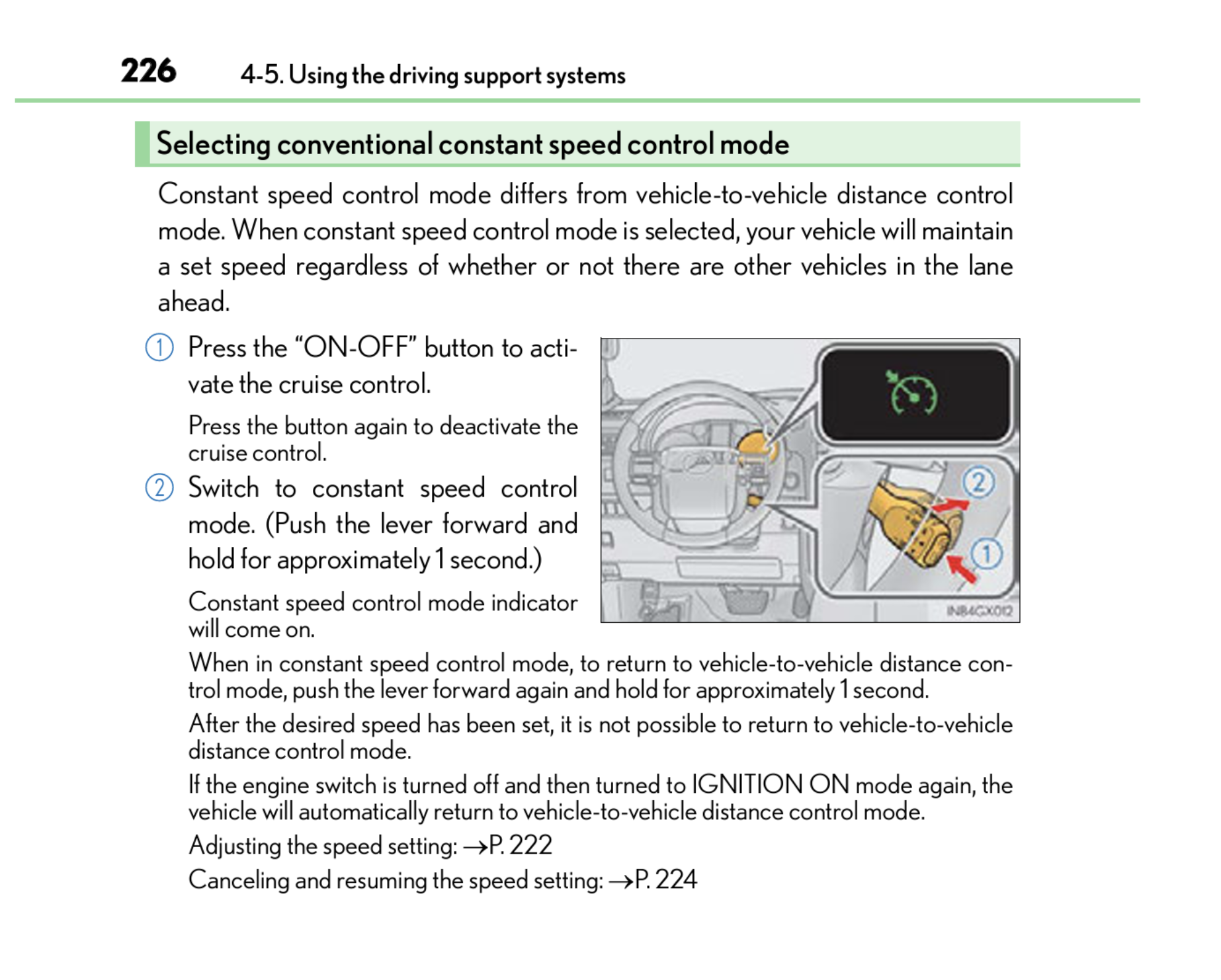

I believe what he is asking about is just turning off the adaptive function so that it acts as a regular CC. I can do it on my work car by holding the CC button for 3 seconds.
I am asking how to turn on regular cc from adaptive. Press and hold the I/O button and it switches but his doesn't it stays on adaptive. So dealer it is?

Looks like, as they say in baseball, "Youuuurrrrr OUT!"
  1. I was strike one
  2. Bang Bang, strike two
  3. Acrad, strike three...
As you said off to the dugout, er... dealer.
My old '07 G35x has adaptive cruise and it works like some other vehicles by holding the ON/OFF button to override but as you see this leverages pushing the cruise stalk away from you.

Pushing the lever forward is how it works in my '13 RX.
