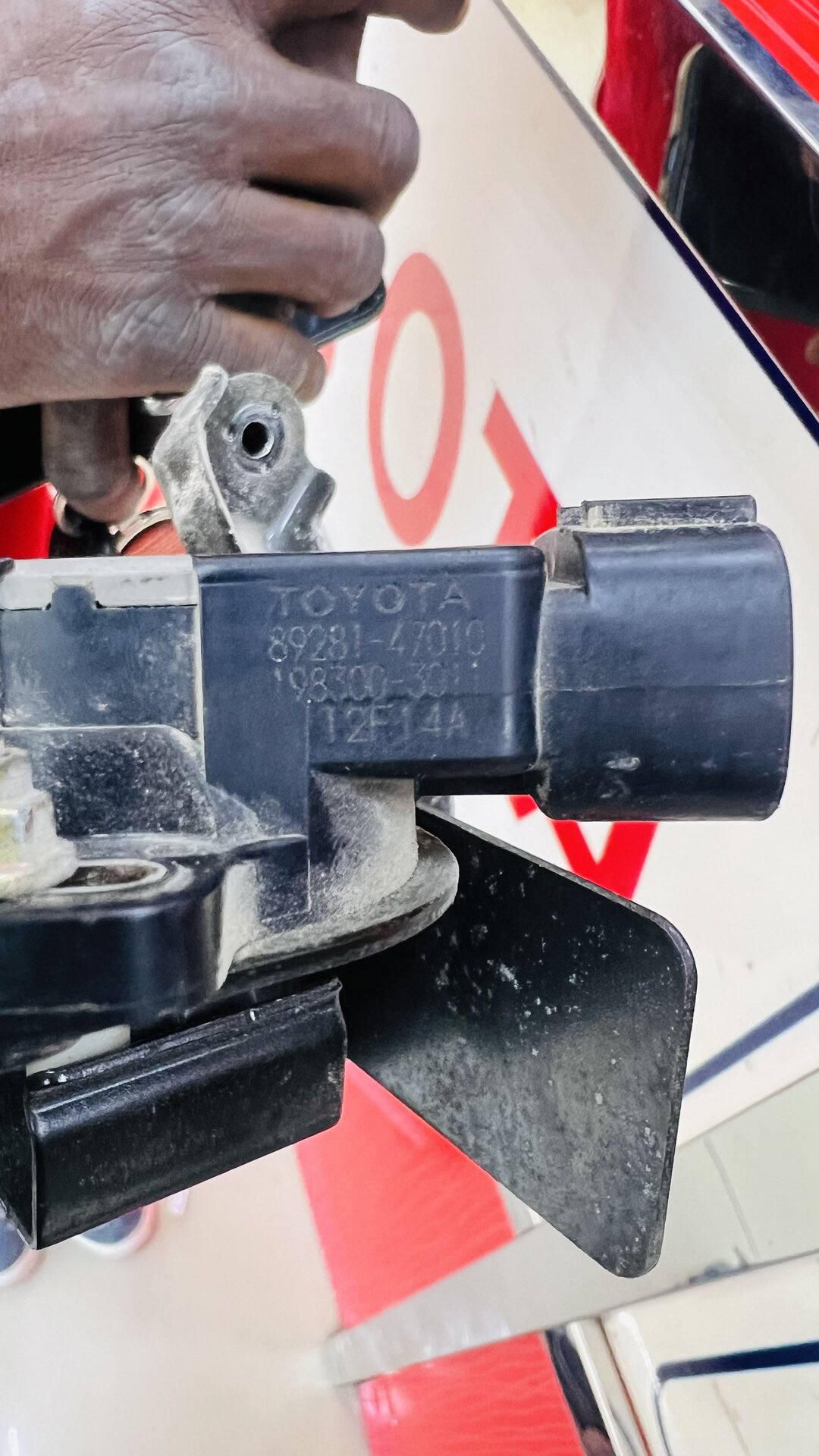

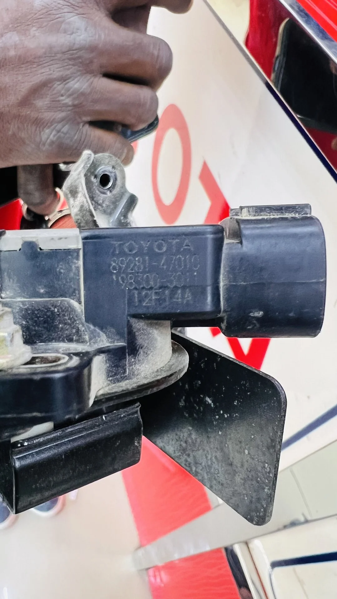

In my Lexus Lx470 2005 , I found that when I press the accelerate fully (full gas) it goes maximum only at 2000 RPM and it doesn’t accelerate beyond that. But when I put to neutral it’s goes beyond 2000 RPM.
I did the following :
Changed the accelerator pedal. (See attached )
Looking for advice and fix.
