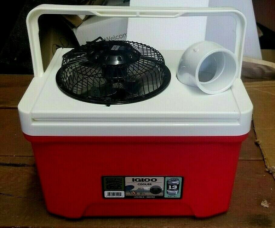

For under $75- You can make your own swamp cooler: with an insulted cooler, a PVC elbow, some ice and a small 12v fan or USB fan.
Here's a ready made one:

Cool cheap solution. However it's very humid at night 100% RH is common, so it wouldn't work.
Oof - thats pretty high-
It's mostly because I am camping by the shoreline(after/before fishing) and in the summer it's already very humid and the humidity of the sea adds to it. It's very sticky and unbearable at night. An AC has a dehumidifying effect that I am also looking for combined with cooling.
