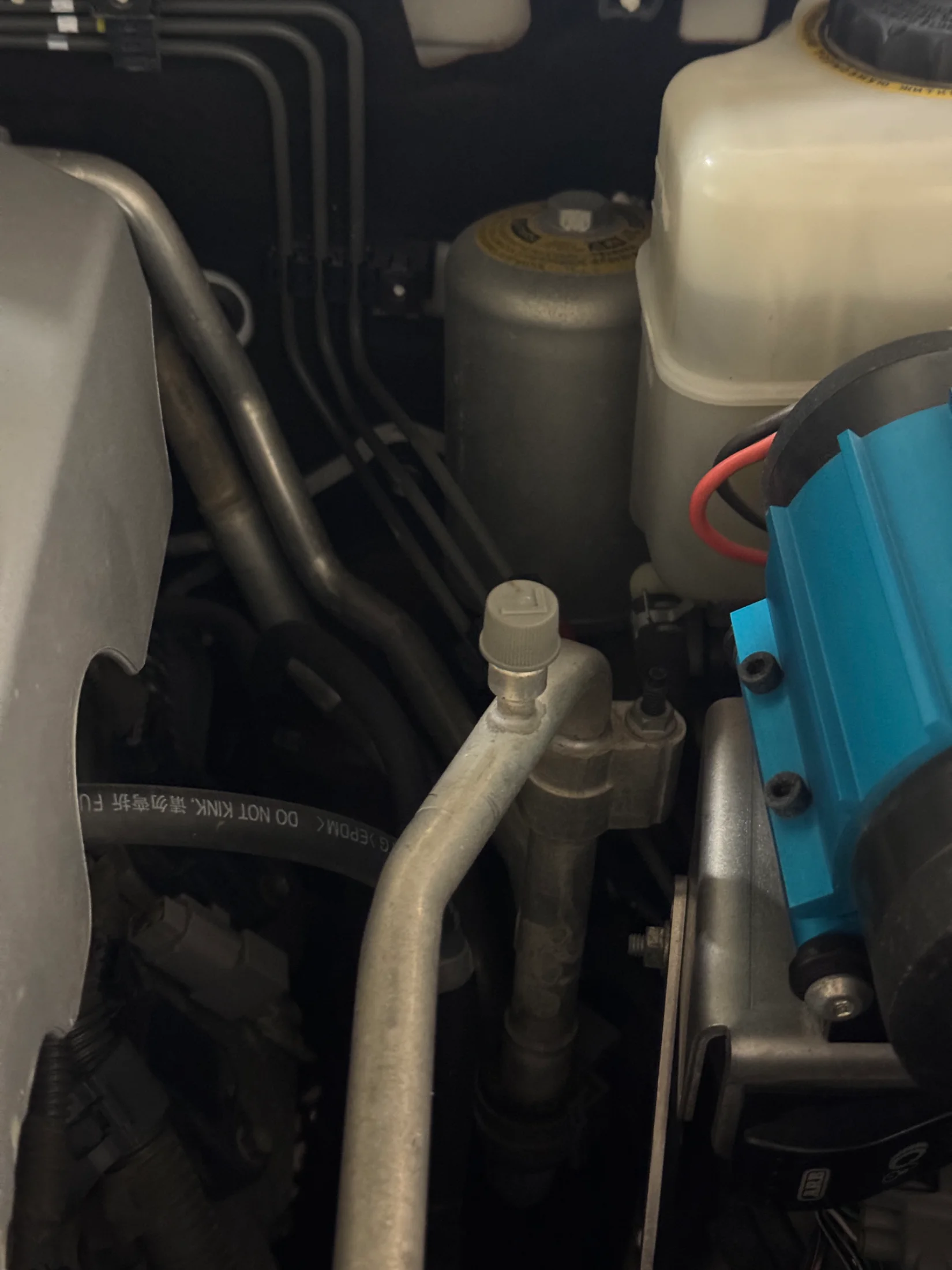

Thank you. Anyone know where the refill point is?
yeah check youtube. Likely the same location on all the 5.7s, so a tundra video (more common) should suffice. If I remember correctly, they are silver/alumninum looking lines, and there is a blue plastic cap on the line. remove that and install there. The pressurized recharge units have pretty good instructions on them as well.

not sure on yours, but on mine the low pressure line with the L refill port is aluminum and about 5 inches from the brake reservoir. I’ve successfully used the refill kits on my sons honda

That said, in the interest of tech, your low-side check/fill port is located near the brake booster.
