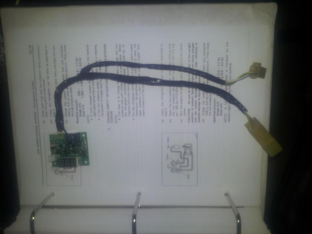

I saw a post on here once with a small device you could order off of amazon and it had a probe on it and you could splice it in and set upper and lower limits and it would cut power to the compressor off and on. I sent that guy a message in hopes of getting more details, but he never answered, Needless to say that life and other FJ60 projects got bumped higher on the to do list.
yeah, if you look at the thread it ends with me asking a few questions....I DMd the guy and didnt get an answer. I just need more info about how to hook it up. Wish there was a write up on it.
The picture of how he did it is there, though it's not very good. Looks like he wired the stock harness where the amplifier goes ...
Description is vague, too. But He's still on mud ... Maybe he can elaborate...

I would be happy to check out the AC amp. The FJ62 version is fairly straight forward. I even have some of those T2333 ICs. I don't know what the transistor is but I'm guessing a 2SC945, I have some of those as well. If you are handy at all, and you suspect the amplifier is not working, reflow the solder on the connector pins and see if that fixes it.
