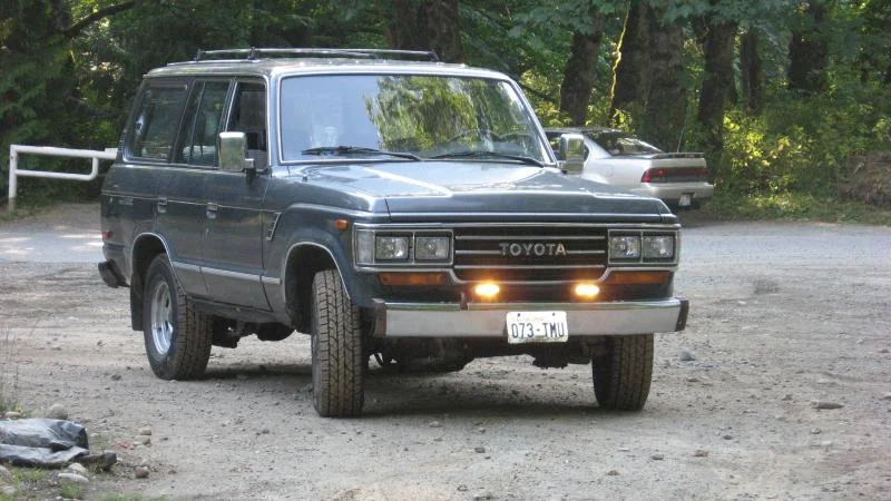

Hey guys I bought my fj62 about 2 years ago and it had a worn out tranny in it when i bought it and Ive been driving ever sence. my question to the experts is would it possible to put a turbo 350 or 400 behind my 3FE? The truck is and 89. Shes my baby and I only want the best for her!!! Let me know what you guys think! Thanks in advance!!!
