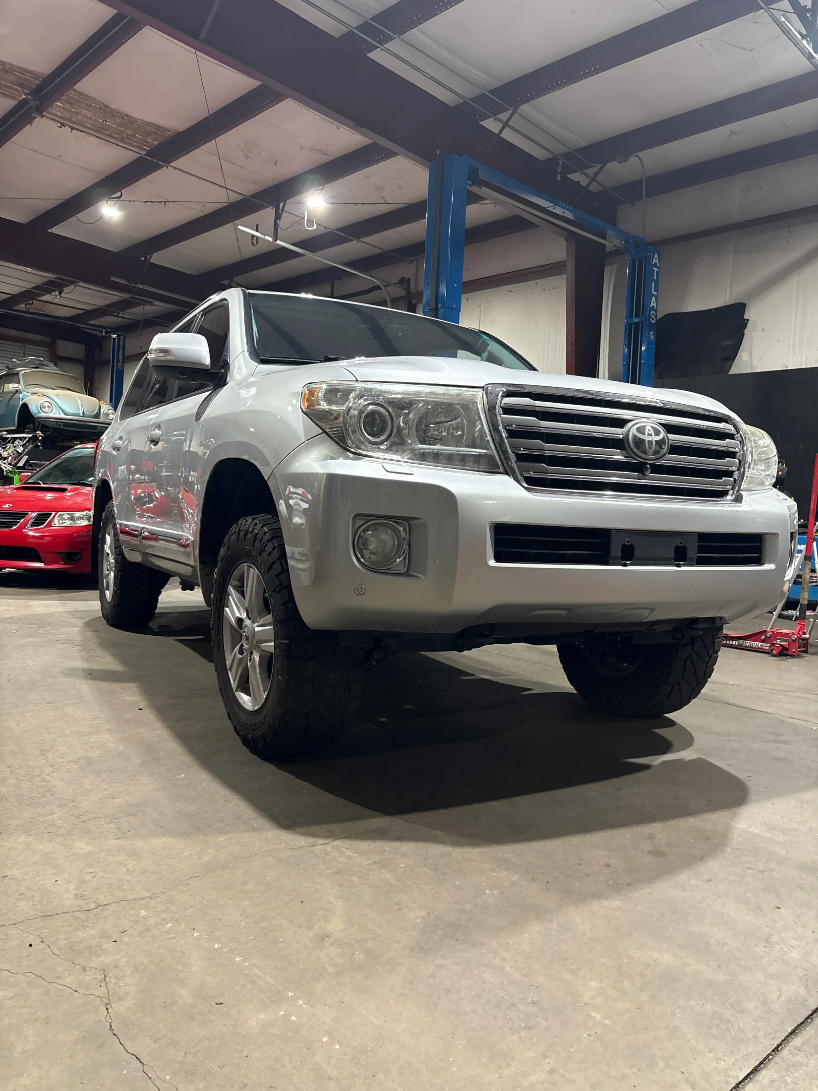

Here’s some quality “before pictures”
Random pics of parts and I did go ahead and get $300 worth of Paintless Dent Repair because 250K miles is enough time for LOTS of dings…

Here’s a few of the finished front…
And a test fit of the new wheel/tire sans hubcap for now 😍

#carolinasquat at least until I either get some 2” rear springs or a 30mm spacer that fits.
Also this is on the 5th perch up front and will likely need to come down, just gotta make sure the wheel/tire combo fits…

For reference mine sits at 2 inches up front and I believe my rear was 3 inches but with the weight of my drawers is now down to 2 inches. I didn’t use any spacers albeit I kinda wanted to. I had front shocks spacers on my oem shocks but couldn’t get to fit with my new coil overs.
Remind me exactly your setup? I have 5160/6112, and not a lot of weight in the back besides the 3rd row… so trying to figure out if I wanna do 2” springs out back or just spacer. Unfortunately the rear shocks, although mailed on Monday, are coming via USPS and they suck, so won’t be here til Monday…
