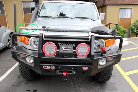

Have you ever used the detachable cleat at the top of the bar? I have that attachment too, but I've never used it and it just rides in the bottom of my recovery bag.
I know what it's for, but I just don't see it being an important ingredient in my kit, much less worthy of hanging on the truck.
That is a great idea, I do not see clamping anything with it, so I should take it off.
Never really paid any attention to it, but it might just add .000000000001 to the MPG factor :D

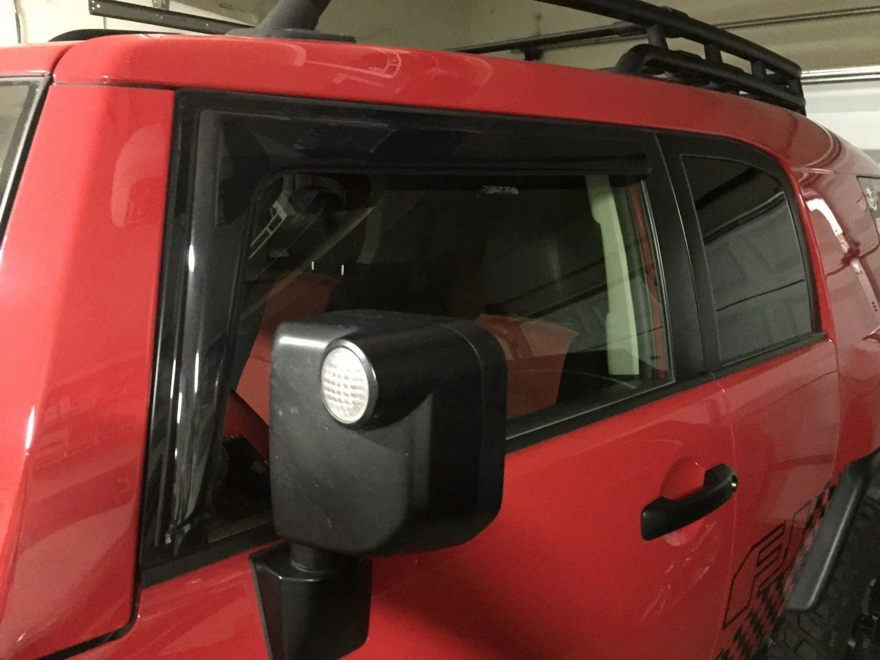

I bought AVS vent visor deflectors in 2014 for front pass and driver door work great. The best deal was the hood visor, it really does blow skeeters up over the roof at dusk!
