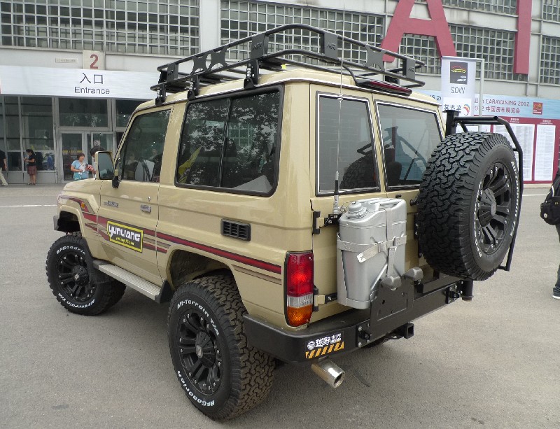

Perhaps make a mount that mimics to OE gas can carrier.

I would not cantilever that much weight that far back off the door if it will be used loaded on rough roads / offroad. Maybe time to think about a rear bumper with swing away tyre & gas can carriers, $$$$ if you don't build it yourself but your door hinges will thank you.
