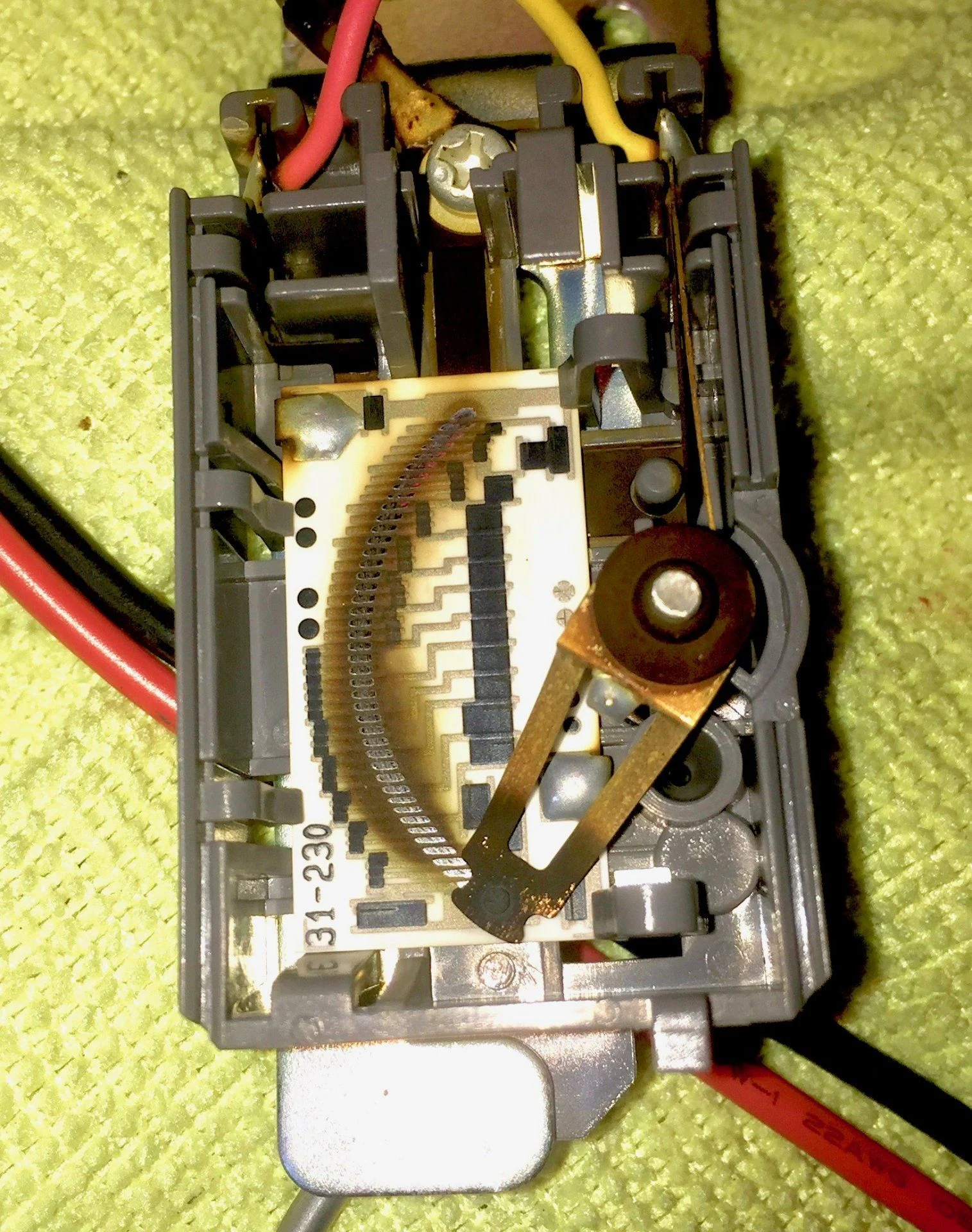

Sounds fuel pump related to me. 200k is common interval for FP- especially in warm climates and if its been run low on gas regularly- that will shorten pump motor life. If you're not the original owner- then assume it was run low frequently.
As fuel gets low in the tank the pump runs hotter as there's less fuel (hotter fuel) to cool the pump motor. As the pump heats up or overheats-repeatedly, inside the sealed motor gets bits of burnt carbon from the brushes built up on the commutator bars- this creates higher electrical resistance and reduces the motors torque. So when its cool, its fine but after it heats up, resistance increases and the pump stops working or slows to the point it can keep up with engine demand.
Changing the FP is pretty easy job; just under the second row seat. The Denso pump is the one you want. While you're in there, if you have budget consider replacing the fuel level sender at the same time- these get a corrosion build up on the potentiometer and start to give false readings commonly after 200k-250k.
Pic of a failed level sender @ 190k:

I think there are different pumps for different years dont recall the cut off years. Yeah the sender I bought was 83320-60340; fyi it was half that price when I bought from PS last May. (around $75). The logic your mechanic provided about the FP is sound; (but Id bet its still the FP). Mine hadn't failed when I replaced it, the level sender did so I preventively changed out the FP @195k (. FWIW I noticed an immediate improvement in engine response).
