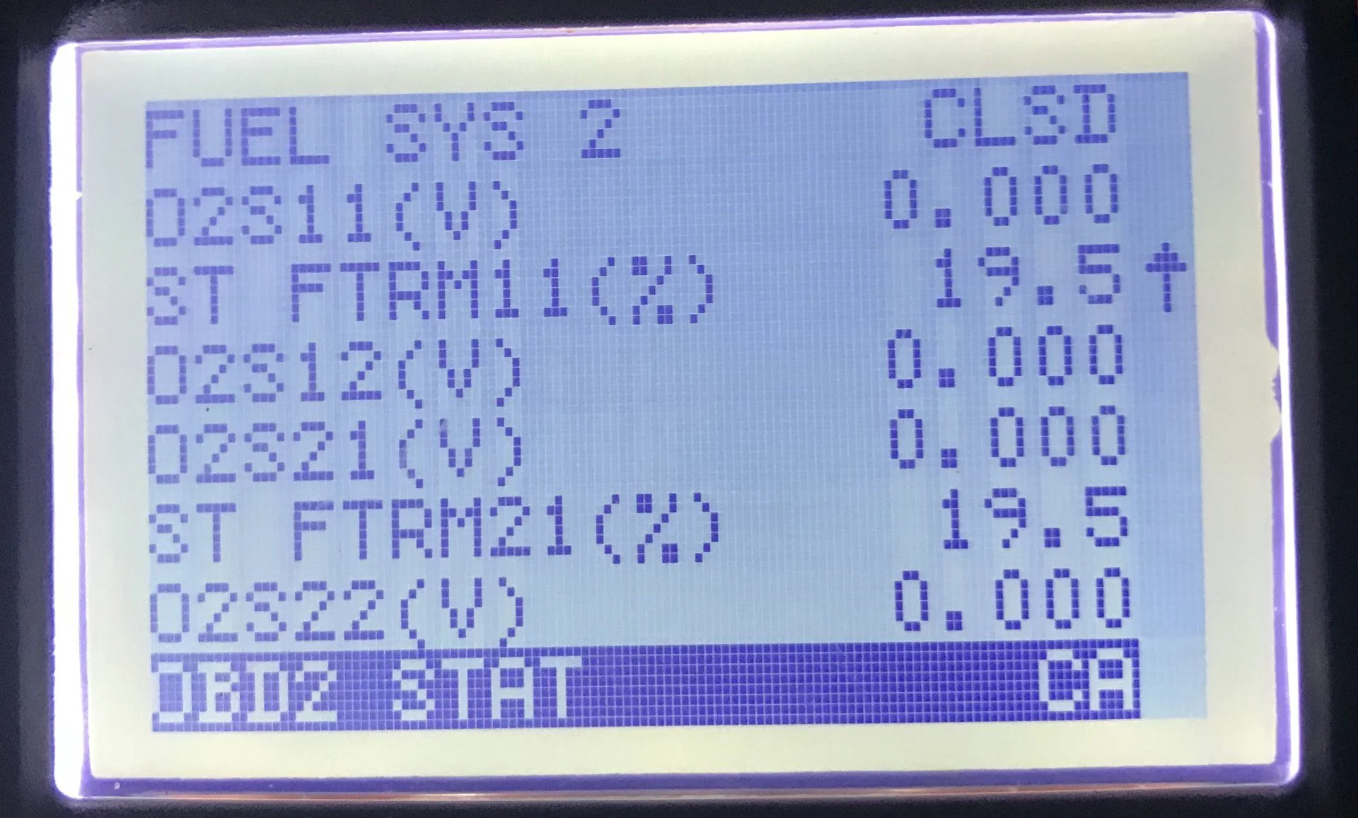

Yeah I might just do that if the EFI relay doesn't do it. My Bluetooth OBDII thing should be here tomorrow, so maybe I'll get around to figuring that out this weekend and be able to get some more information.
Bluetooth OBD plug is all set up and good to go. Now I just need it to die again and see if I get any weird readings I guess.

I had OBDMate up on my phone and I didn't see anything out of the ordinary, although my eyes weren't glued to it because driving.
Update: it wasn't the MAF either. Nor was it the fuel filter. It was the fuel pump, which finally died for good last week. Back on the road and feeling better.
