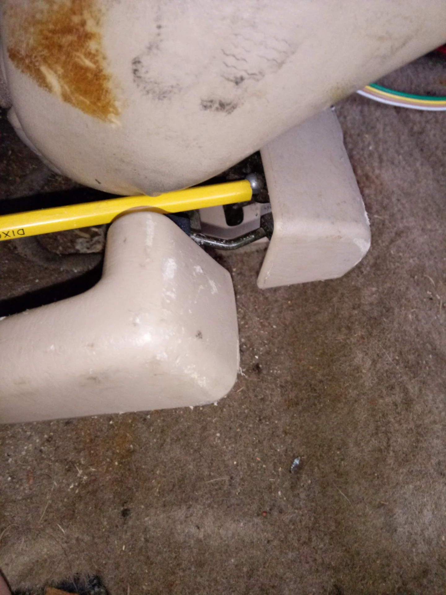

If you mean that it's stuck to the floor, and rotating the handle upward doesn't release the floor latch:
Rotating the handle upward pulls a cable toward you (toward the rear of the vehicle). The cable stop at the end of the cable is a metal ball. This picture shows the cable stop on the left seat (with the seat up, but the location should be the same with the seat down). Grab that with some needle nose pliers (or whatever works) and pull to the rear.
