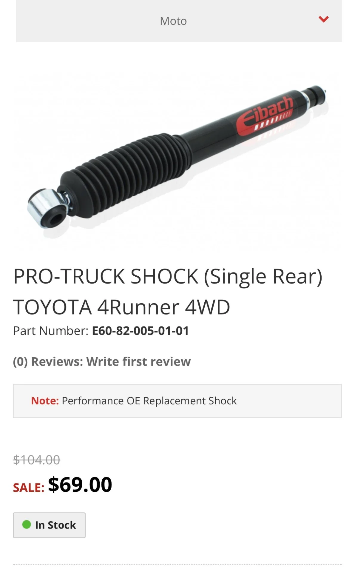

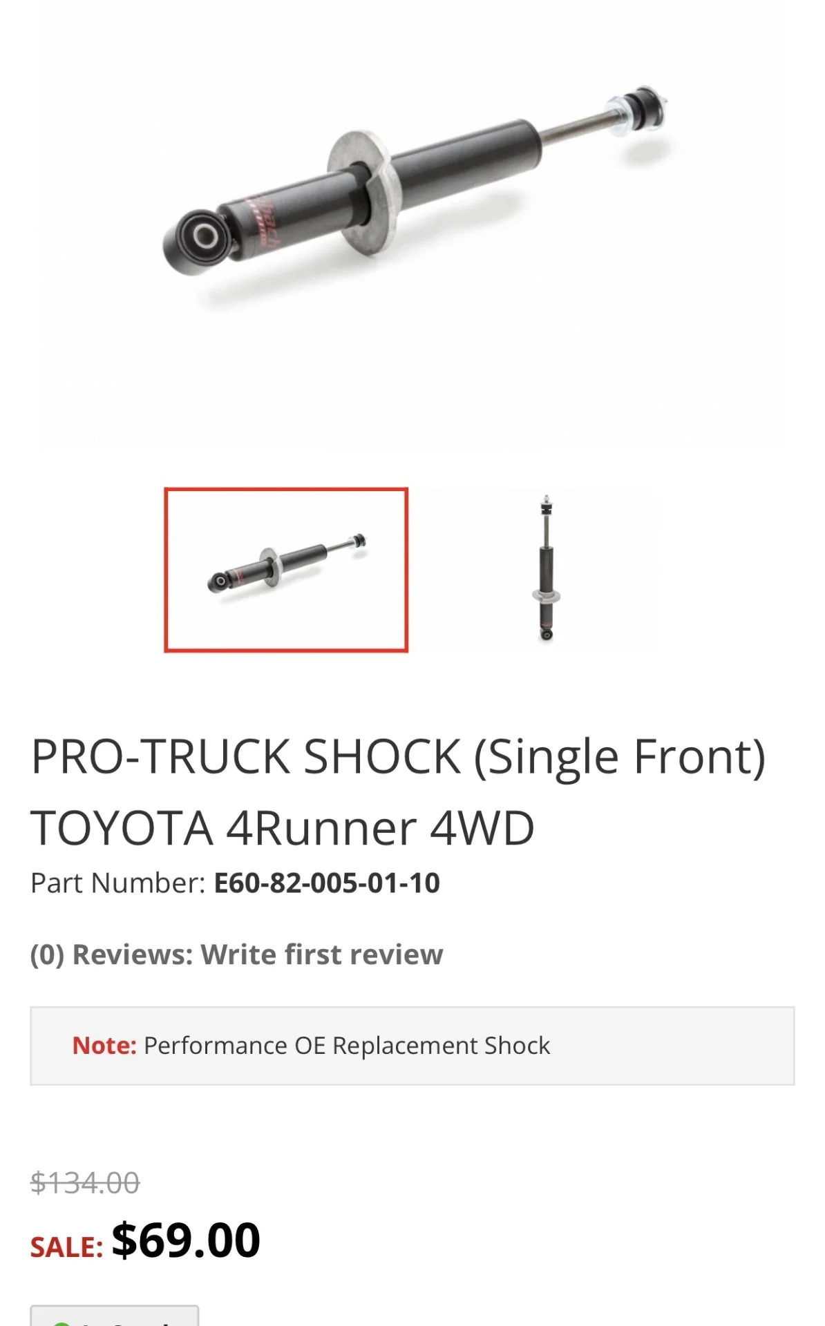

Well I need to learn somehow. I decided (at least until I stall) on Eibach OE replacement shocks from and rear. If it comes to lifting I’ll deal with that down the road. Eibach’d OE are affordable. Didn’t find any reviews on the OE replacements but hey I’ll review them. With shocks chosen I’m still trying to figure out springs.
If you plan on lifting it down the road, it may be worth it just to hold off and save up some more coin to just get a nice suspension lift. No need in buying new parts now if you only plan on running them for a short while - that's my .02!
If your shocks aren't leaking and the truck isn't swaying all over the road I'd leave it be for the time being.
I'll throw in my two cent's worth... ALWAYS measure the socks to make sure that they will accommodate all the wheel travel possible, especially on the rear. If the shock manufacturer doesn't publish that info, I would not buy it. I'll give you an example. Bilstein has the decency to publish that information, and it's a good thing they do because it reveals that their shocks, even the ones specifically for a lifted rig, are too short for my 5th gen. The shocks would top out about two inches shy of full extension of the axle. Not good. For some reason the front shocks on IFS vehicles don't seem to be as problematic as the rears when it comes to extended lengths.
