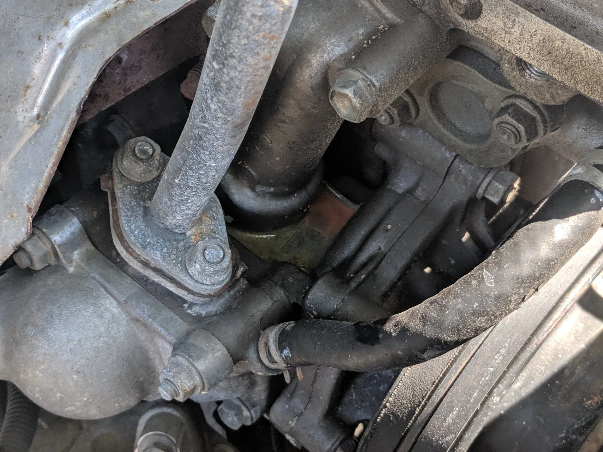

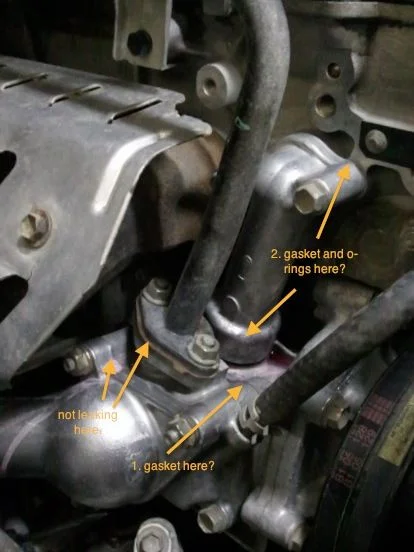

My LX has a slow coolant leak, and it seems to be coming from somewhere on the thermostat housing. My best guess is that the gasket between the thermostat housing and the heating hard pipe on top has failed, because coolant is pooling up on top of the thermostat housing, but everything taller than the thermostat housing is dry. Does anyone have a parts diagram or a list of the gasket part numbers? I want to remove the entire housing and replace all of the gaskets while I'm in there. Thanks.

There are large O-rings inside that pipe that runs up to the head,
could be the source of the leaks. Try a search for Oring/s (or O-ring)
pipe leak
Here's one discussion:

(1) 16351-66010 outlet, Water by-pass
(1) 16268-66010 pipe, Water by-pass
(3) 90301-29006 O-Ring
There is a smaller pipe inside the Water BP outlet that has O-Rings on it. Possibly the source of your leak.
