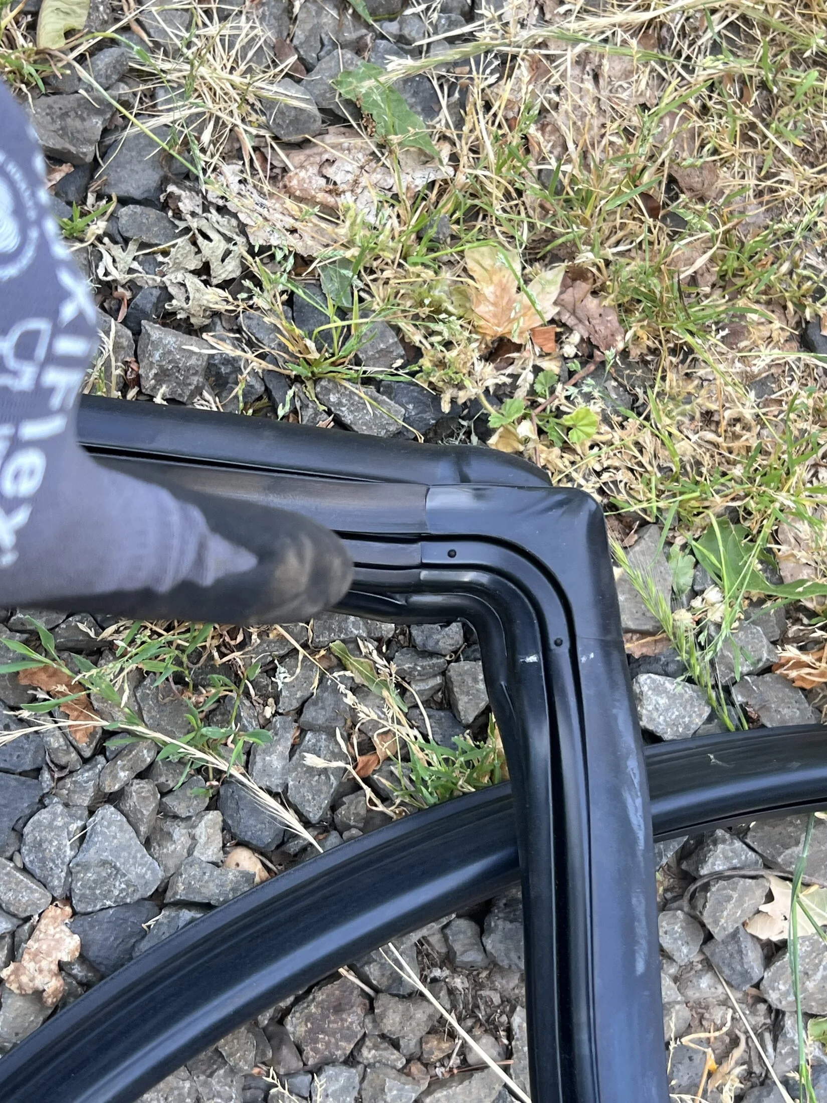

Hey mud so I had a glass guy come out( high quality professional installer works for all the dealerships) he pulled my glass and called me and said i ordered the incorrect gasket 56121-60110? He said the gasket does not have the locking tab and I need one that does. I found another gasket 56121-60100 that is listed for the truck but was hoping someone could verify the part number and have real world experience with an install. He was prepared to do the install correctly sealing the gasket to the windshield and the gasket sealed to frame. He stated without the locking gasket the windshield would be loose and leak. Picture provided from him with the locking strip in place on the old gasket. Thanks on advance.
Your glass guy seems to know what he's talking about.
US trucks have no locking strip, and use 60100.
Some non-US trucks use 60110, which do require a locking strip, or they will leak (see the thread below).
