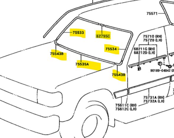

I went over to the garage and came to understand that they were talking about the chrome strips that go into a grove in some 80 series:
I did not believe it at first. But they showed me that when I pressed on the gasket, water would flow out from a gap between the glass and the rubber. It is true that this chrome strip, when installed, actually forces the rubber against the glass, completing the seal. And several threads here on Mud say the same thing, when I looked. So I have two choices: get the chrome strips:
75534-60010 Moulding, Windshield, Outside Lh
75543-60010 Cover, Windshield Moulding Joint, Lower (quantity 2)
75535-60010 Moulding, Windshield, Outside Lower
75533-60010 Moulding, Windshield, Outside Rh
62795-90A00 Cover, Quarter Window Moulding Joint
Or, replace the gasket with one that does not have a grove in it. Certainly it would be easier to just put in the chrome strips, but unfortunately, 75534-60010 does not seem to be available. Moreover, I really don't like the look of the chrome strip and I was going to have to powdercoat them anyways. So I decided to get a weatherstrip without a groove in it.

So I just bought 56121-60110, which is the part number ToyoDIY indicated. It came with a goove and I did not really think about it much, and just had them use it, resulting in the leak. I now realize that the Holy Truck must have had it new--and now that I look again, ToyoDIY lists the crome trim parts as applicable. So what is the part number without the groove? I found it very hard to figure this out, and my parts guys could not figure it out it either.

So I've concluded that 56121-60100 is the part without the groove and 56121-60110 is the part with the groove, which kind of makes sense, part number-wise. Fortunately the 56121-60100 part is available on the market here. I will post an end to the saga once the part arrives on Monday and I get it installed.
