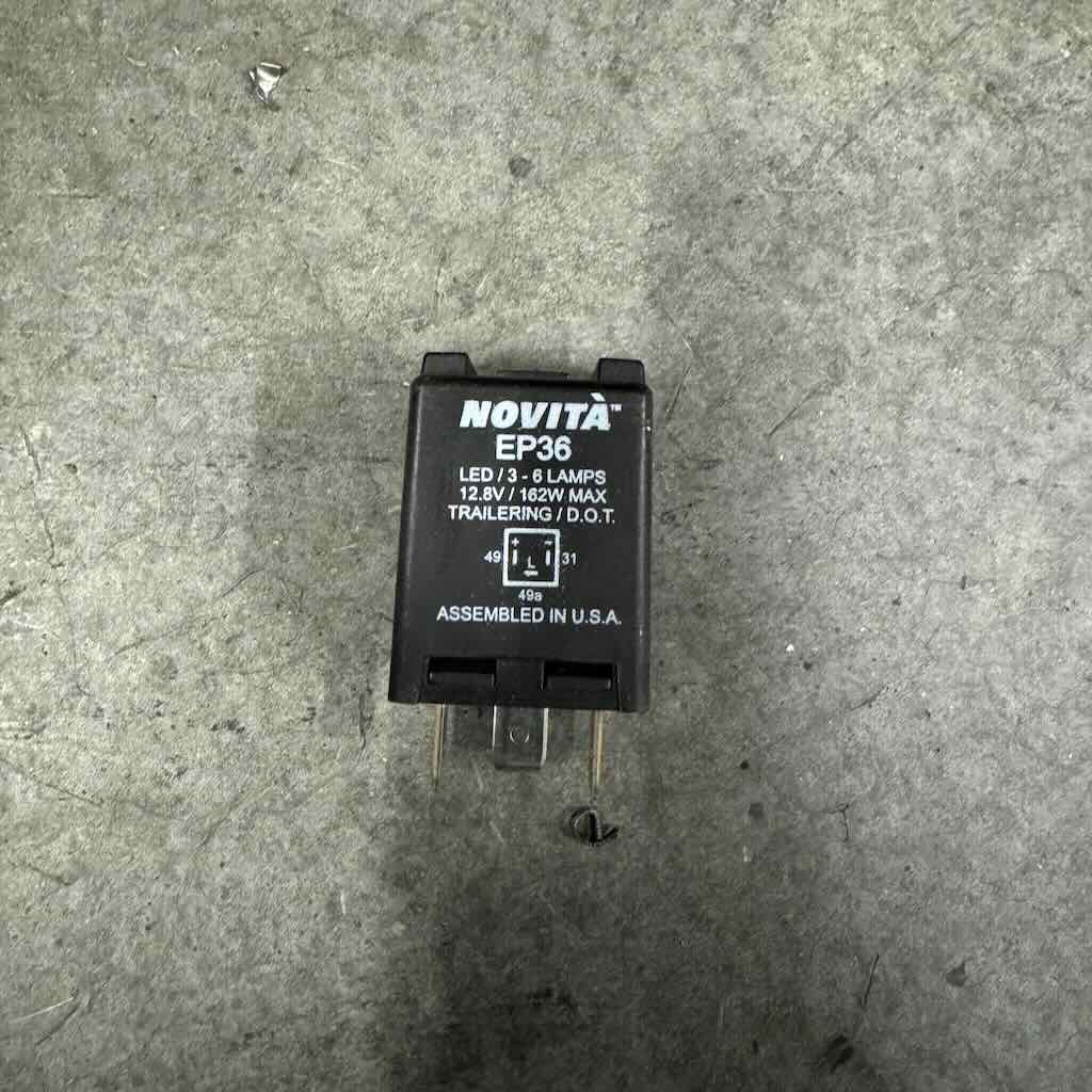

You want EP36, we include Novita EP36 with all our front bumpers with only one bad one reported to date. Oreillys stock them. Have tested the amazon ones with poor results.
I'll second the poor results of the chineseium amazon relays.
You can order the "Novita EP36" on amazon, but if you notice in above pic, it says "assembled in USA". The Novita EP36 received from amazon does NOT say that. That was the differentiating factor on our end and anything we tried that doesn't have the "assembled in USA" on it has not done its job.
