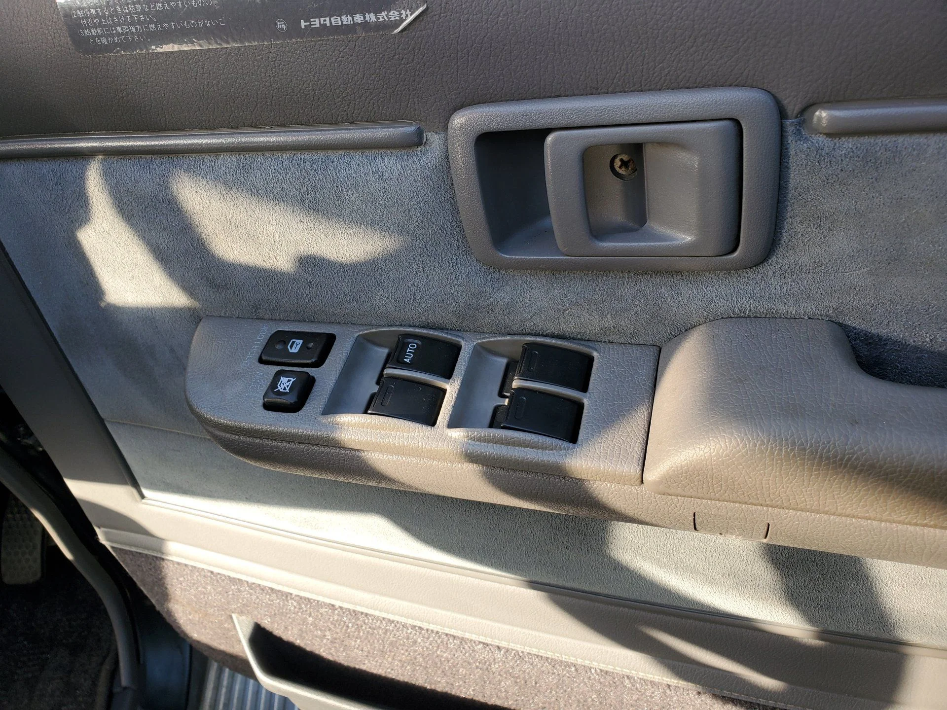

Got my new window switch yesterday. It's not OEM but certainly works.

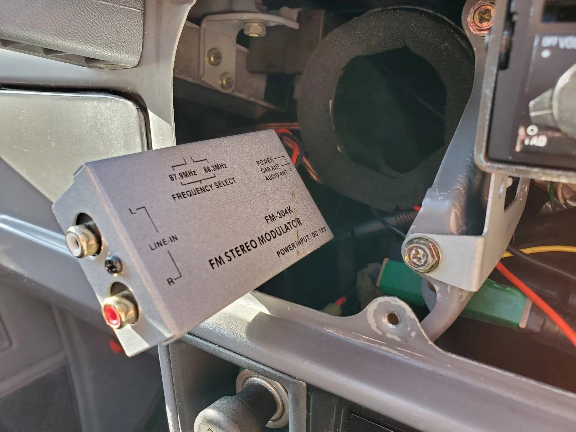

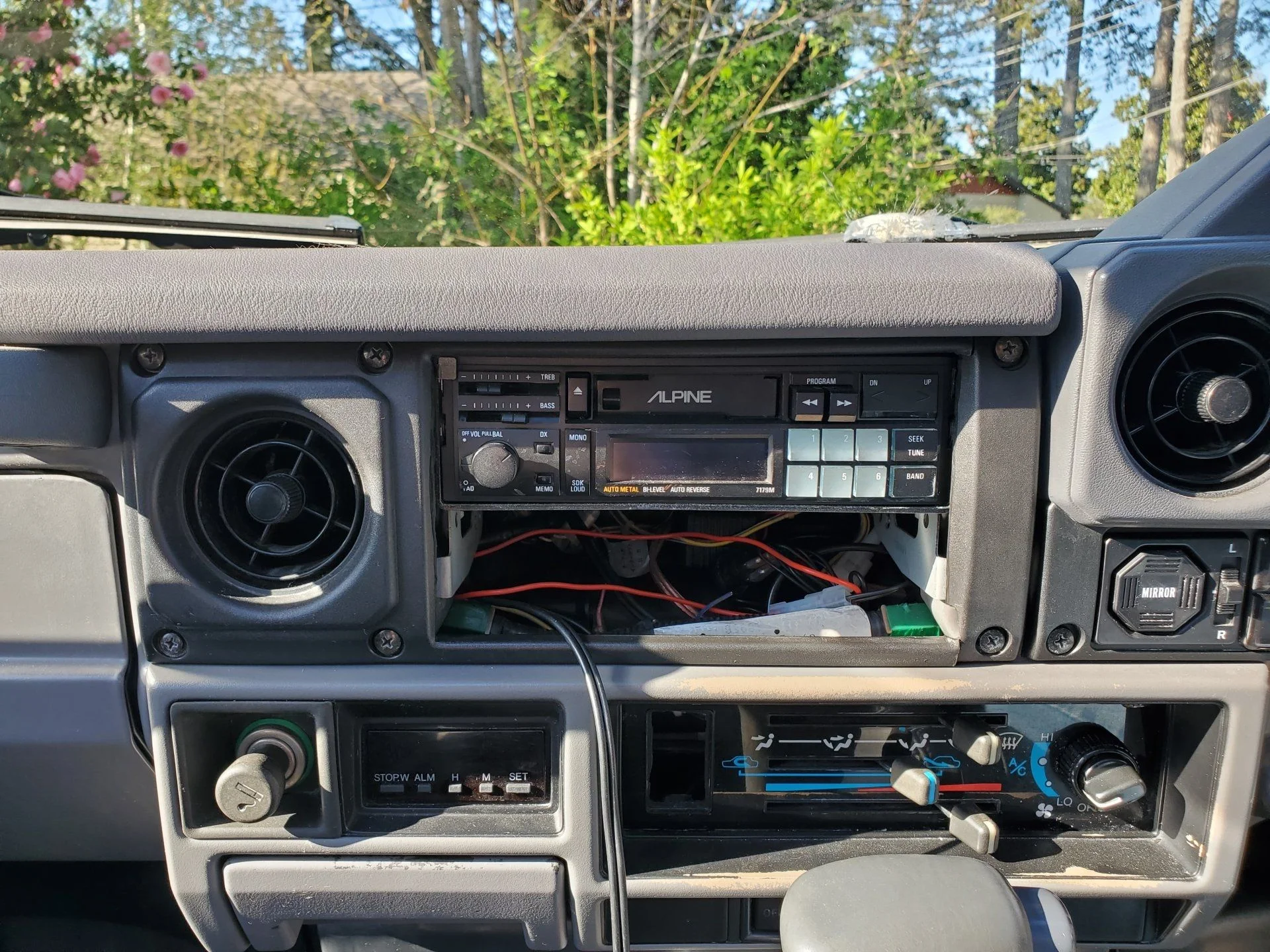

Installed my tape deck today. The truck had a 2 din touch screen when I bought it. If it wasn't going to be original I wanted it to be period correct and a design that complemented the rest of the dash. The old Alpine 'ice cube' does nicely.
Just need better speakers, an amplifier and a storage cubby for below. That trim bezel has also seen better days. Will be replaced eventually.

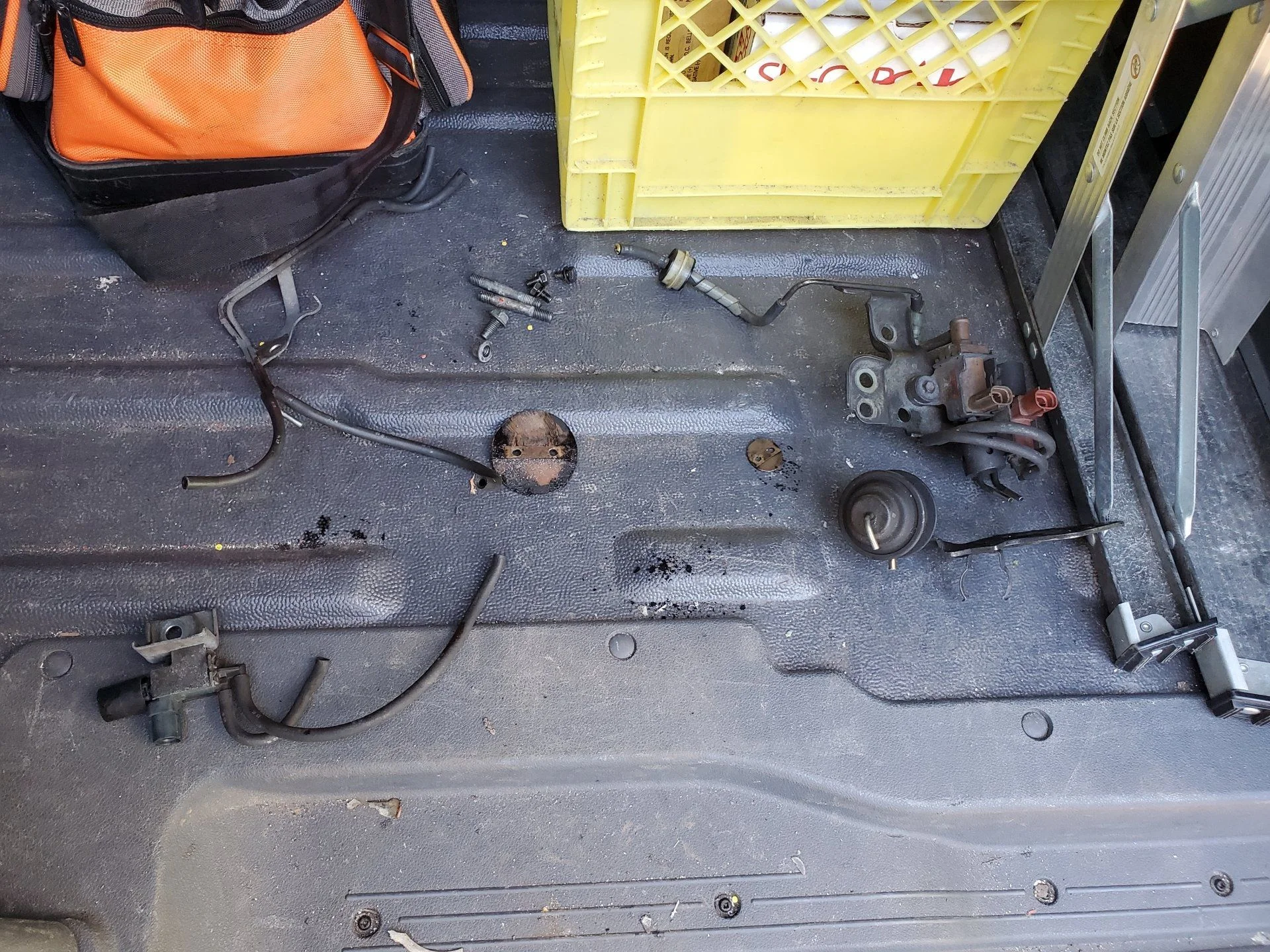

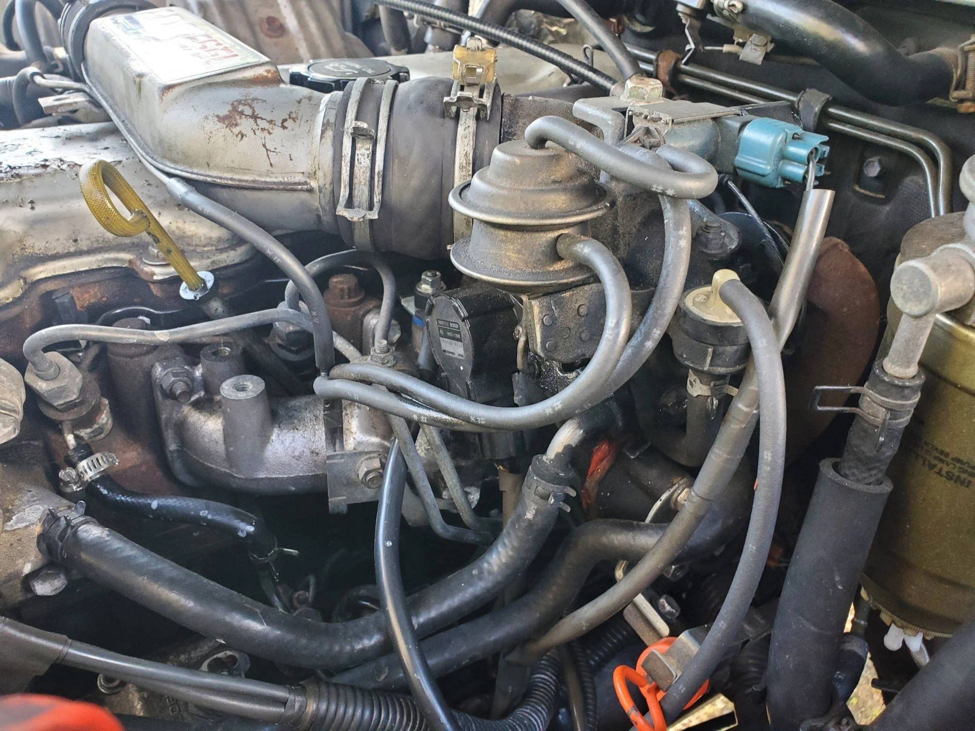

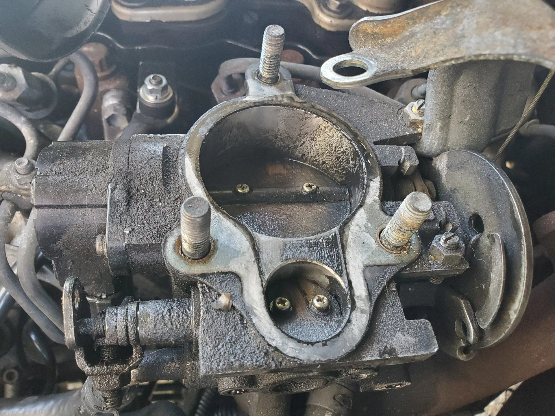

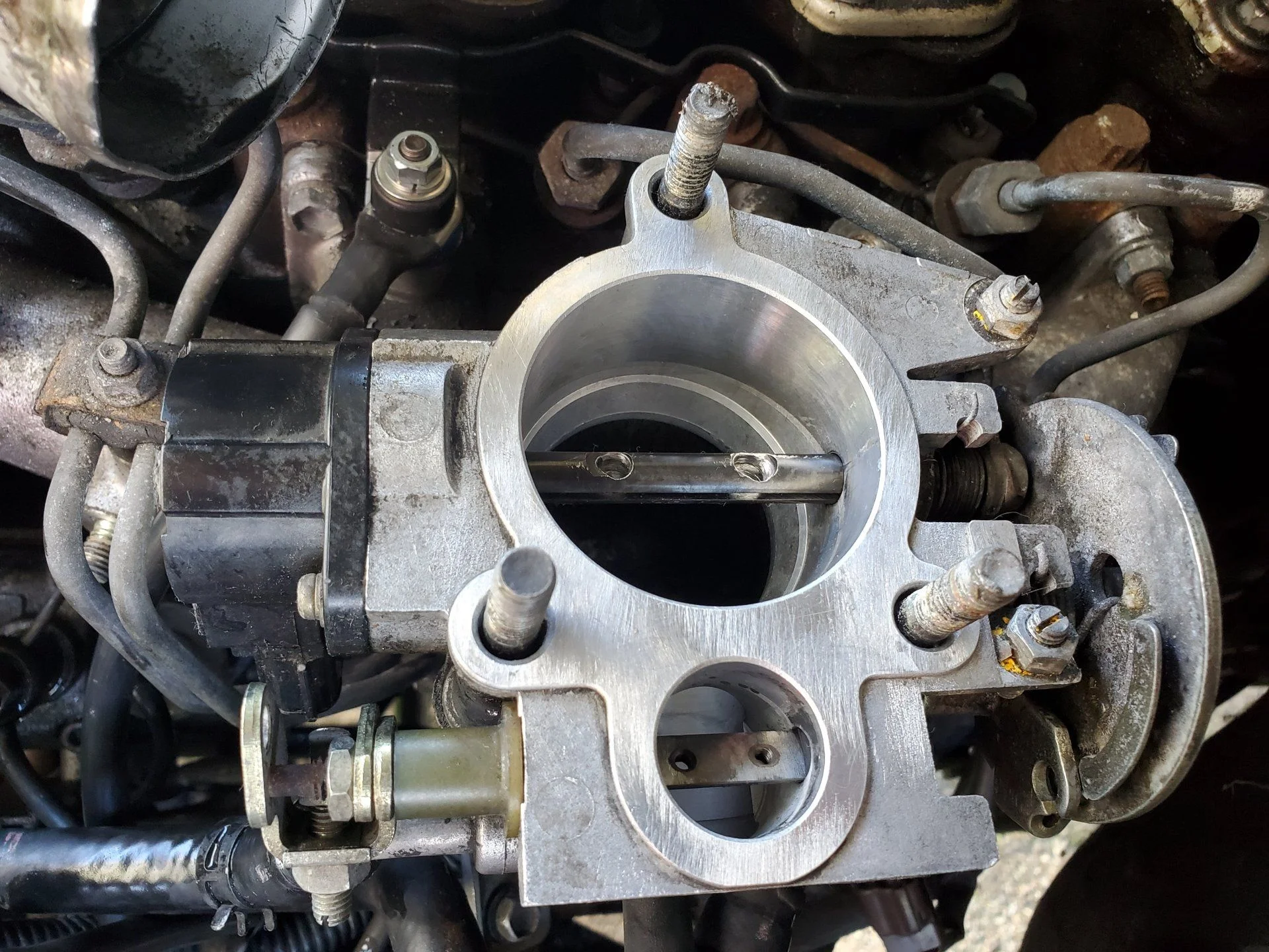

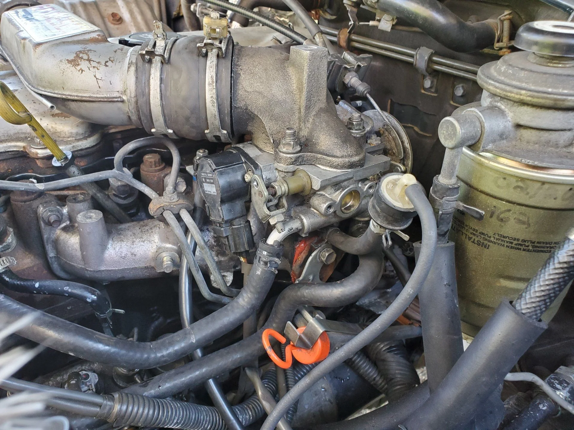

Got around to finishing up my EGR delete today. I did sort of a half job earlier, only doing the block off plates. At that point I was diagnosing a noise, now I'm trying to make it run better.
The two plates in the venturi are now out. All the vacuum nonsense also removed. Feels weird taking this much off.
A few random photos of the process...
I've been having an issue with my idle. I was sure it was those plates and that this would solve it. Not the case though.
My RPMs will drop by about 100 for a second then back to normal. Parked or at a light, cold or hot, doesn't seem to make a difference. I also notice it when at cruising speed, but more of a slight variation. Almost as if I'm not steady on the throttle. I should also mention that it's a little inconsistent.
I haven't been out for a drive yet, but it's still doing it parked in the driveway. Will see how it does out on the road.
You'll notice a significant increase in low end torque with those throttle plates gone. A major upgrade in my opinion!

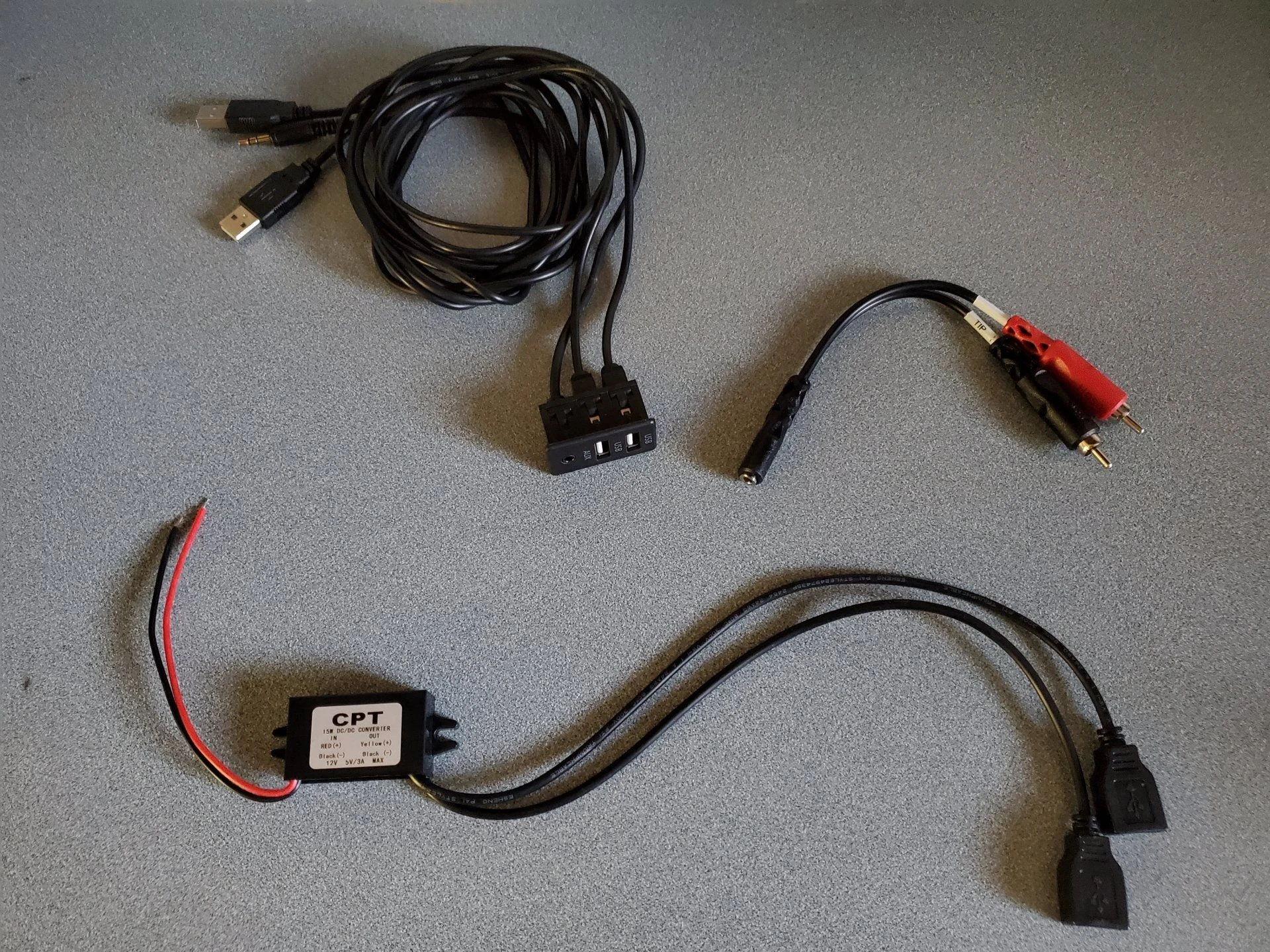

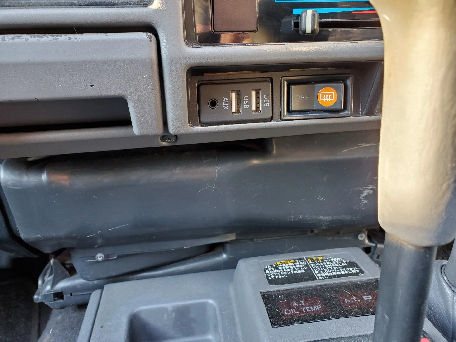

Added some modern comfort today.
The end result...

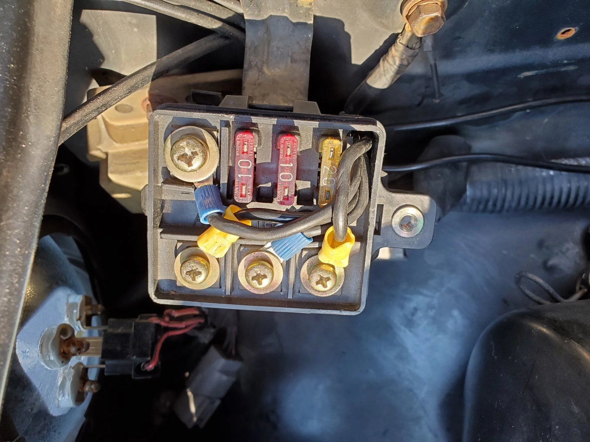

Fits in the switch cover hole perfectly. The USB ports are wired direct to battery via the power outlet under the hood...
On a side note. How great is that power outlet? I have my daytime running lights wired to ignition, my deck and glow plug switch on ACC.

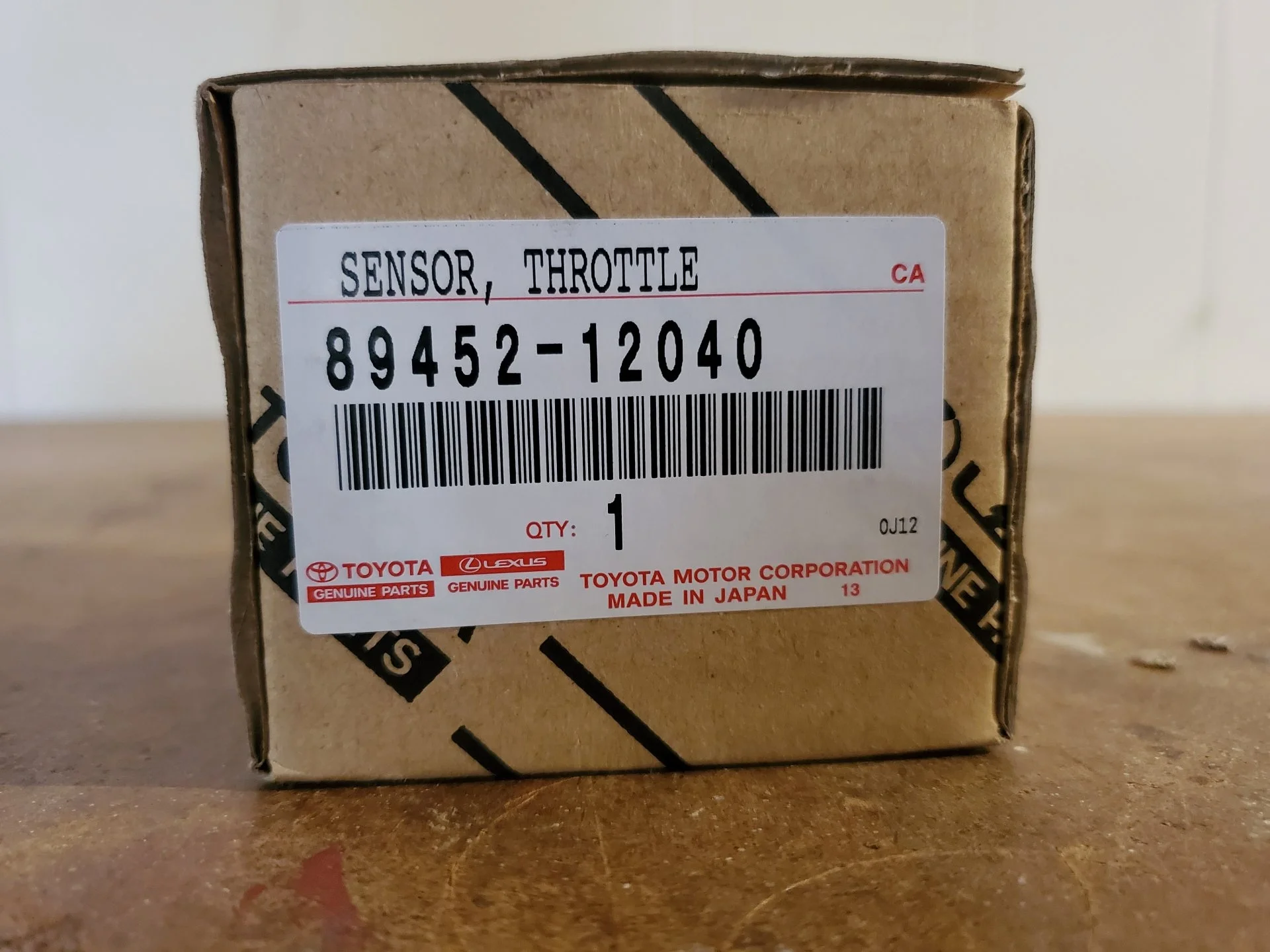

Replaced the throttle position sensor today. Previously I had an issue with my RPMS jumping by about 100 and back down while driving. Stopped or parked, there would be a drop by about 100 for a bit, then back up to normal. With the new sensor everything is normal. The sweetest part is the Toyota dealership actually had one.
Got a little ahead of myself. After going on a bit of a longer drive, it's apparent the throttle sensor did not solve my issue. The RPMS are still doing their surge/drop routine. It doesn't happen consistently, sometimes it doesn't happen at all, but often enough to be concerning.
What type of plates did you use to block off the egr? Did you customize them or buy them?
I made my own by tracing the gaskets on 1/4" plate steel and cutting them out with an angle grinder. Sealed with red RTV. They're pretty crude but they work. Hardest part was finding steel thick enough.
where did you buy the steel?
Ended up finding it at Lowe's. Had to buy a square foot plate unfortunately. 3" wide steel bar would have been better.

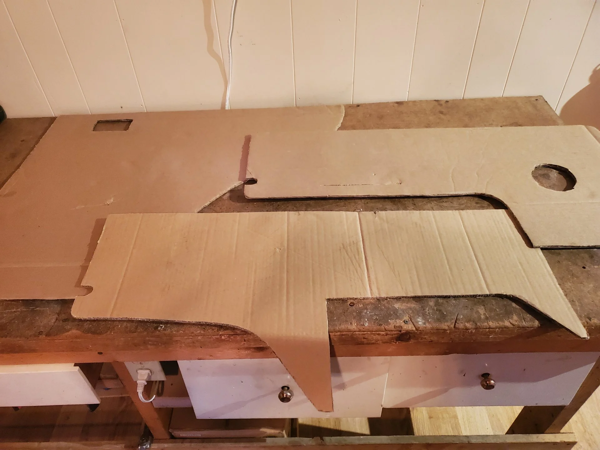

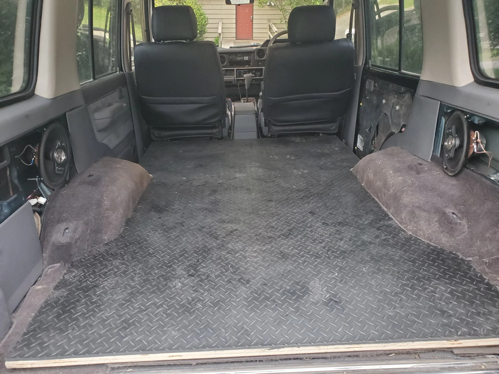

Built a floor for the back this weekend. Not quite finished, needs trim. Gives my three dogs a solid level surface to stand on that dries easily. Gives me a decent surface to sleep on occasionally also. The finished product ended up being pretty heavy (80lbs), but lots of weight lost taking the seats out.
I also made some templates for ABS interior panels so I can put the originals in storage. Clean and dry is the goal. Hoping to get to the plastic shop this week, looking forward to finishing this bit.
