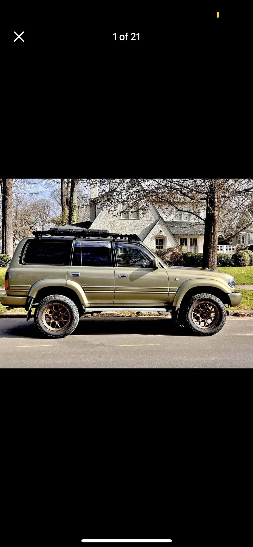

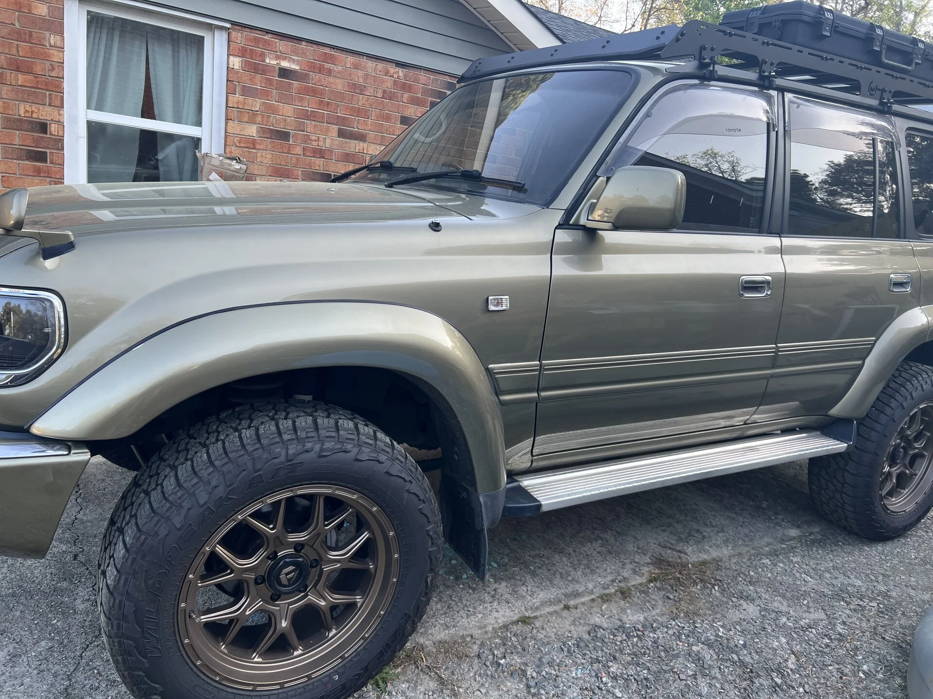

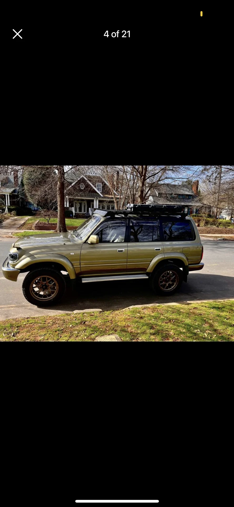

Hi guys,
Noobie here. I’ve never owned a diesel, let alone Landcruiser before so this is a new experience for me. I’m looking to pick up this one this weekend for a price I’d rather you not ask 😂😅.
I’ve always loved the look of the 70 and 80 series and now that I’m financially stable enough I really want to pull the trigger on this one. It has a 1-hdt which I’ve read is pretty bullet proof.
This is just a basic cry for help on what I should look for when going to pick up and what I should generally expect as mileage goes up. Vehicle was imported from Japan last year and has 110k on it. I would love to do maintenance on it myself but was thinking parts may be hard to find as it’s an import. I’d love any input you guys can offer!
Appreciate the add!
-Clint
