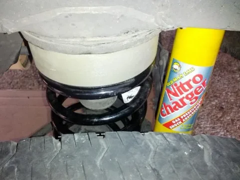

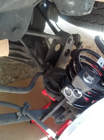

Below is the spring compressed as much as possible.
With the spacers installed. Had to whack it with a bfh in order to get it past that 2 inch spacer.

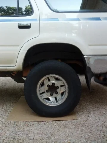

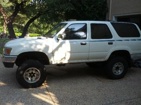

How the rear is sitting. Its up about 1.75" with the added spacers.
And the rig in its entirety.

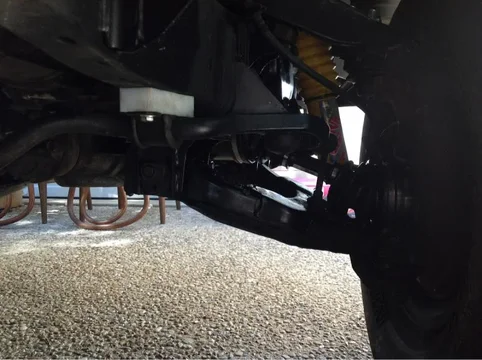

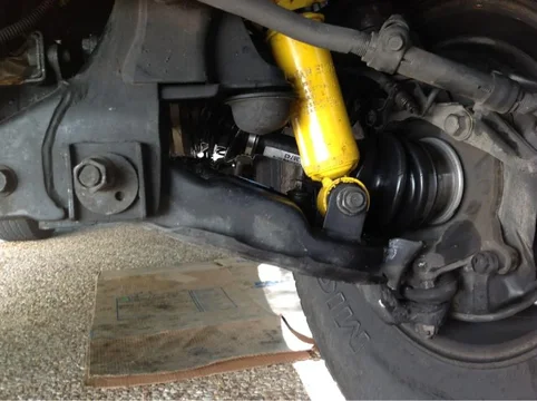

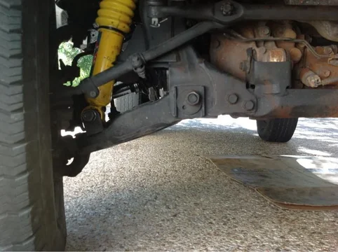

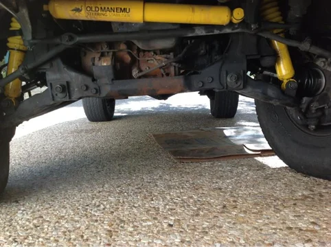

Can you take a picture from the front of it sitting so that we can get an idea of how steep the operating angle is on the cv's?

Here are some shots of it. The torsion bars aren't cranked all that much. But I suppose lowering them all the way would help.
Passengers side
both
Drivers side
rear view of passengers side
Sent from my iPad using IH8MUD
That actually looks like a lot of angle on the A arms to me... The inner boots are not designed to take much angle at all. Just the up and down motion as the tires flex some. The outers are designed to deal with the wheels turning side to side a good amount, so they will probably be fine...
Yeah, about the only time mine looks like that is when I have a floor jack under the center of it. My arms are actually almost flat with the driveway, and if it were me I would back the T-bars down until you had the CV's level and then crank it up maybe an inch or so above that.
And if they are cranked to the upper arm stops, you are basically running the joint at it's most extreme angle all the time.
