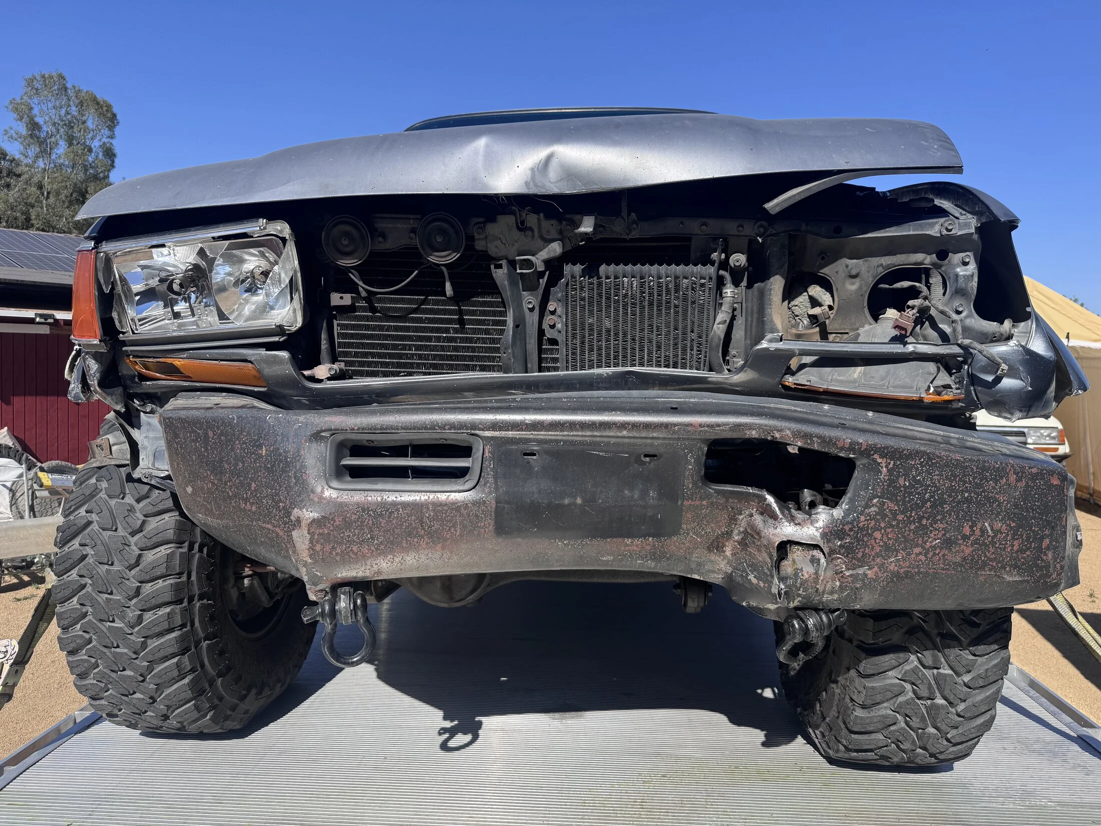

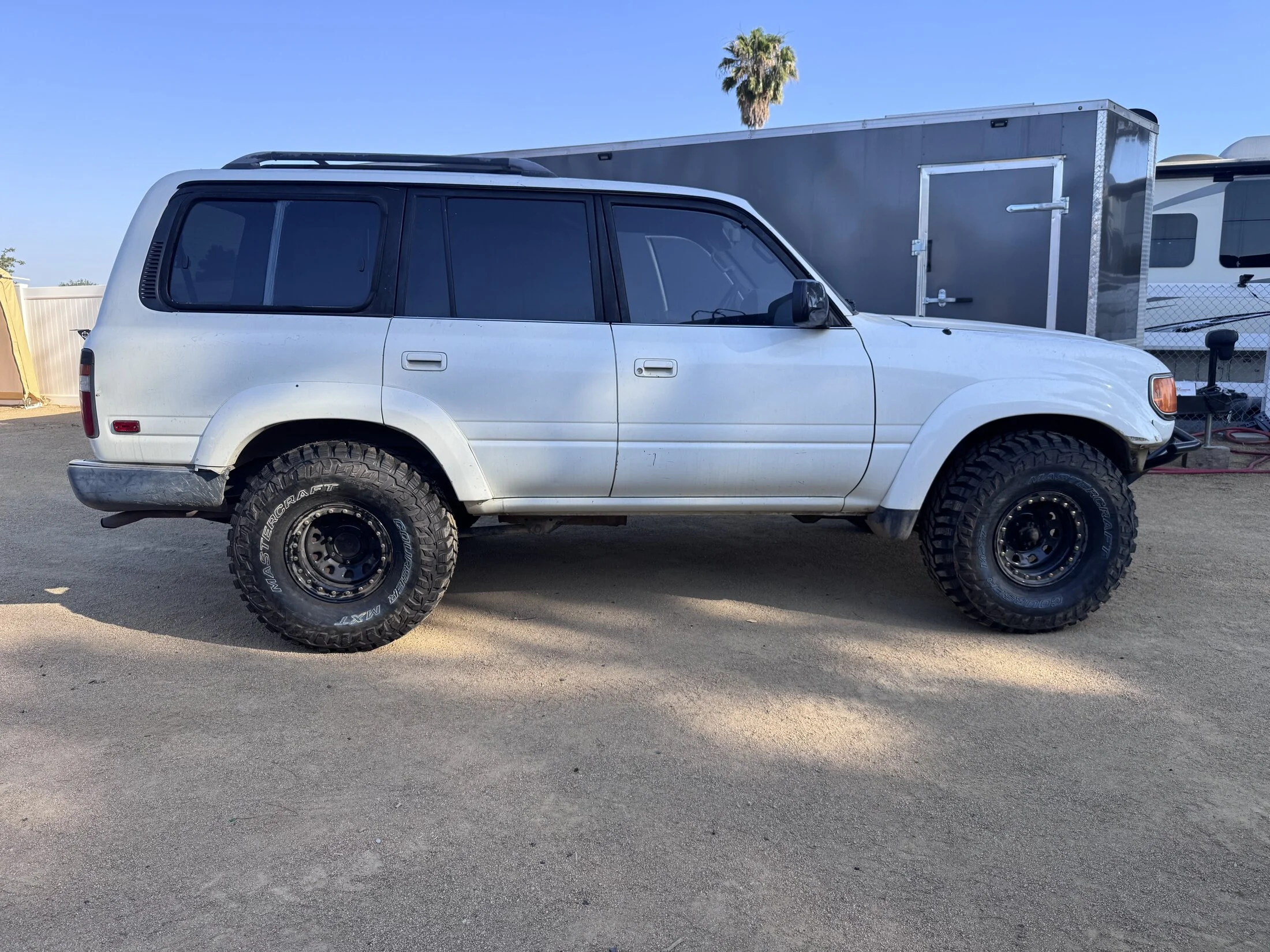

So my 93 got totaled sat. My 91 is so slow that only way I can be happy with it is it I engine swap it or sell and buy a 93+
