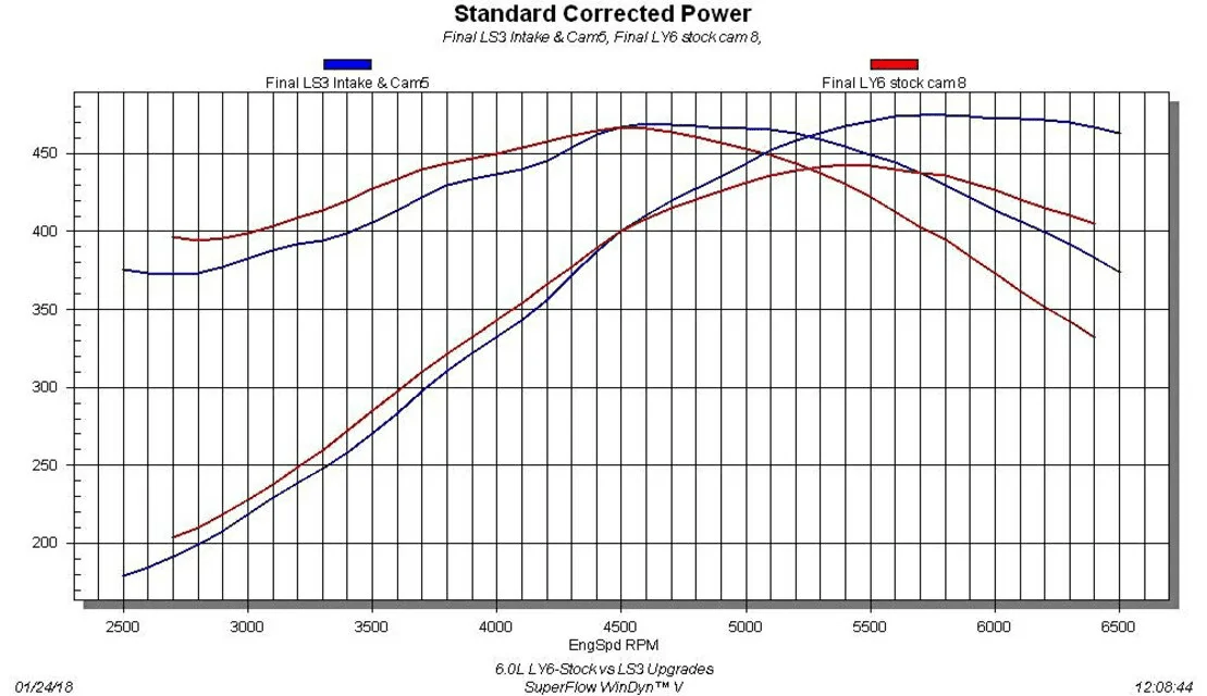

Doing some research on dyno power levels between a 6.0 vs 6.2 ls motors and how much power does the extra.2 liter give. Here is a dyno of a ly6 6.0.
The blue is with a Ls3 cam, the red is with a Lq9 cam(443hp, 467ftlbs), which is the same as the Lq4 cam. This motor has 9.6:1 compression. Here is the source: Converting a Truck LY6 Engine into an LS3 for More Power
Here is a dyno of a 6.2 with a Lq4 cam.
Here is a truck 6.2 with a Lq4 cam and it shows 445hp and 460ftlbs which is the red lines. The blue lines are of a stage 4 cam. This motor has 10.5:1 compression. Keep in mind the two graphs start at different rpms so that makes it a little harder to compare. Here is the article...

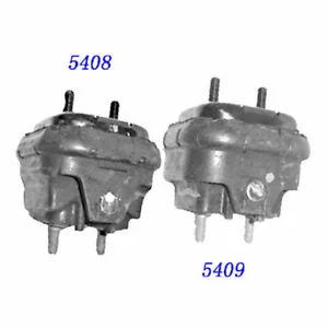

those are probably going to be too stiff for a LS. They squish good with a motor that weighs triple.
I'd recommend the Envoy/Trailblazer V8 mounts if you want maximum comfort, just have you get your hands on the brackets to bolt them to the motor which aren't available new so you'll have to get them from a junkyard.
I'm now running one of these on the compression side (passenger side) and a Jeep XJ leaf spring bushing as the mount on the tension side (driver's side) and am very happy with it on the road so far. Trail testing next weekend.
