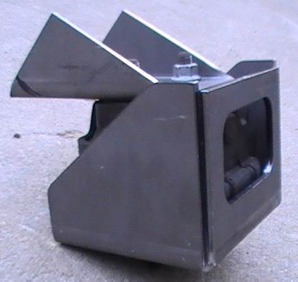

@Joe Link there have been members who have used OEM GM rubber to mount the engine. The only one that sticks in mind right now is @kirk second engine swap into his 80. He changed from a LT1 to a LS2. He made his own mounts that used rubber OEM trailblazer engine isolators.
Found a pic @Joe Link
Basically identical to Advanced Adapter style, but with OEM rubber instead of a urethane puck. Pretty tits if you ask me.

1. Don't cheap out on mounts. The Land Cruiser shop ones look decent but if at all possible fab a mount to use an OEM mount. Don't bother with the Marks mounts and definitely don't go with the Dirty Dingo mounts. I'm not a fan of puck style aftermarket mounts.

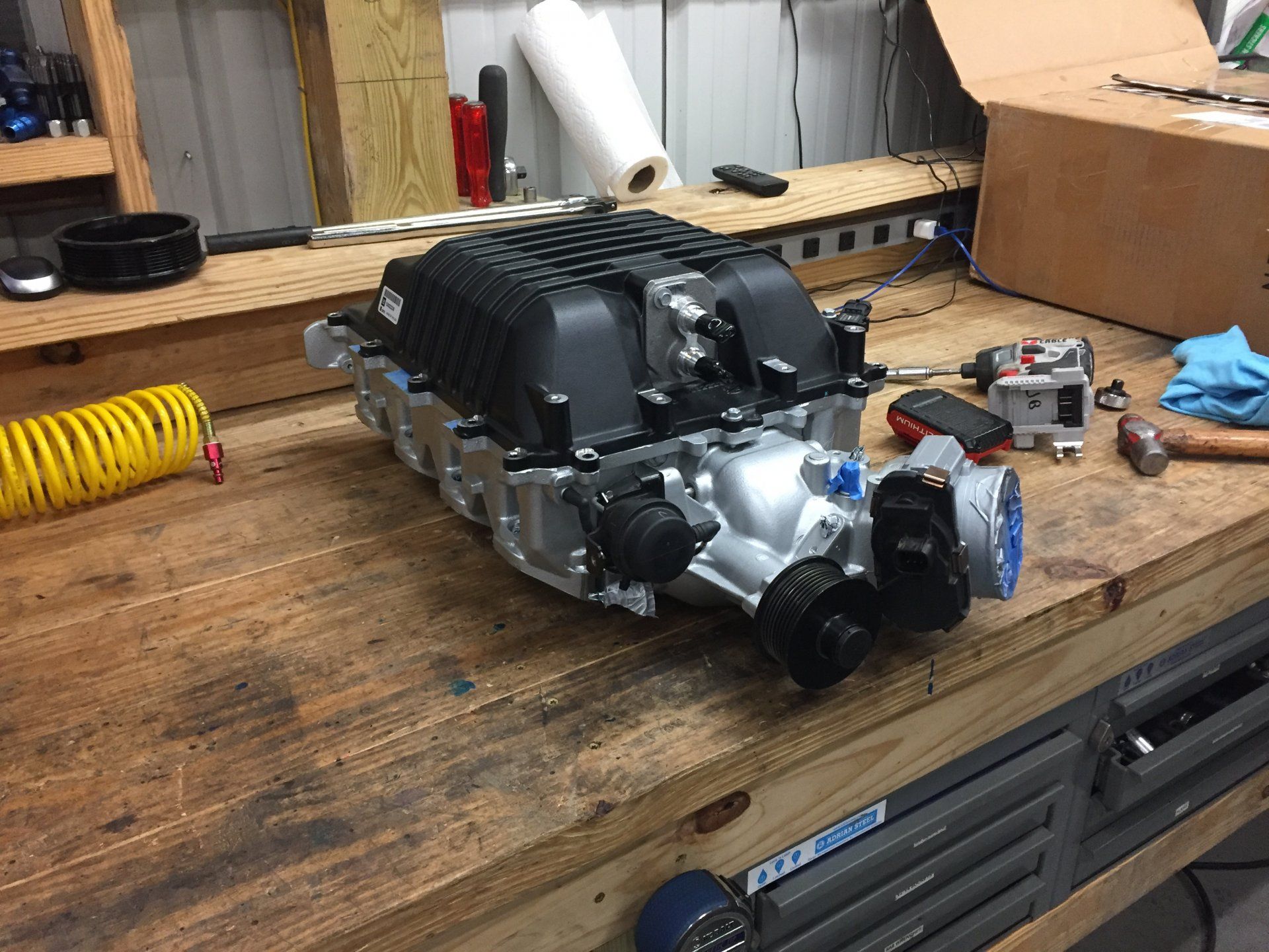

I believe you can get lsa supercharger kits for like 4k for cathedral port motors. With the supercharger and adapters.
yeah you can. If you watch for deals I've seen complete setups go for as low as $2500, not a bad deal for how relatively easy they are to install, but really should budget another $2K at least for supporting fuel system, standalone, etc
Turbo is a much more budget friendly option
Sounds like the only way to use the factory GM mounts is custom fabrication then? Are there any off the shelf options you guys know of that would give me a good starting point? It's not out of the question, just not something I had anticipated.
