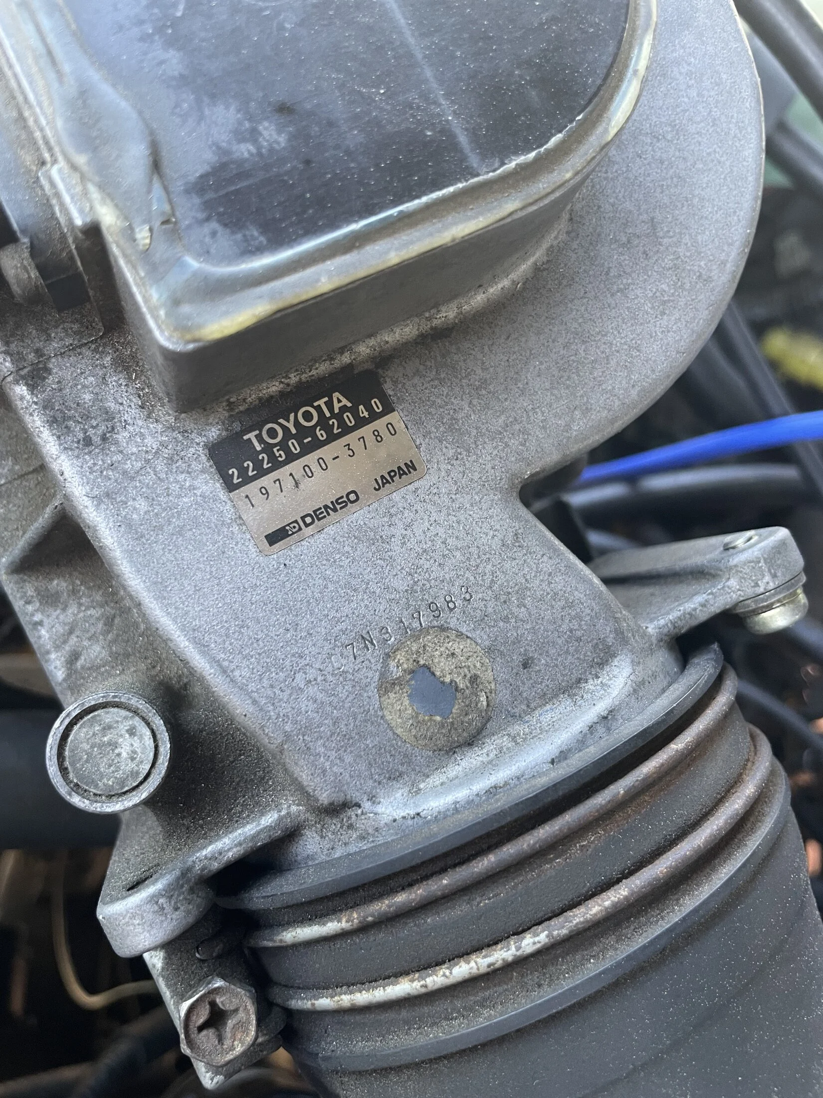

Here's the PN for the Camry AFM. HTH.
Looks like that part number is NLA, but some used ones are on fleabay...
