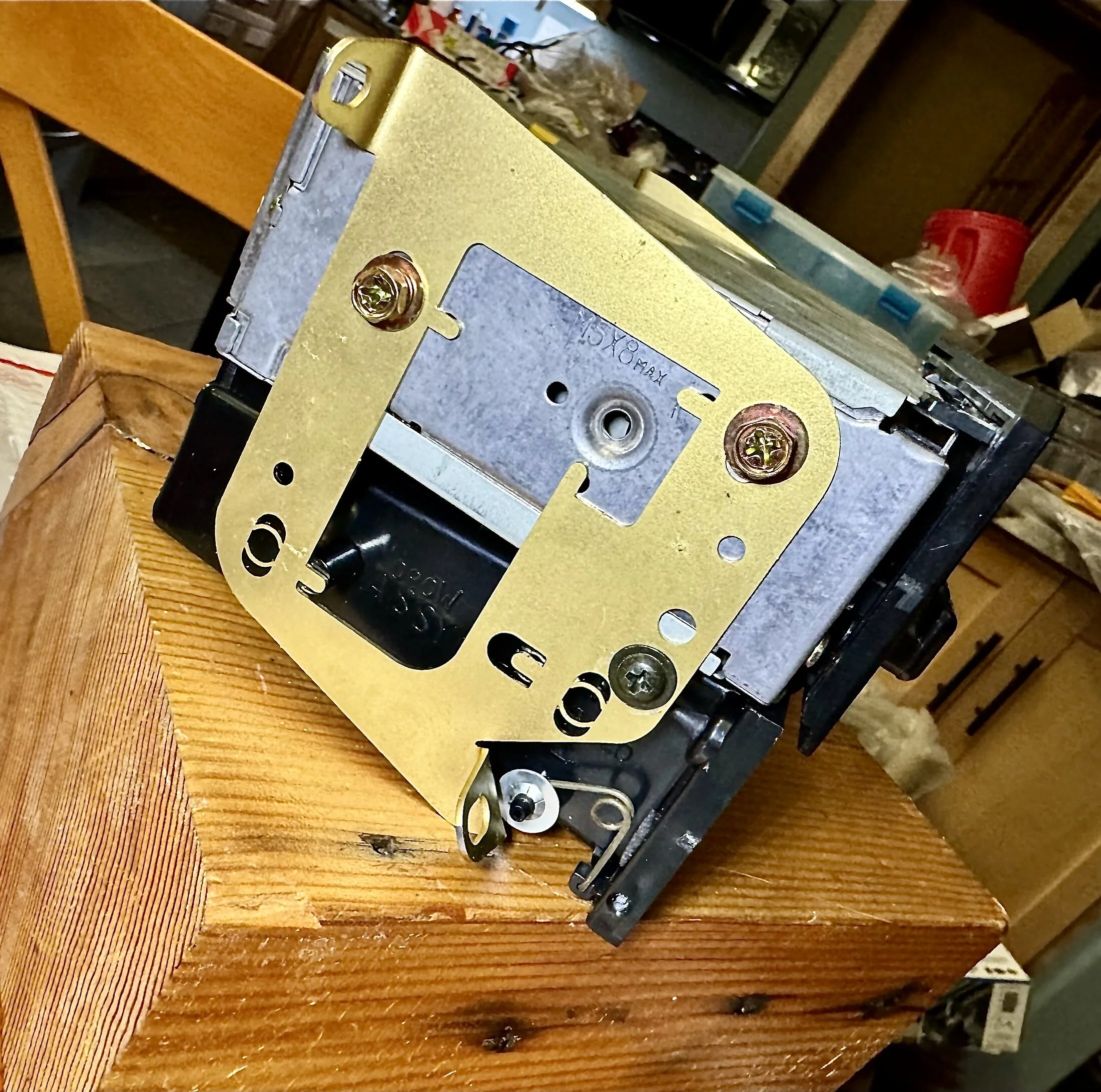

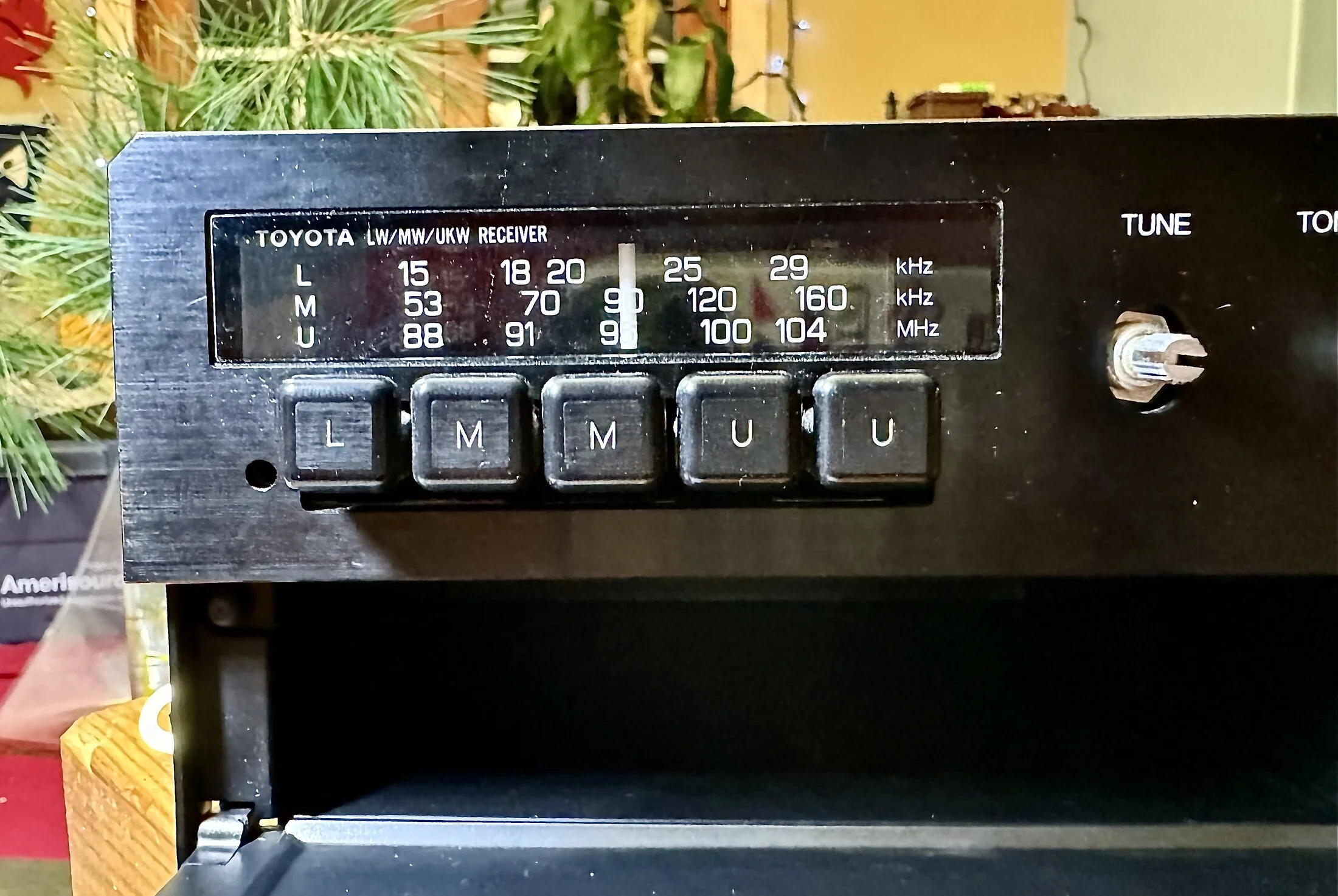

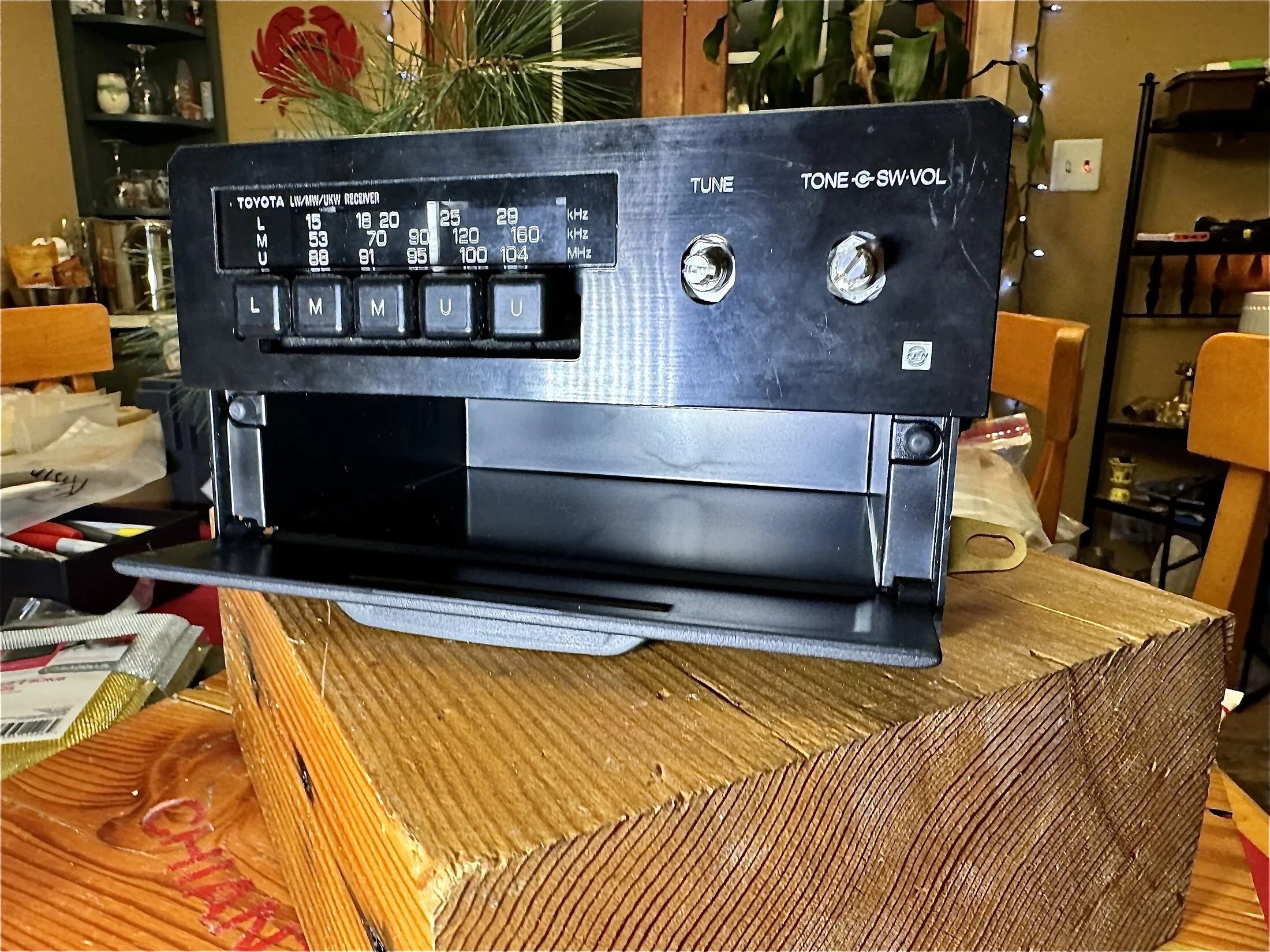

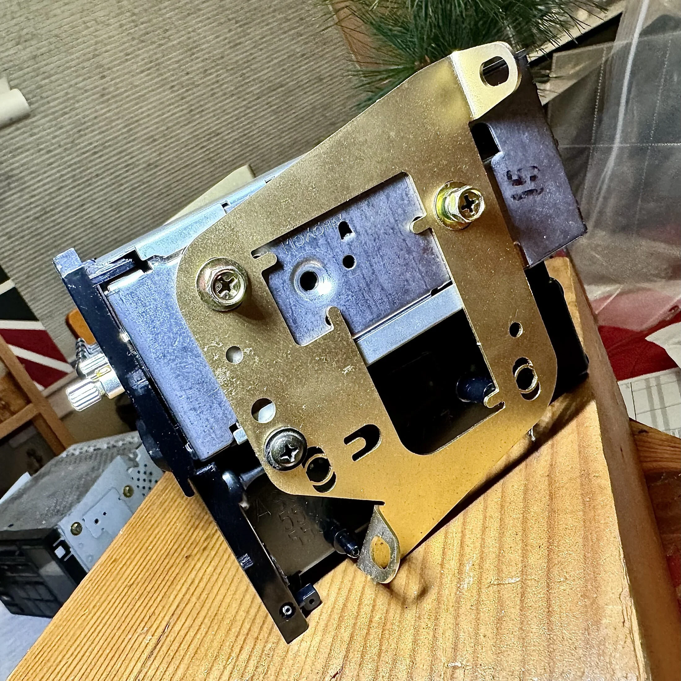

This is my current Pet Project for GHOST ….
She is a full size double DIN as well …
The top face plate is taller and wider a tad ? I will be planing them down to match a conventional USA Spec one …
The little trap door flip downs has a maze of hole patters on. Each side
I can say for FACT this flip box will
direct bolt to any first gen. Double
DIN opening , all both sides DINS brackets and key tabs in its top to
The OEM FULL SIZE singie DIN
as well ….
I have only seen it once , a CB40M and
This were filling the double
DIN hole
box was on top
I am really chopping at the bit to see and hear what exactly this rascal
Receives and I hear ….
