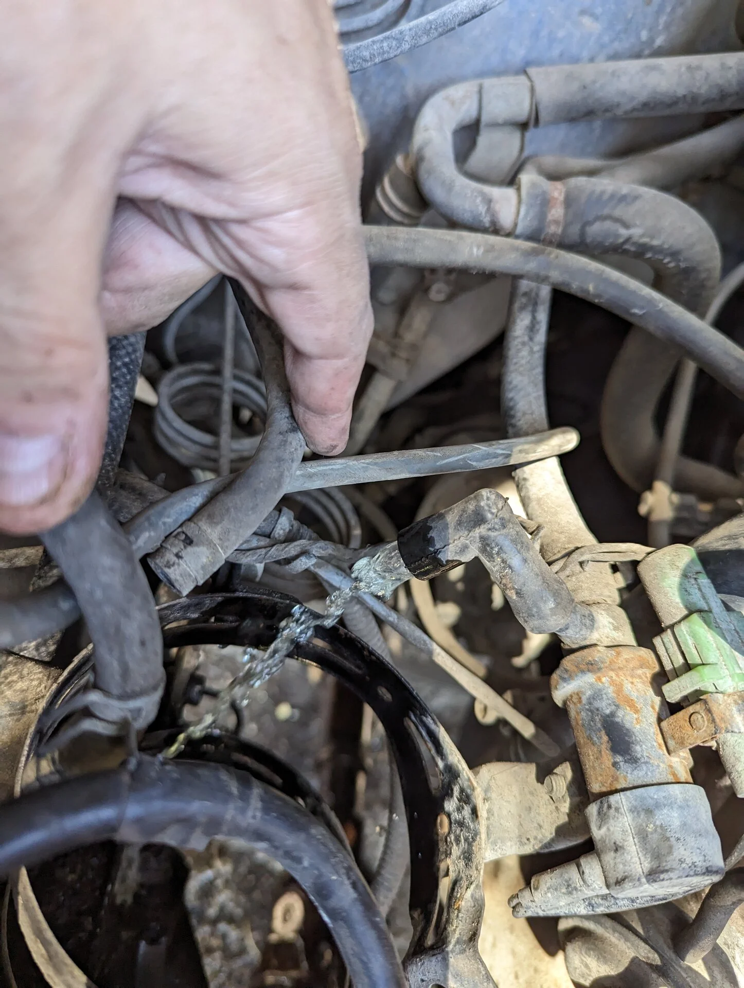

Turn fuel pump back on and soon fuel is dumping out of the larger diameter hose that was connected to top of fuel cannister.
The one with the electric switch/solenoid on it
You can see the gas dumping out in pic.

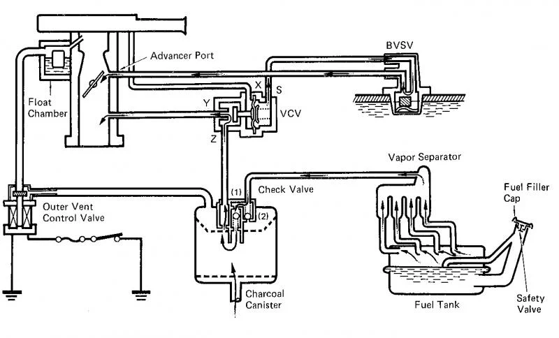

This diagram shows that line coming from float bowl, maybe I need to adjust float height?
. Going to lower gas in tank first. Wanted this to refer back too
Likely you have a piece of crud in the float needle seat, which is keeping it from closing, hence the float bowl overfilling. I posted the relevant page from the (1980) 2F Engine Repair Manual in your other thread (that I saw first). You probably won't need to adjust the float; just take it out and clean the needle and seat and float bowl. And replace your fuel filter.
The Outer Vent Control Valve upstream of the charcoal canister is supposed to allow vapors from the float bowl to waft down into the canister when the ignition key is off. When the key gets turned On, the valve closes. Or it’s supposed to.
