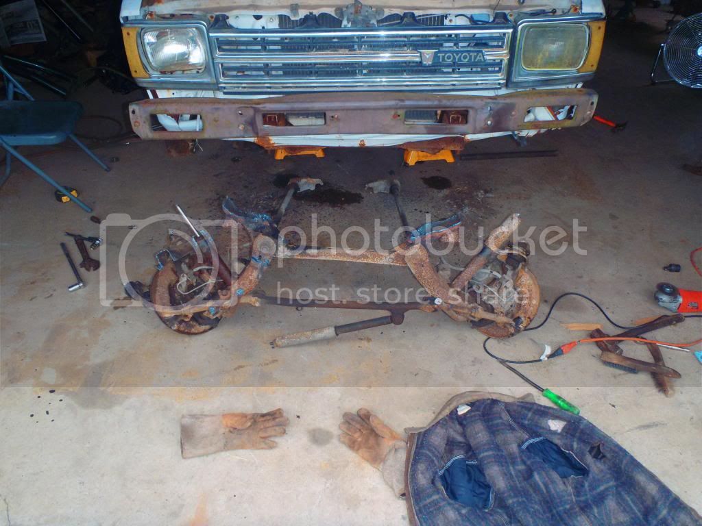

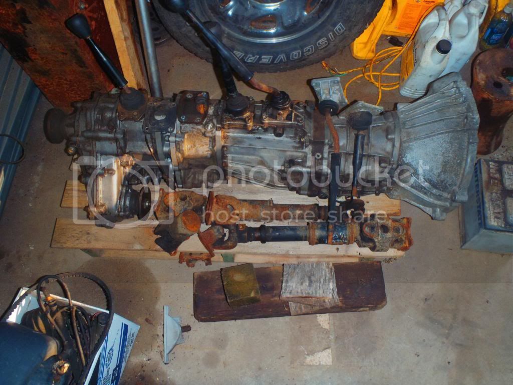

Got it in the garage to tear it down

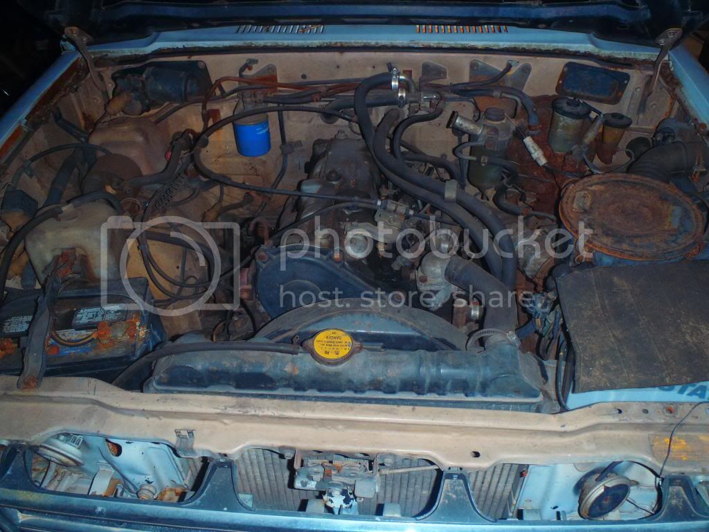

The mighty 1L in all its glory!!
So my plans are to make it 4wd with dual cases and 4.70 low range gears.I have been collecting parts for 4 years now.

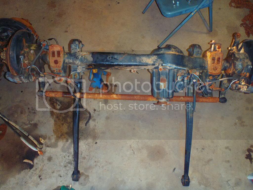

My front end is from an 80 series landcruiser.E-locker of course.I am using the radius arms for now.Maybe one day I will link the front

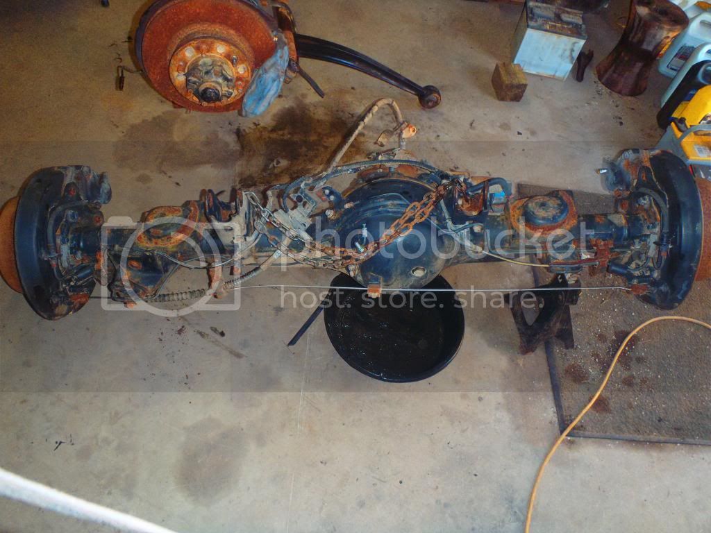

Rear end from the same 80.I am making my rear suspension setup like an 80

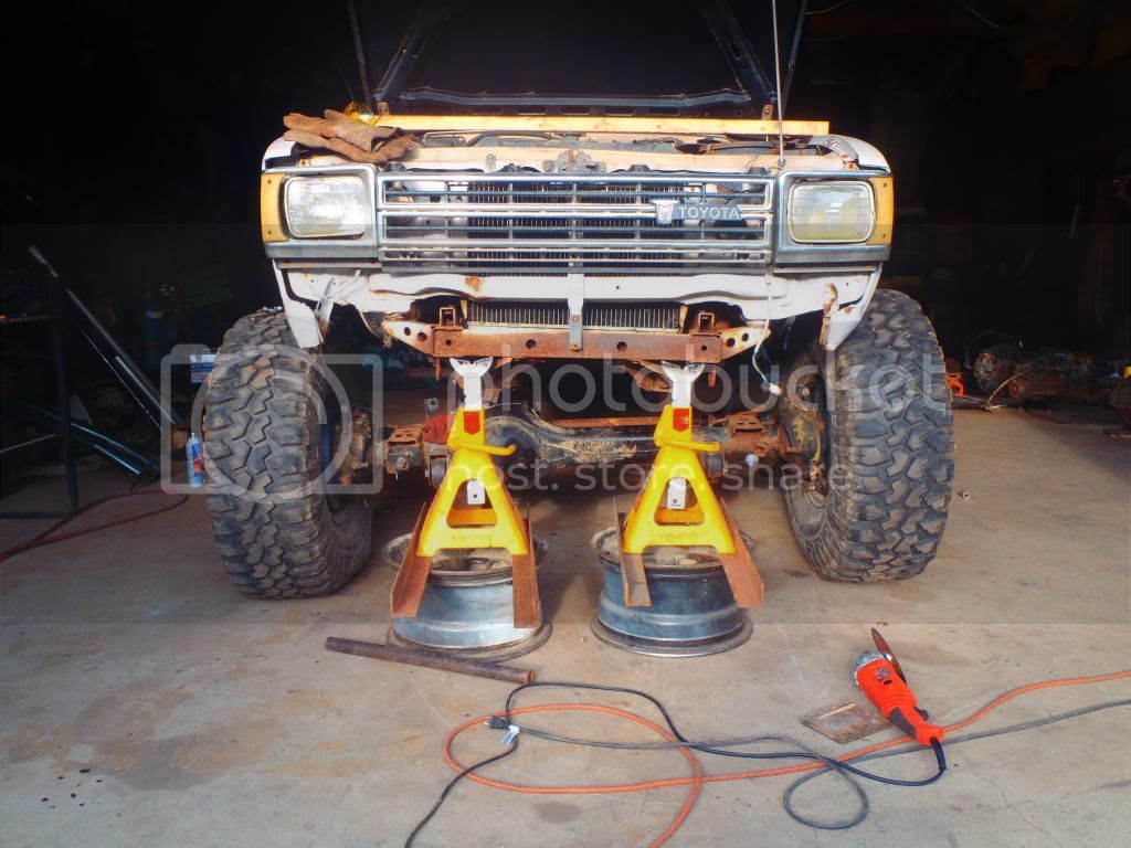

Getting the front end mocked up
Got a tough stance going on here

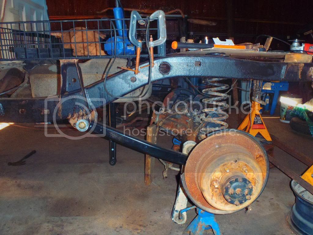

Put some rust converter on the frame.Stuff works wonders.Just wire wheeled it and brushed it on.Also the pic shows how I'm thinking of setting up the rear end

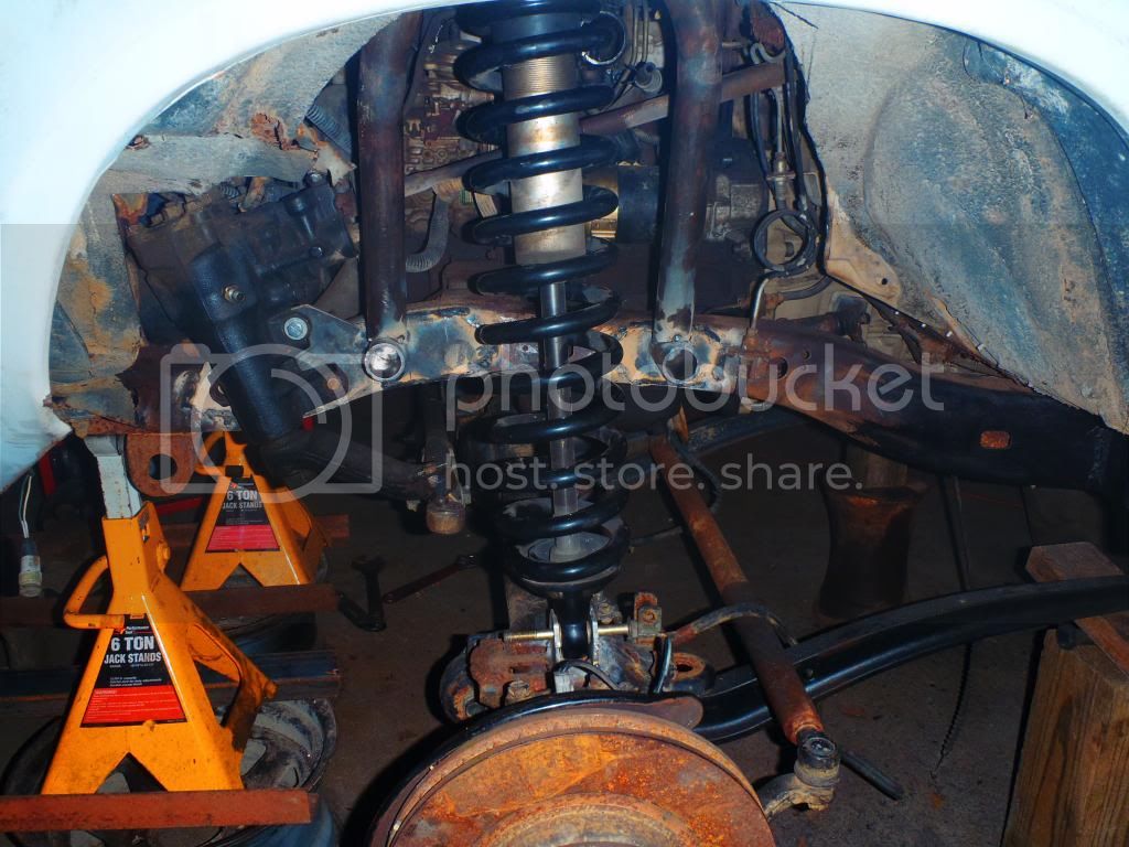

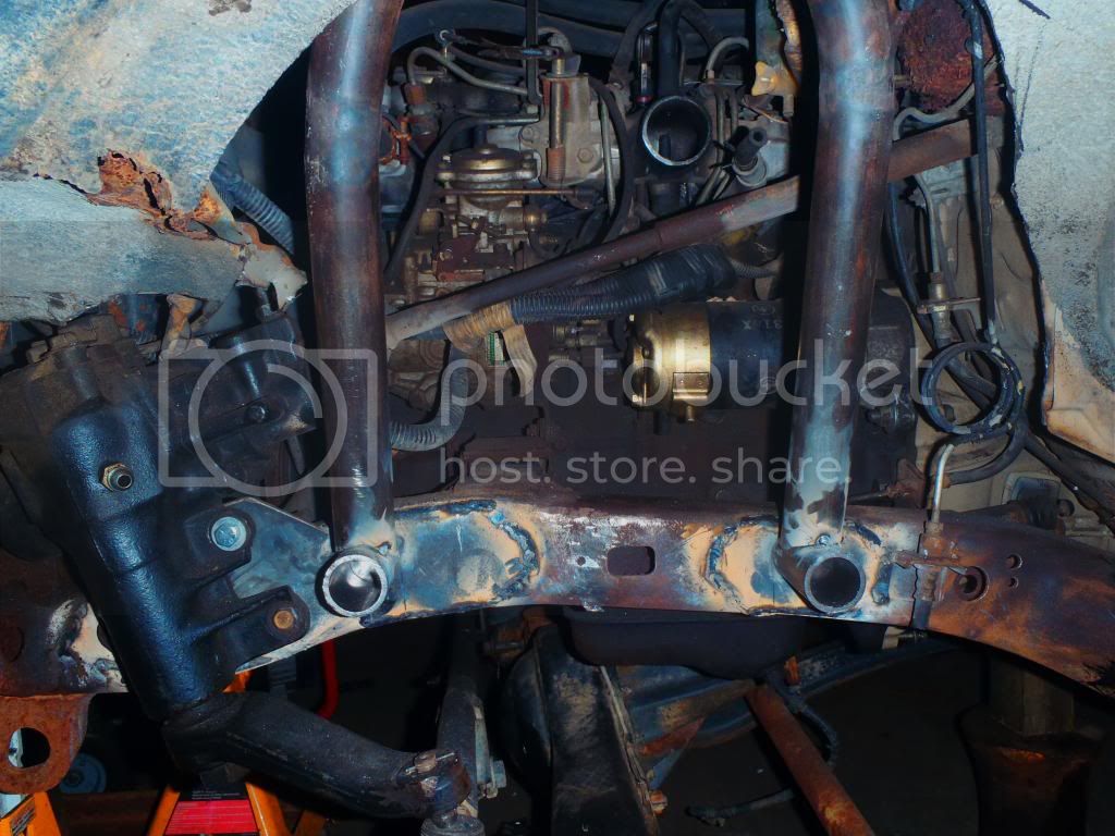

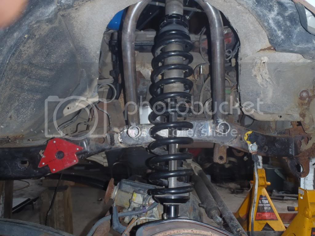

Alot going on in this one.Got the IFS steering box on there,it is tapped for hydro assist.Frame plated.And final position of my shock hoops.Still got to burn em in there.My first time notching tube after lots of trial and error it turned out ok
Top of the hoop looking down.Had to clear my master cylinder and make room for the coil overs
12" Rad Flo coil overs look nice in there

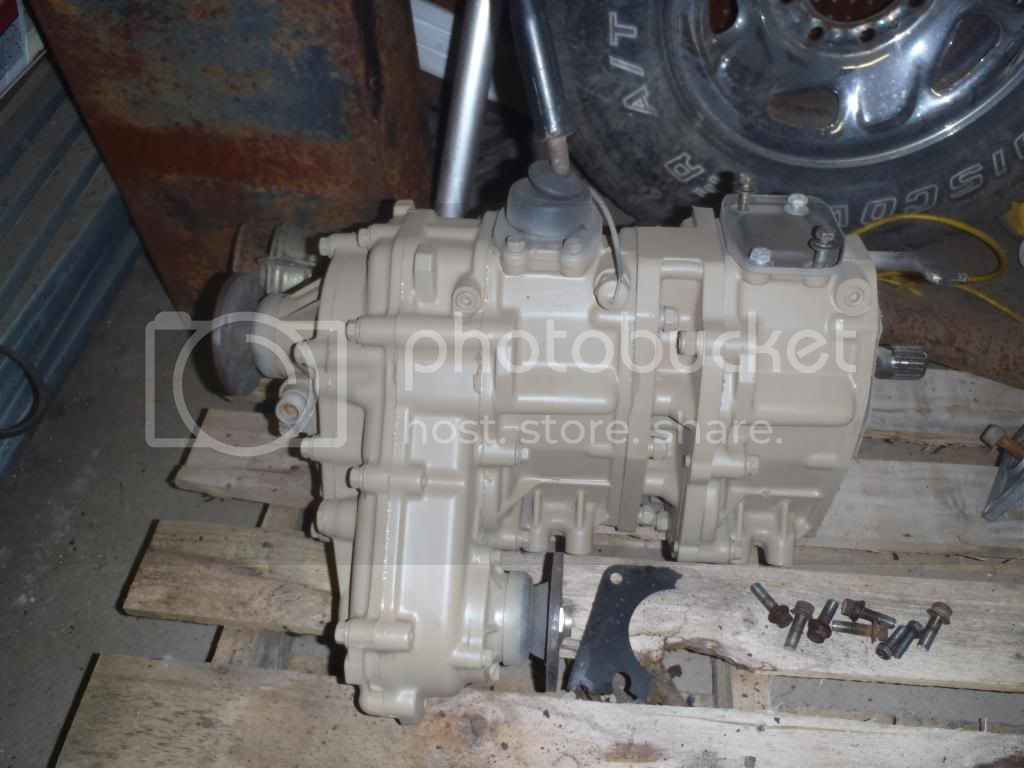

Got the transfer case painted.Went with cummins beige.Only seems fitting.Plus I like the light color should a leak occur it should be easy to see where its coming from.

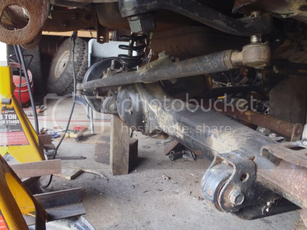

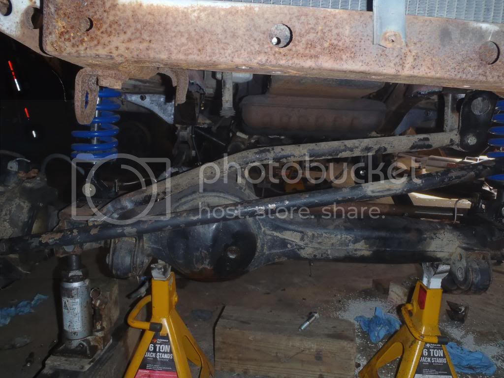

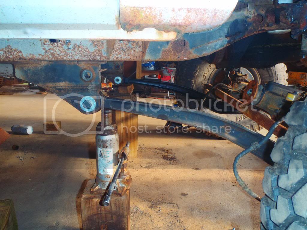

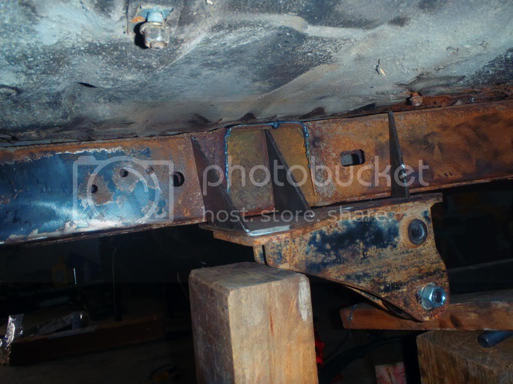

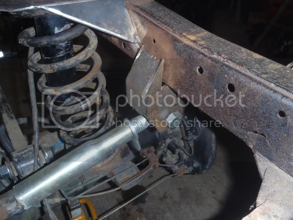

Here is how I plan on attaching the radius arms to the frame.The bracket below the frame is for a landcruiser but I believe it will work here also.Question is should I box it in or will this be strong enough
cool project, looks like you're keeping the 80 steering setup as well. What's the plan for connecting the IFS steering box/pitman arm to the 80 steering linkage?

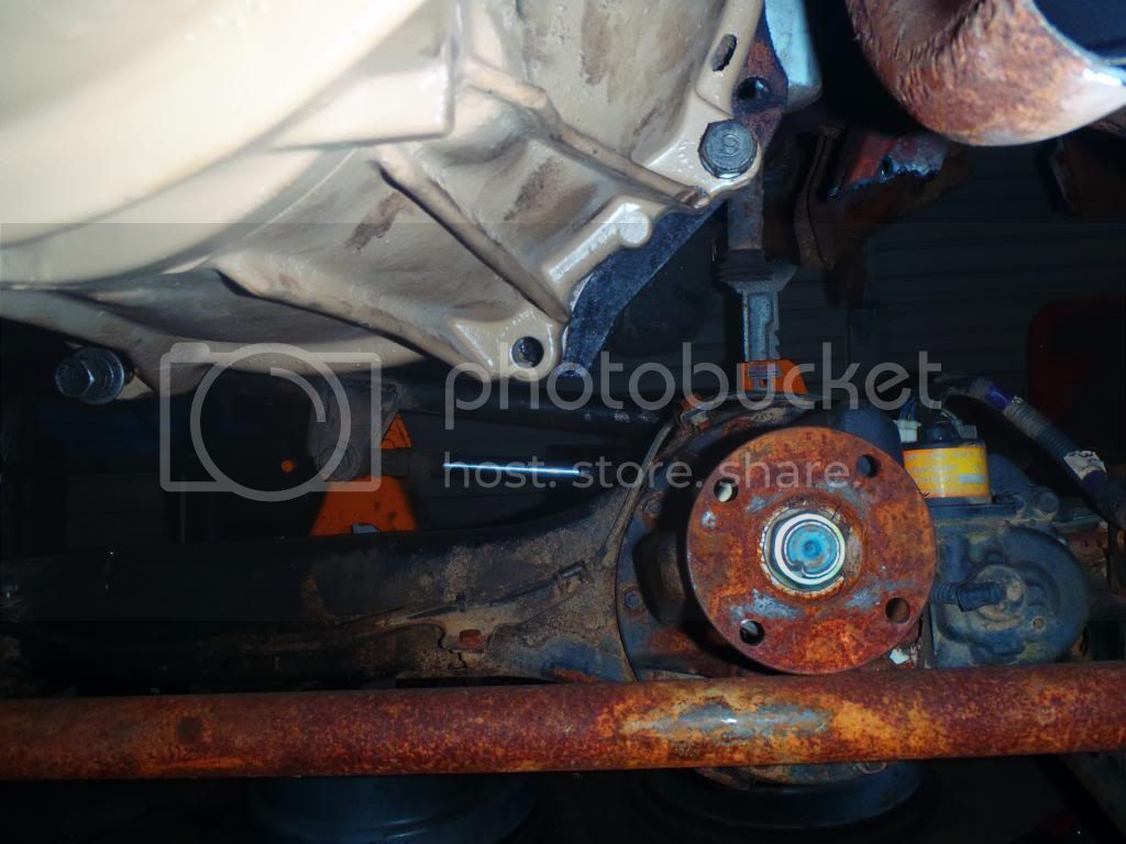

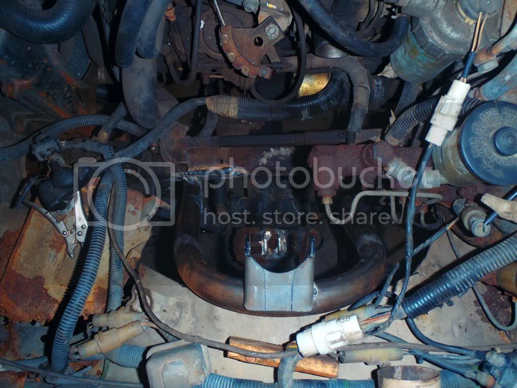

Probably my biggest issue so far is the oil pan and front diff clearance.I think I can notch it though.

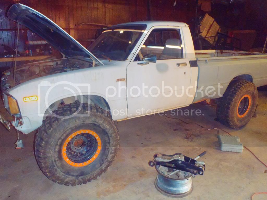

That is where I am as of today.I only get to work on it 1-2hrs a day.I got a full time job and a little boy and a wife so family takes priority over everything and with winter right around the corner I got to spend my evenings cutting fire wood for awhile.I will leave yall with another poser shot.I traded the 35's for 38's

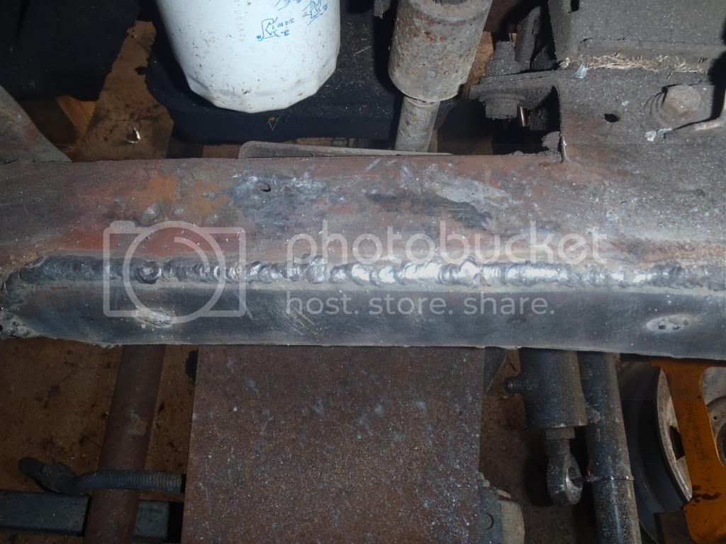

Plating the frame for the coilover mounts.Crappy weld pics
Rad flo resting in there

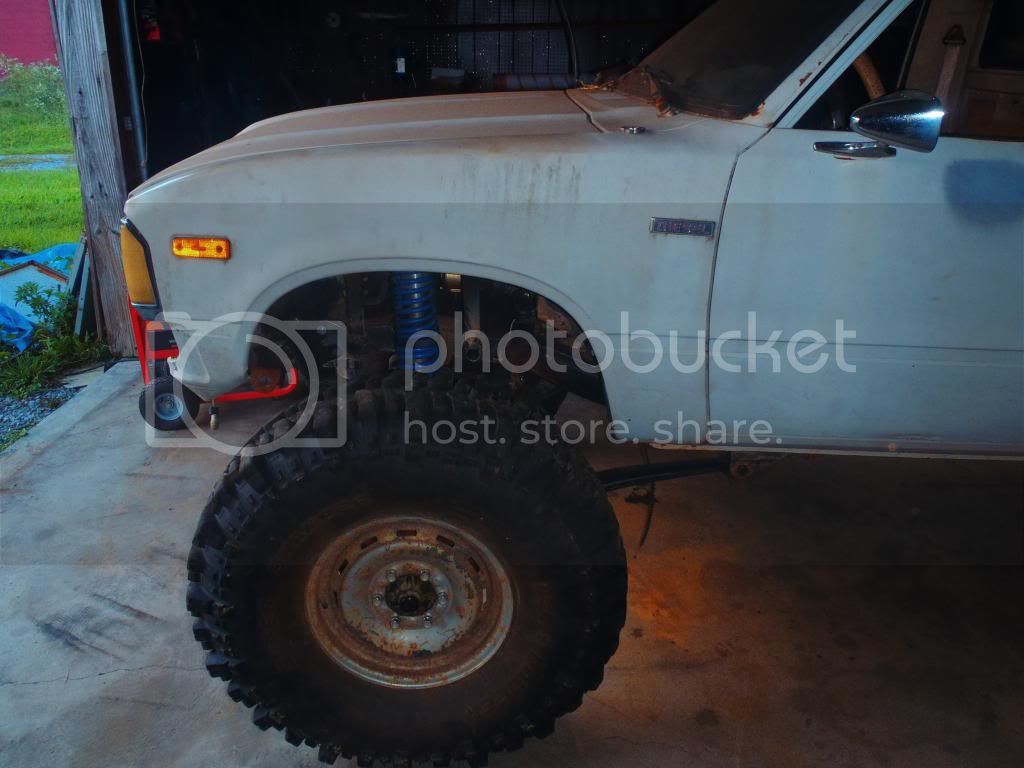

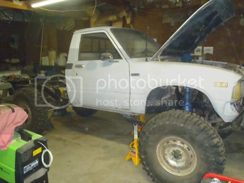

Things are going slow but I did manage to get some suitable springs for my coil over setup.Got the front end mostly burned in and tires bolted on.Truck setting on its own weight with 38 boggers
I like the stance. This is going to be a sweet rig when your down.

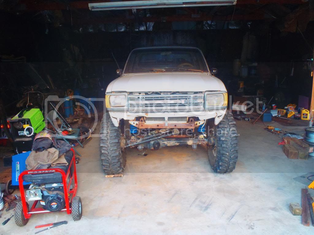

A little update

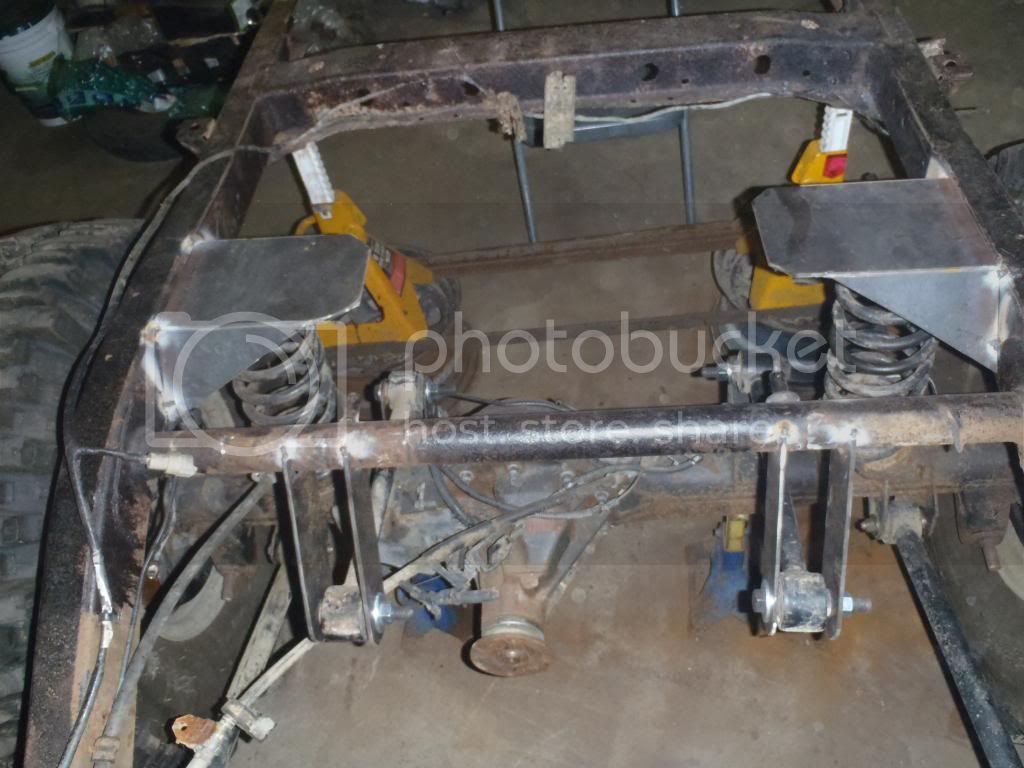

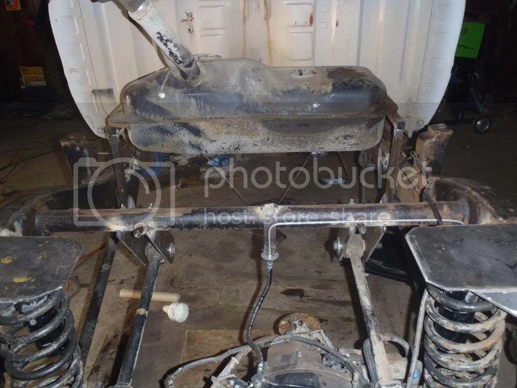

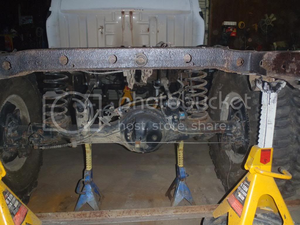

Got the rear mocked up
Everything is just tacked in place for now.checking for binding and any clearance issues
Still have to cut off the leaf spring mounts

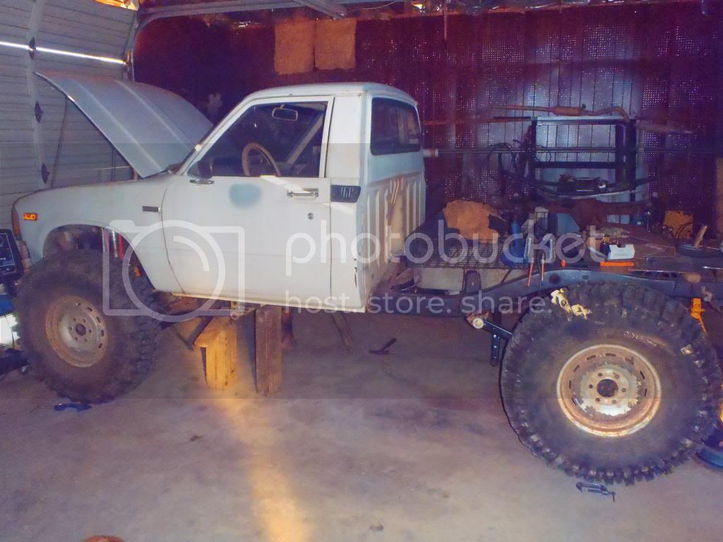

down on all fours
Probably have to swap out for some lighter springs up front but I will mount the bumper first and double check

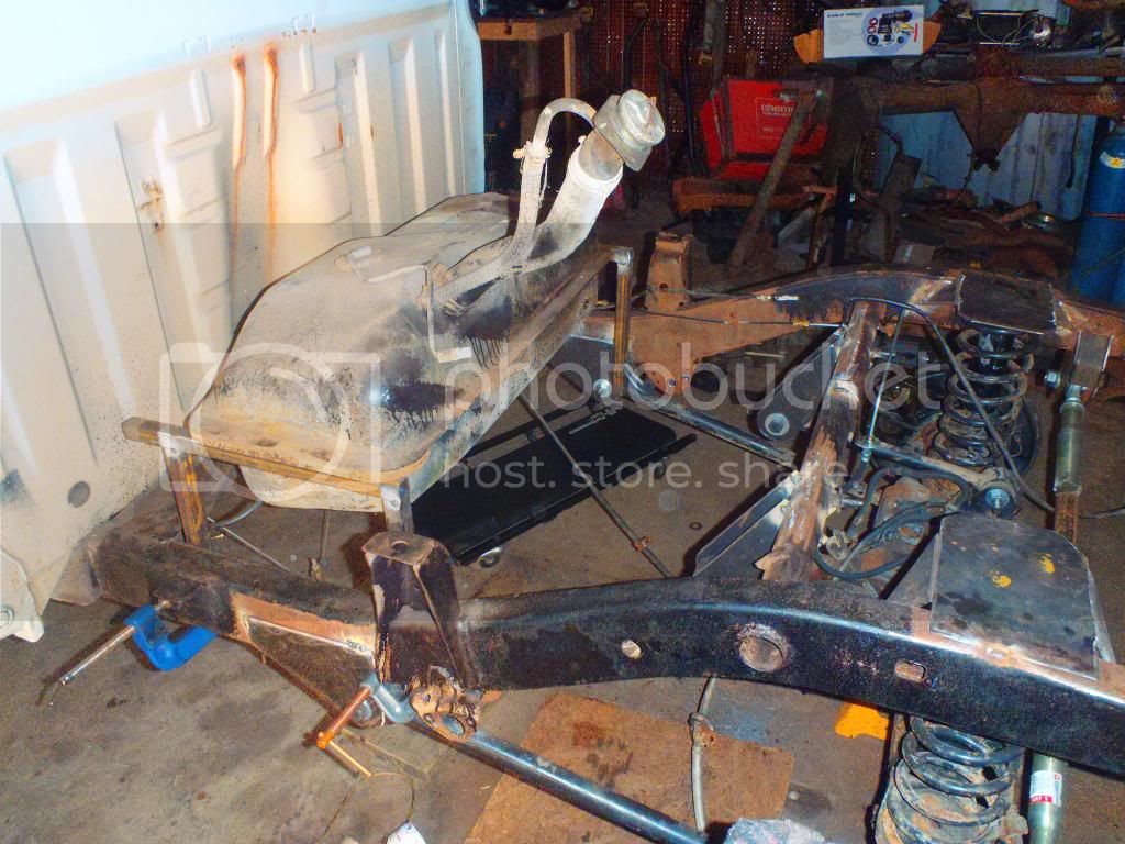

Positioning the fuel tank.Probably go lower once I get the rear drive shaft made and installed,check for clearance.
Bracket for the rear track bar,turned out well
