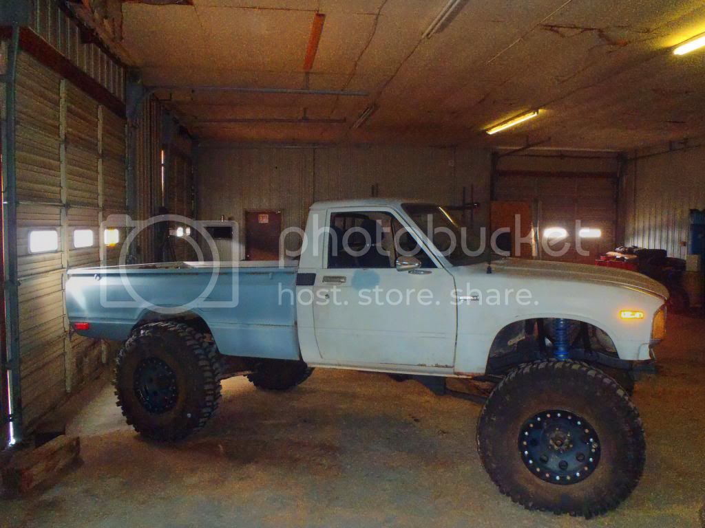

81 Toyota Diesel 2wd becoming 4x4 with landcruiser axles and dual t-case

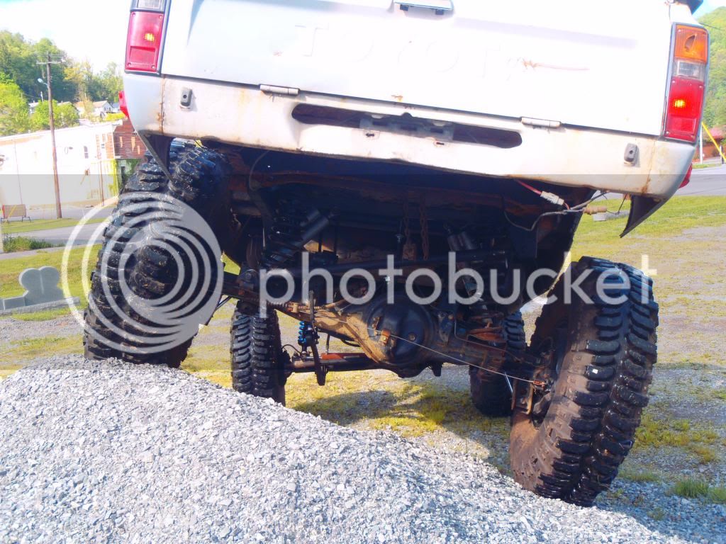

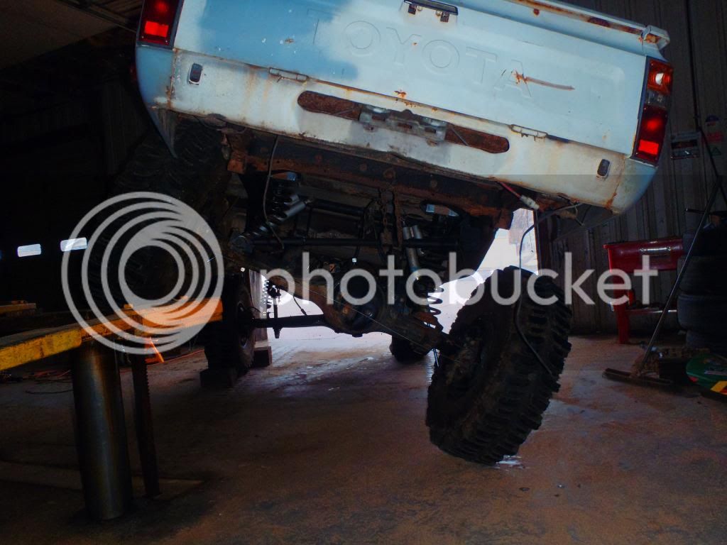

Man good project. One concern from the pics I see is on the rear where the upper link mounts are. That looks like a lot of leverage on that frame tube. Those tubes aren't very thick-just trying to help look for weak links man.
Thanks for the constructive criticism.I hadn't given that much thought.Wonder if putting a tube through that one would make it much better.Or if making a gusset or some sort of brace off the frame would be better.But you got me thinking.Don't want that to fail on the trail.

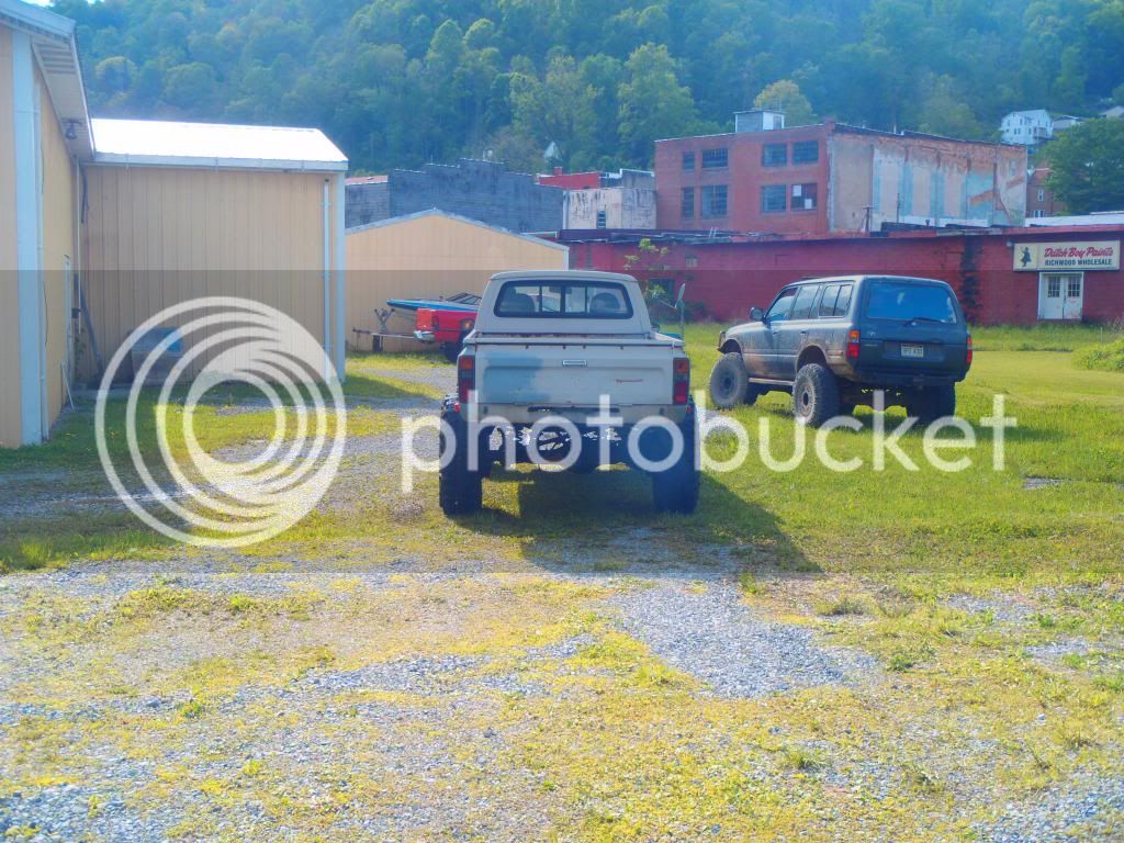

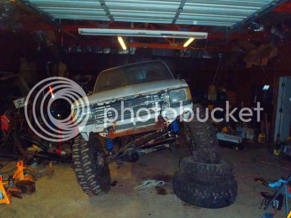

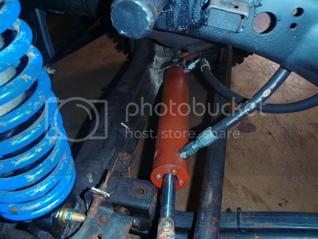

Got alot done this weekend.Fuel tank plumbed and mounted also got the power steering setup.Didn't get the hydro assist done.Back to the drawing board there.I couldnt get the 10" ram mounted so I guess I will have to settle with an 8" ram.But the good news is after setting for as long as it has plus having the entire fuel system removed it started up quite easily,even though is was a bit cold and the battery was tired.They don't make em like this anymore!!The 4.70 gears and dual cases make for some serious gearing.Just playing around and pulled it on some tires.
Great build! I love the super skinny tall tires. It looks almost natural on them. I have a 1KZ-te in 87' SAS 4runner. I am planning to use the FJ-80 axles also. Can't wait to here how it does on the trail.

Its close to being driveable and enjoyable but will never really be "done".I don't know what GSMRT is?The ram is basically just to large to fit behind the axle.I fooled around with trying to mount it off the frame to the tie rod up front(not ideal I know)but it just didn't jive.

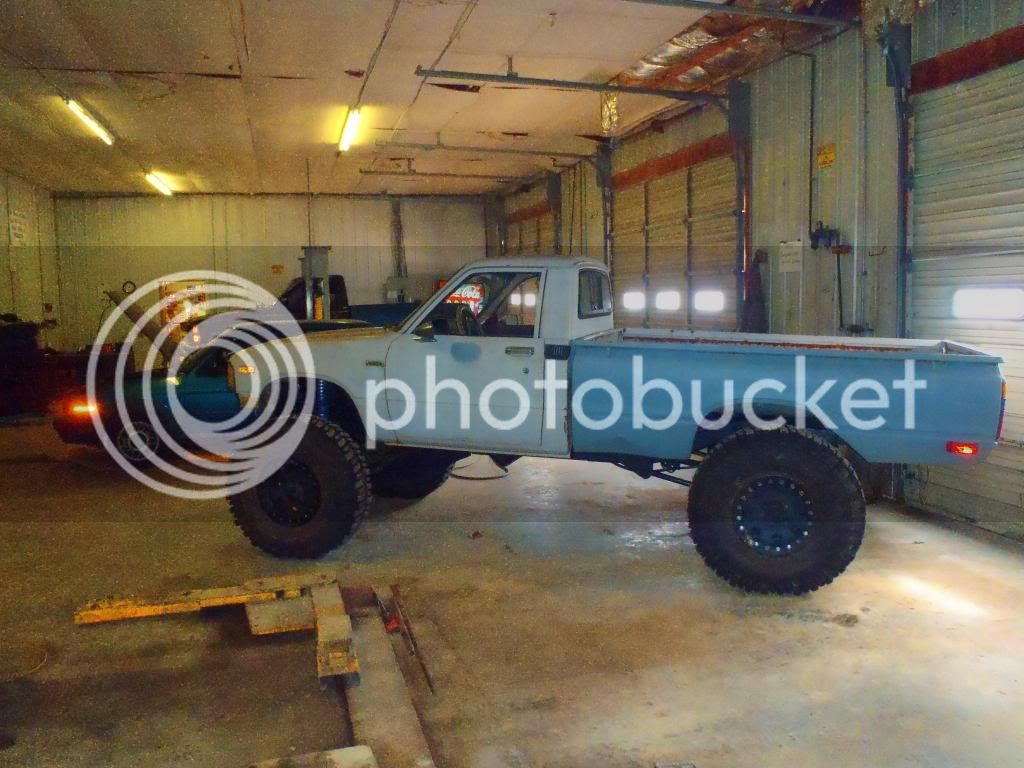

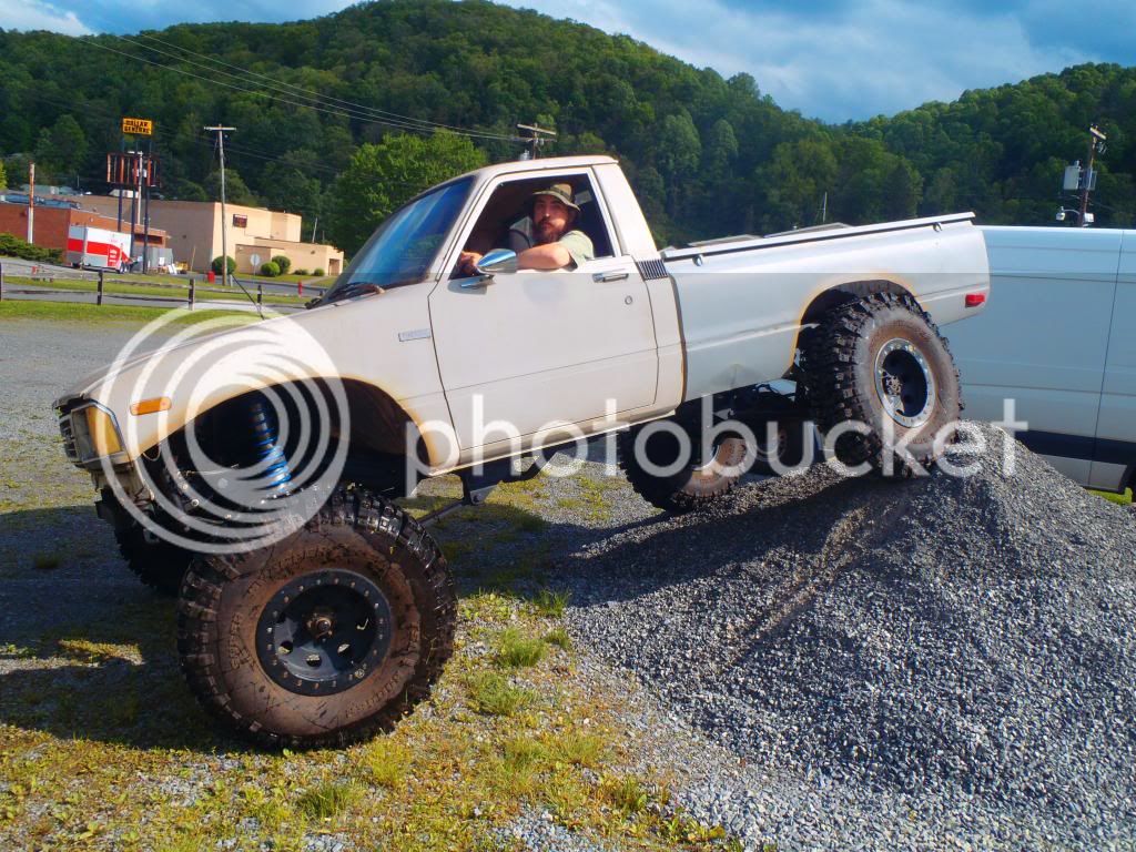

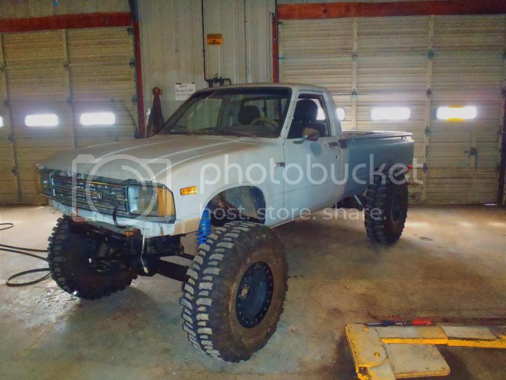

Set the bed on
Got a lot of trimming to do. Pre-runner stance going on. Gonna have to bring the nose down an inch and the rear up an inch or two.

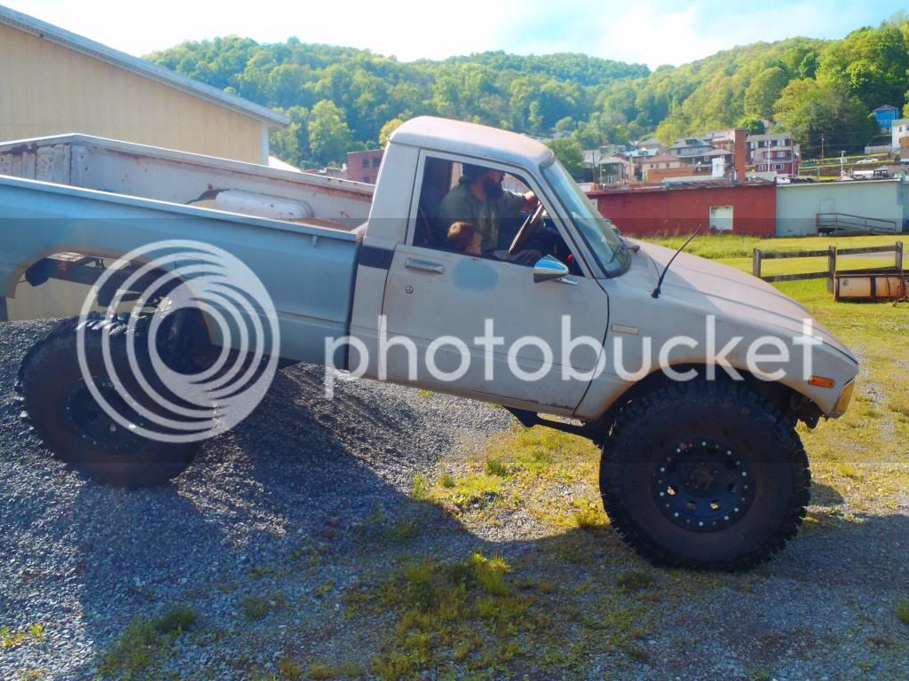

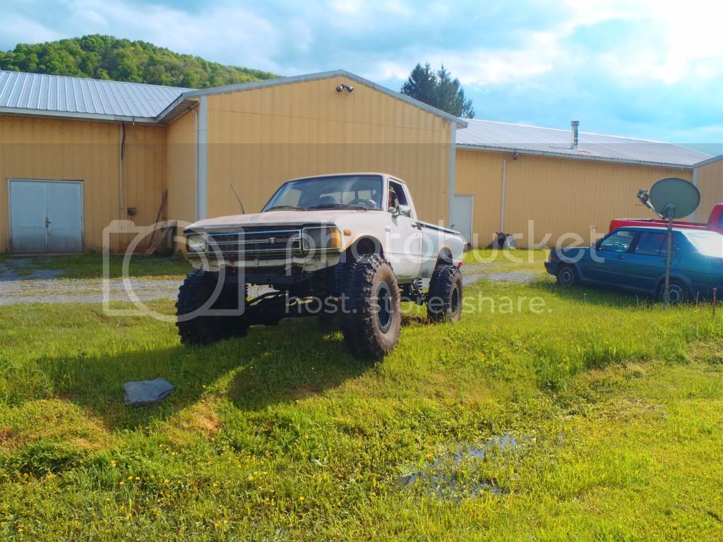

Can't wait to wheel this beast.Not much left to do.Gotta swap out some stiff coil springs for lighter weighted ones up front.Fix a damn stuck caliper and hook up my ebrake.Then its time for the maiden voyage.I will post plenty of pics

Got the hydro assist ram mounted,plumed and working.It's nice to be able to turn the wheels while stopped!Although its not the best setup it seems to work

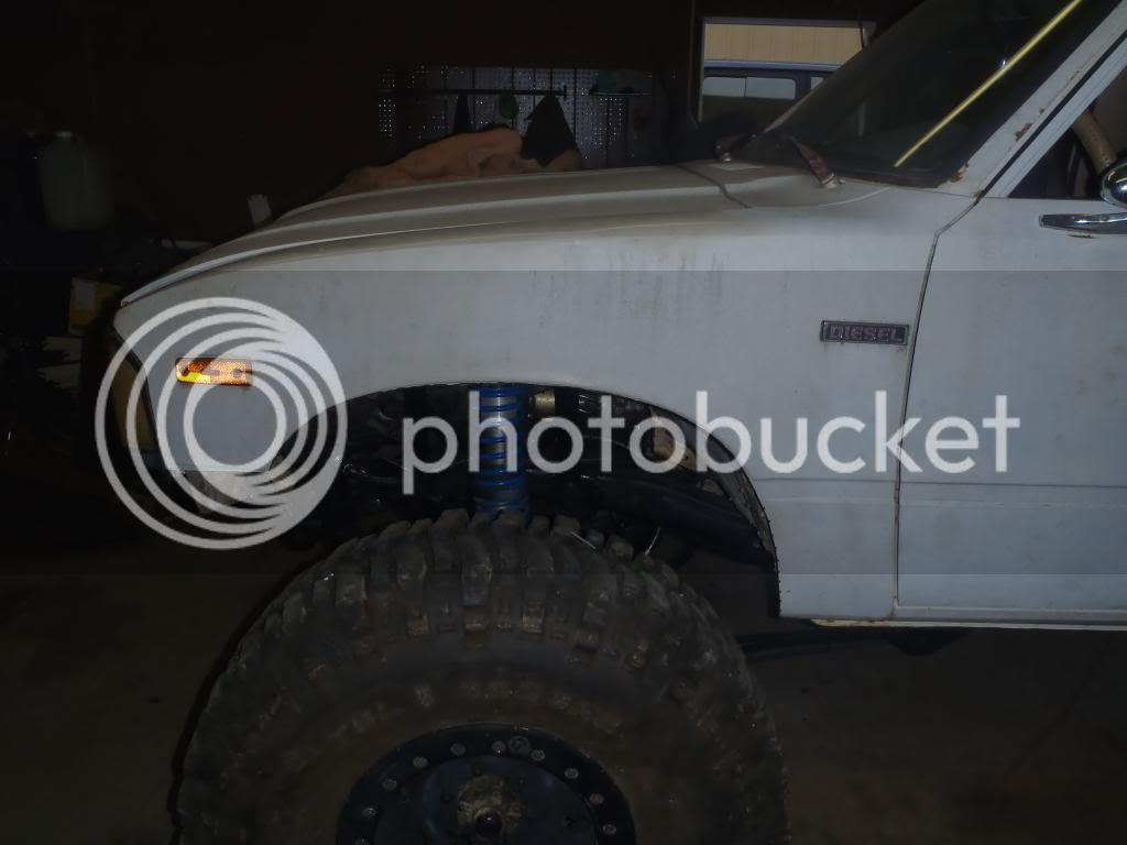

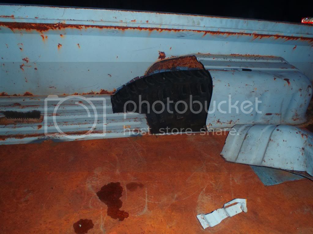

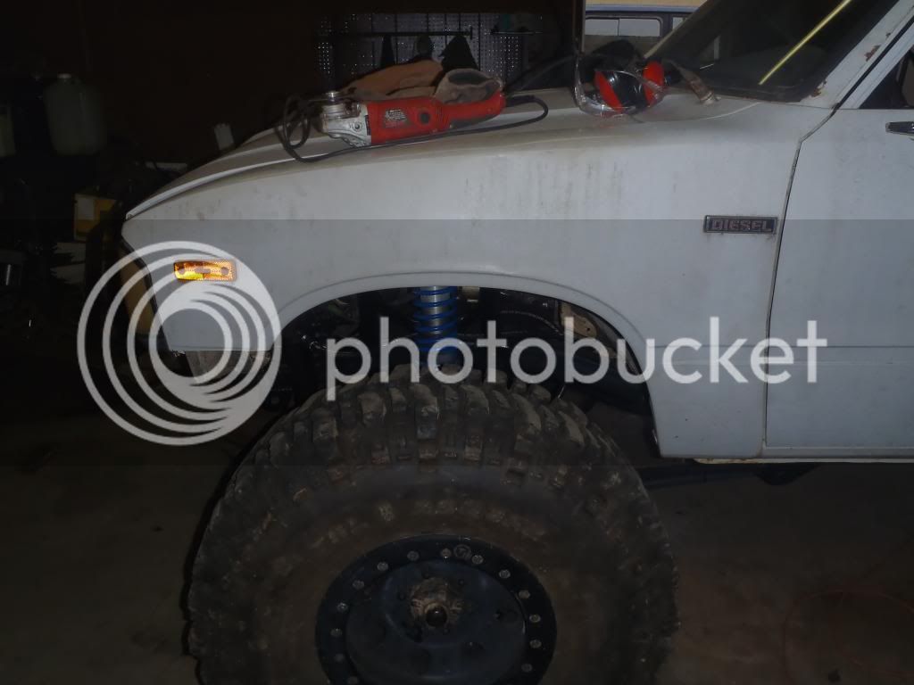

Trimmed the front fenders before
after

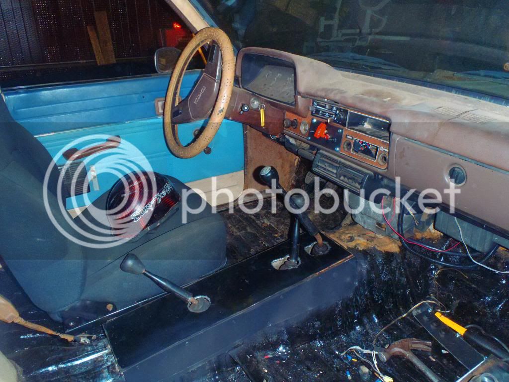

Work in the cab.keeping it simple

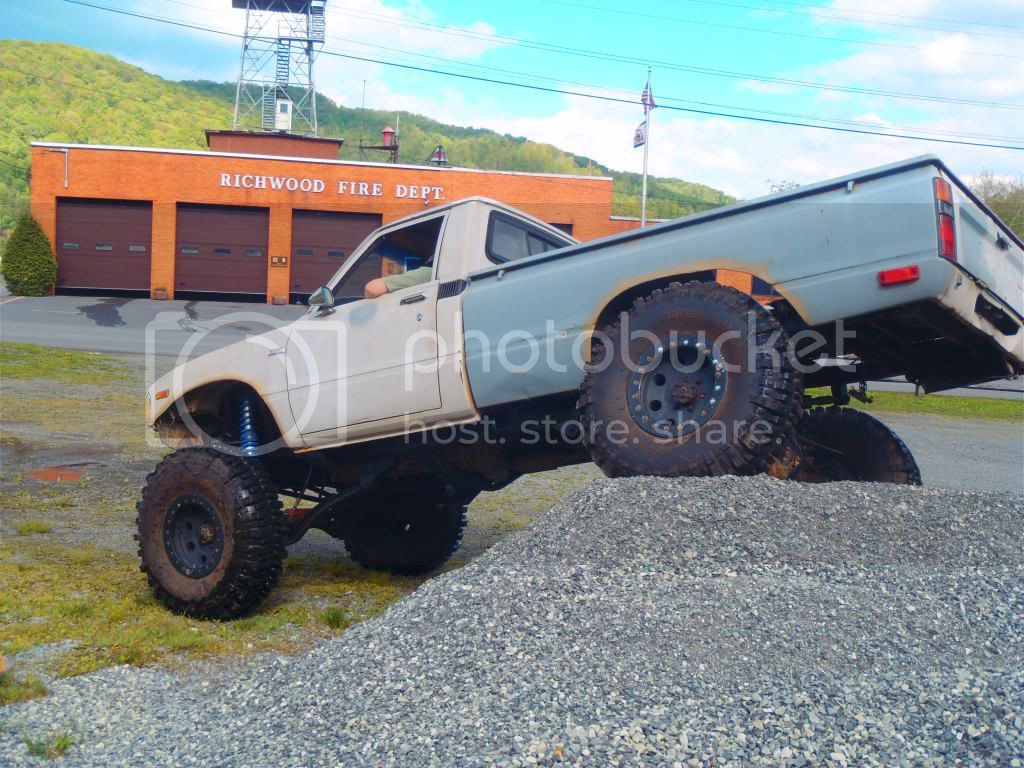

Got some softer spring rates up front,brought it down a little so I had to trim the fenders more.

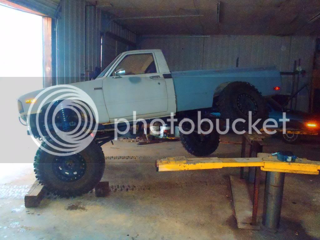

Measuring for bump stops and limit straps
Front is able to flex a bit more now with the new springs and I am able to turn lock to lock even with all the weight on the nose thanks to the hydro assist
Rear is decent also
Overall I'm pretty happy with it.Need to load up for a shake down run!!
