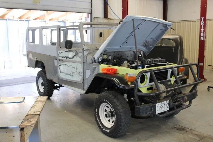

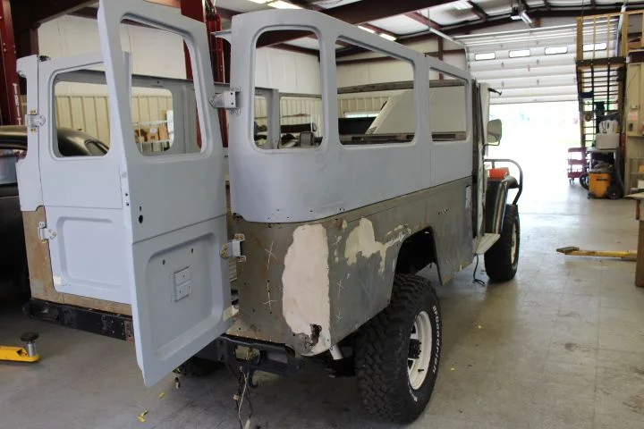

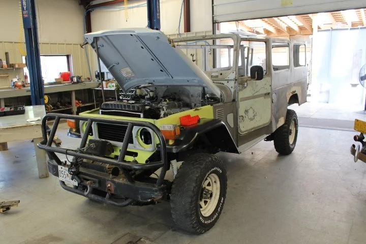

Is there anyone who knows about any side window panels and a roof for sale? Im restoring a Troopy and the panels are toast. Sadly so is the rest of the body but im buying an aluminum tub and ive already got new fenders, bib, aprons, and doors.
This is the project.

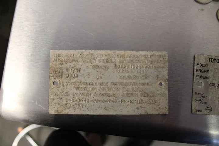

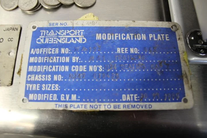

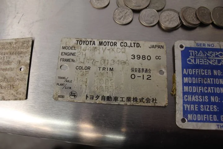

These are the ID plates that came with it but im not sure they are correct. The Australian ID certification plate says 81 but the transport department of queensland plate says 89 AND its registered as an 85. Its a little confusing.
The plate that is in the center of the 3 is the one that comes original on the HJ (Toyota Motor Co.) from Japan..
Your troopy is a 1981 production vehicle.
Some countries don't look at the production date when registering a car, they look at the year the vehicle entered the country, for example your HJ got imported into Australia in 1985 so the government put a plate stating that this car is a 1985 car..
you will need pre 1984 parts..
ToyoDIY.com.. go here and put in your vin number..
Good Luck..
Just to clarify a bit further. Your truck is a 1981 model. I doubt it sat in Japan for four years and was shipped once the HJ75 was released in December 1984. How did you arrive at 1985? Was it the rego sticker on the windscreen? Also, disregard that blue plate. That's a modification plate for a tow bar! Because we Aussies live in a nanny state. The date on that is the date the vehicle was modified ie. 1989.
Good Luck..
