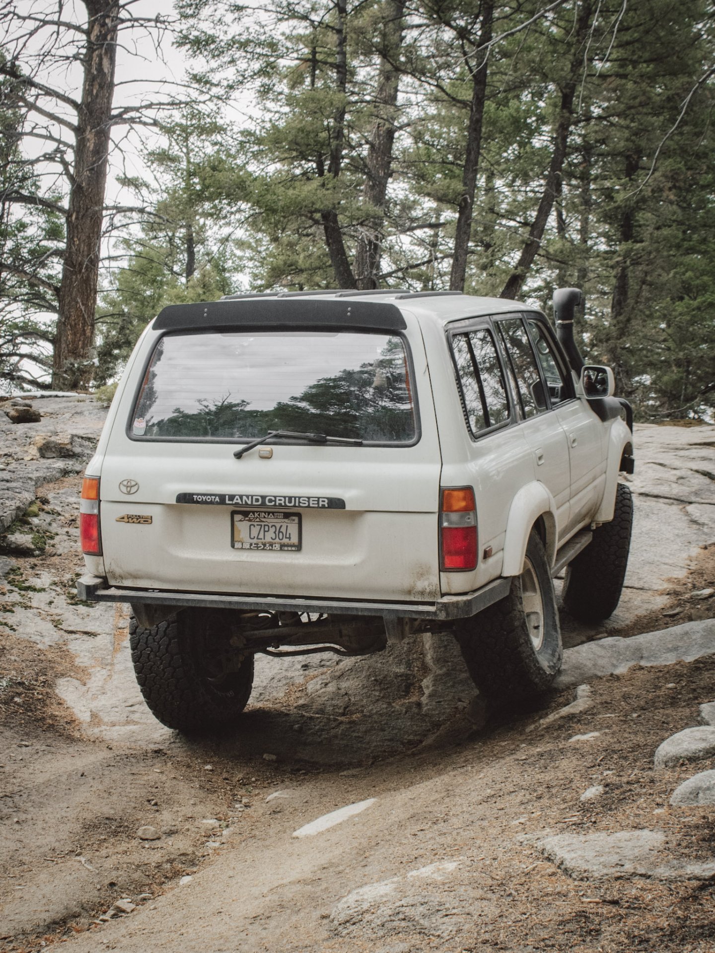

I have not seen any plans but there are plenty of examples of home made bumpers and sliders to look at. I built my rear bumper and sliders from scratch. I'd be happy to help you with measurements and the like if you are interested in what I did. Pictures in the link in my signature.

Front bumper is here:
First time I built the rear is here:
Additions to the rear and the sliders are here (they are kinda spread throughout the thread):

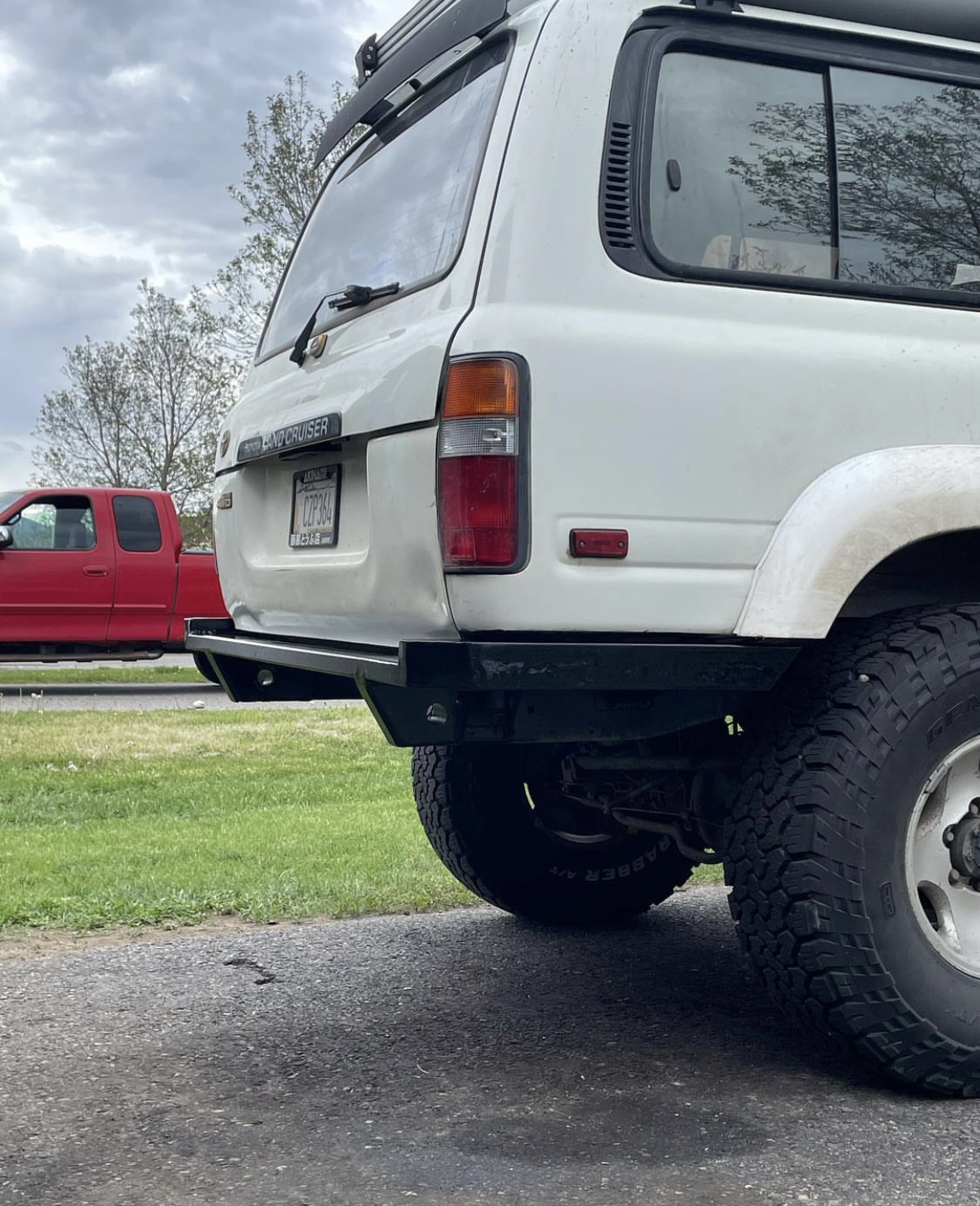

I don’t exactly have any measurements for it but a high clearance rear bumper for 80s is pretty easy. I just did the rear quarter chop, and built the whole bumper out of 1.5”x 3” stock. I cut a hole in each side of the frame, shoved a piece of DOM in it, and did 1/4” sandwich plates for the recovery points. It’s a pretty simple and effective bumper.

Fun fact. I’d never seen a recovery point done like this so I asked a friend who’s an engineer at Boeing to give me an idea of how strong they would be. He calculated that they’d have a working load of about 10k lbs with a safety factor of 5. Good enough for me!

Rust make you have to chop the rockers out like that ? Mine are the same way 😆😞 lol, but I’ll post some pics of the rear bumper that I’m finally making progress on again.
No rust. Cutting/ capping that part of the body just gave me more room suck the bumper up higher.
