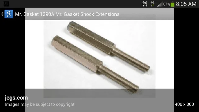

Another option is to buy, or better yet fabricate shock extensions. They can easily be made using all thread, and a coupler. Just be careful not to go to long!

Can't see shock extensions resulting in catastrophic failure if the length is correct. Shocks are not designed to be overextended, or over compressed that's why there are limiting straps, and bump stops.
If the shock length is correct the only force that the shaft will receive is from valving in which case the extenders are more than capable of absorbing.
This does not negate the fact that there are better options including custom shocks. However, I was addressing the O.P. in which the writer named a specific shock not offered in the desirable length.

There are lateral forces on the pins and by extending the pin bolt beyond the shock body increases the force against the pin, since it'd be acting as a lever.
I understand lateral forces, as well as leverage. I do not deny that with added length there would be added strain in a lateral force scenario. I would also add that the additional force implied by such a short extension with such minimal angle would be insignificant especially since there are urethane bushings to absorb lateral force at the lower mount.
Also, for what it's worth I did a quick search for shock extension failure, and didn't find a single example. This doesn't mean that it couldn't happen, but if they were at high risk off failure there wouldn't likely be so many manufacturers.

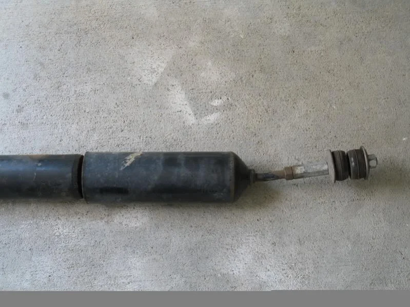

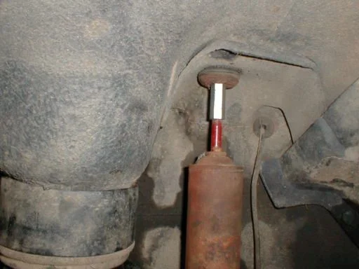

I don't care enough to continue, but for your own purposes, find a supplier for the pin bolt extender that's geared to either an off road or 3/4 ton vehicle.
It happens, which is why there's no threads on how kick ass pin bolt extenders are, on Mud.
This doesn't look safe to me, but I'm no expert.
Sure appears this could easily result.
Anyhow, not beating a dead horse any further.
Again, I'm not saying that extensions are the best option, but a viable option especially in a situation where someone has a specific shock in mind that doesn't "fit" their application.
As far as the images posted by delancy I would prefer seeing the extension at the bottom of the shock so that in the event of failure there would be less chance of hitting vitals. Also, the second delancy image testifies that the extension shown was stronger than the shock shaft which is reassuring.
Bottom line: the choice is to the individual, to determine what is best for them. All that we can do is offer information that would help them make a knowledgeable decision.
