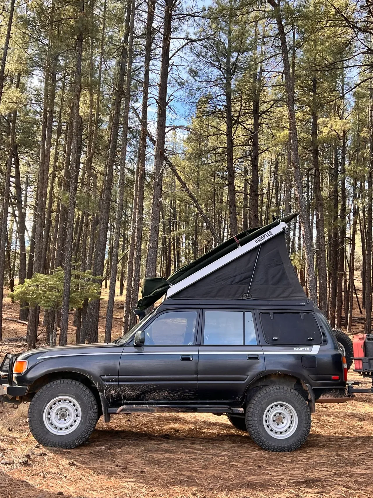

Might be time for an integrated roof top tent like a Campteq 80.
