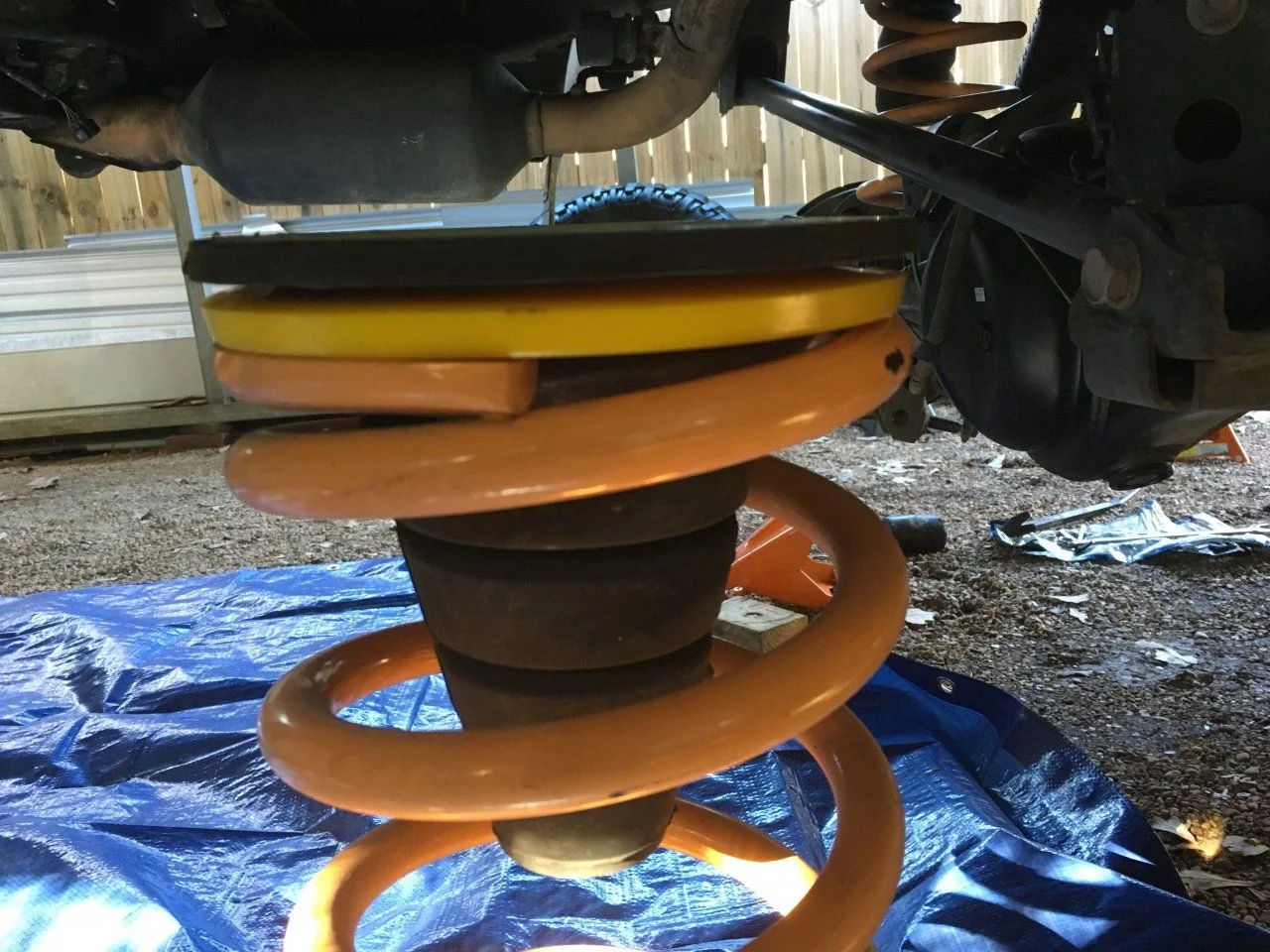

Just in case anyone was wondering, OME 80 Series Trim Packers will fit the stock spring perches.
I installed a 10mm set this morning. Took about 2 hours of time.
image-jpeg.1210735
Rear coils are coming out.

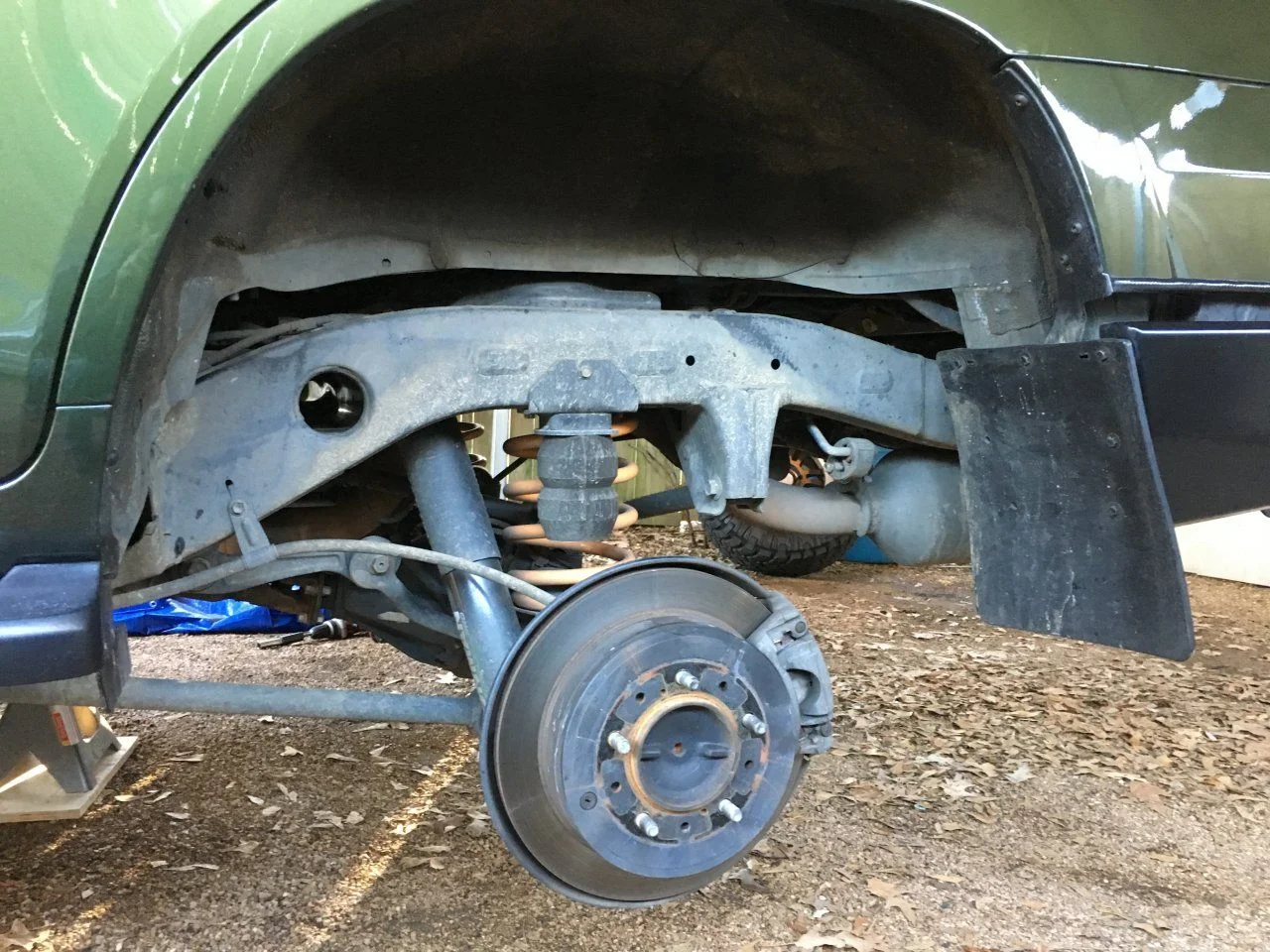

image-jpeg.1210739
OME 80 Series 10mm Trim Packers installed.
image-jpeg.1210744
Fit flush with the factory rubber perches.

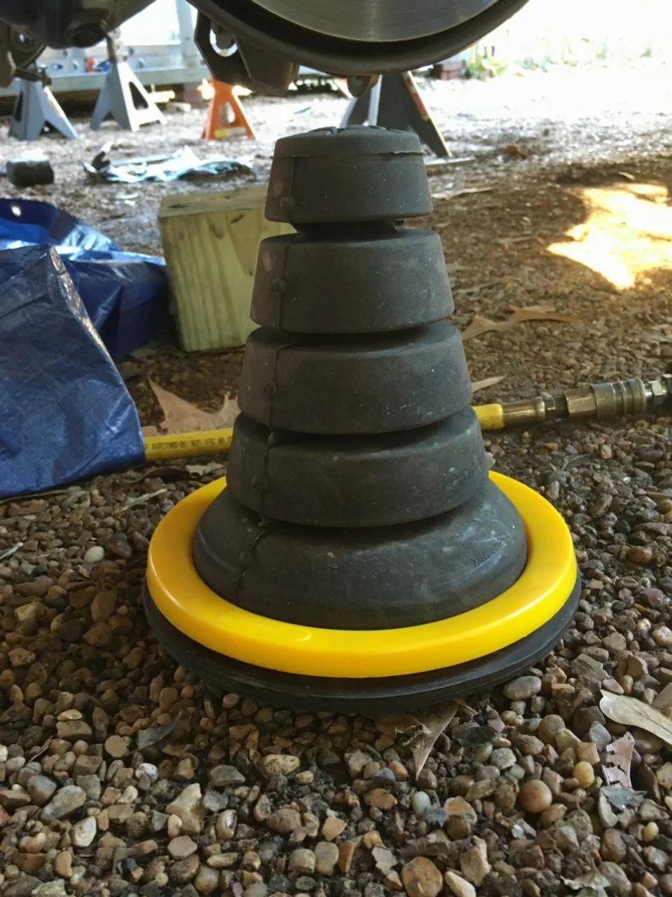

image-jpeg.1210746
Lots of space now. :)
