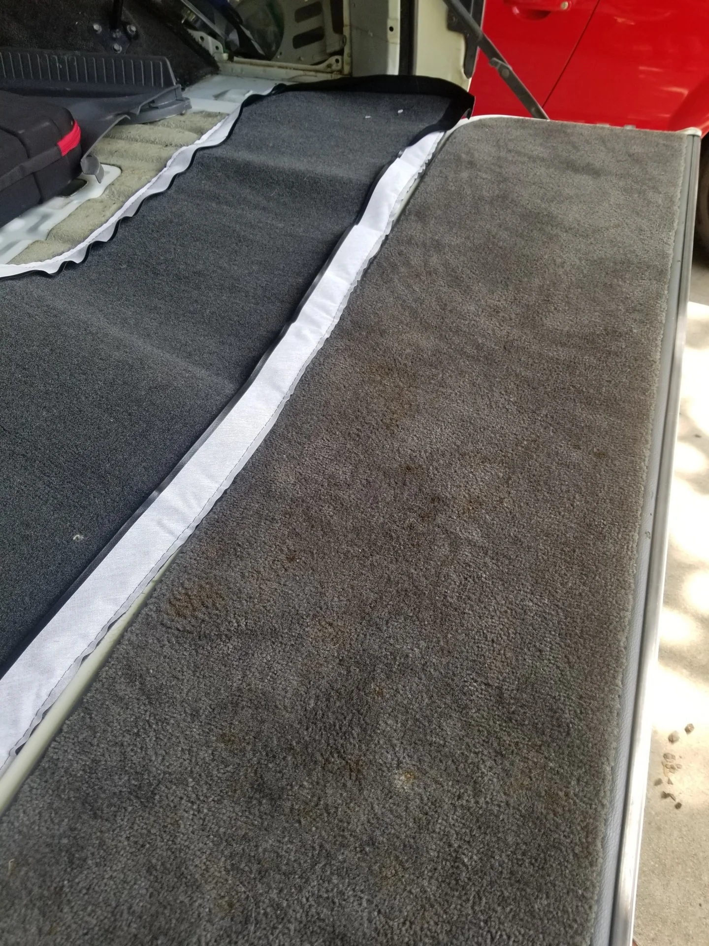

Mine just came in today - grey '94 interior. I didn't see any other pics posted on mud for this interior so this was a roll of the dice. Couldn't be more happy with the quality and match. I'll post some pics after the install in a few weeks... waiting on some electronics to come and get that sorted first.
See pics for side-by-side comparison. The first pic is the new tailgate piece next to the original section of the front carpet that was under a seat and likely never saw the sun - new piece looks a little lighter than original. The second pic is the new tailgate piece next to the old one (just in case it's not completely obvious) - new piece looks a little darker than original which I blame on fading. IMO I don't think you could come closer to matching the door card carpeting
