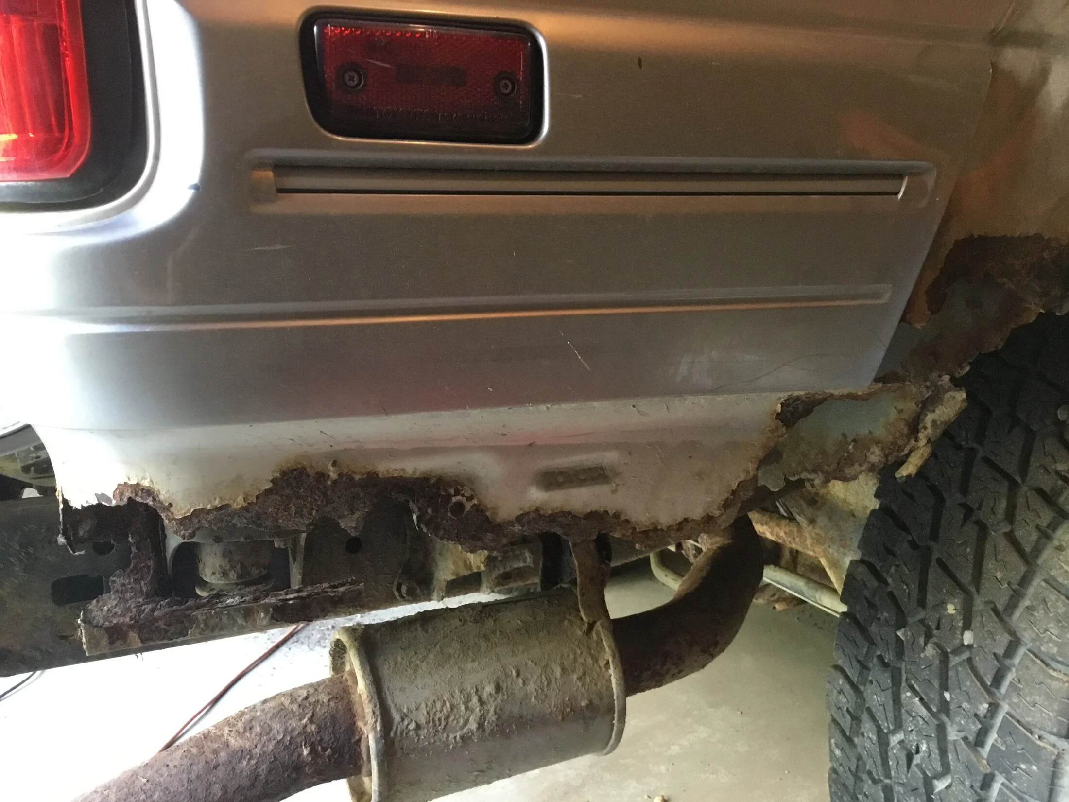

Lower rear quarter panels, including body mount.
Inner and outer rocker panels (rear end).

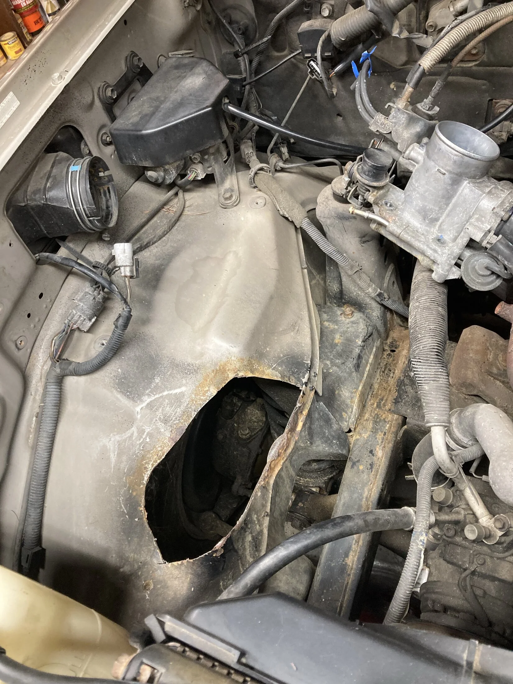

Engine bay wheel arch.

The mainly rust free 80 I picked up in Denver a couple of years ago had holes in the second row seat belt anchor locations - rusting through the wheel arch, and holes forming at the back of the passenger wheel arch. The other location where it was starting (and I think I caught it in time) was the spot on the drivers side floor where the heel of the left foot would rest just at the base of the dead pedal.

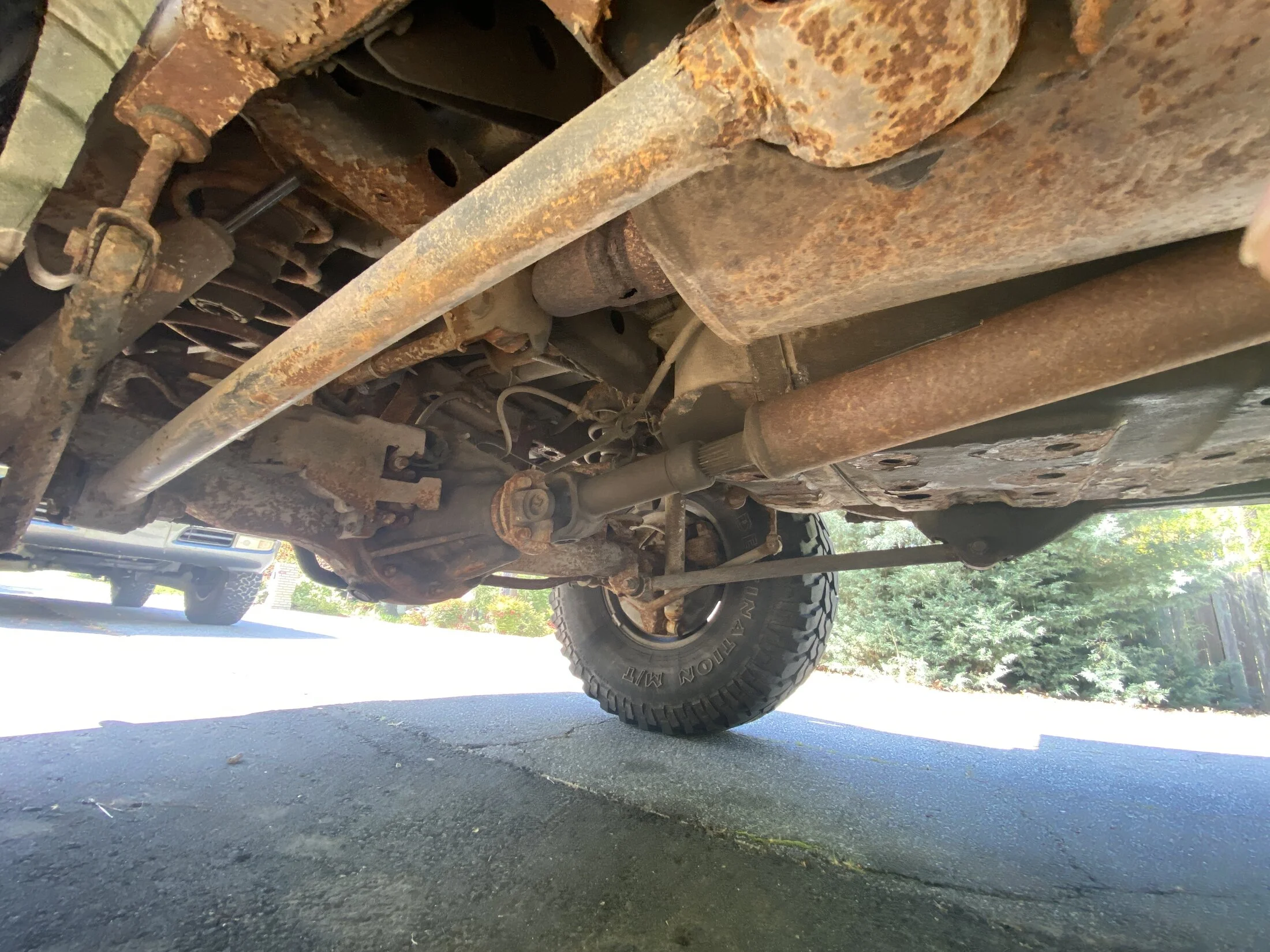

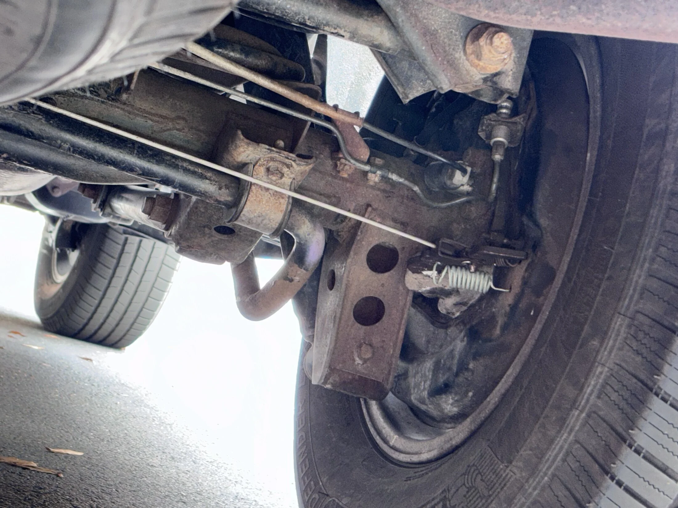

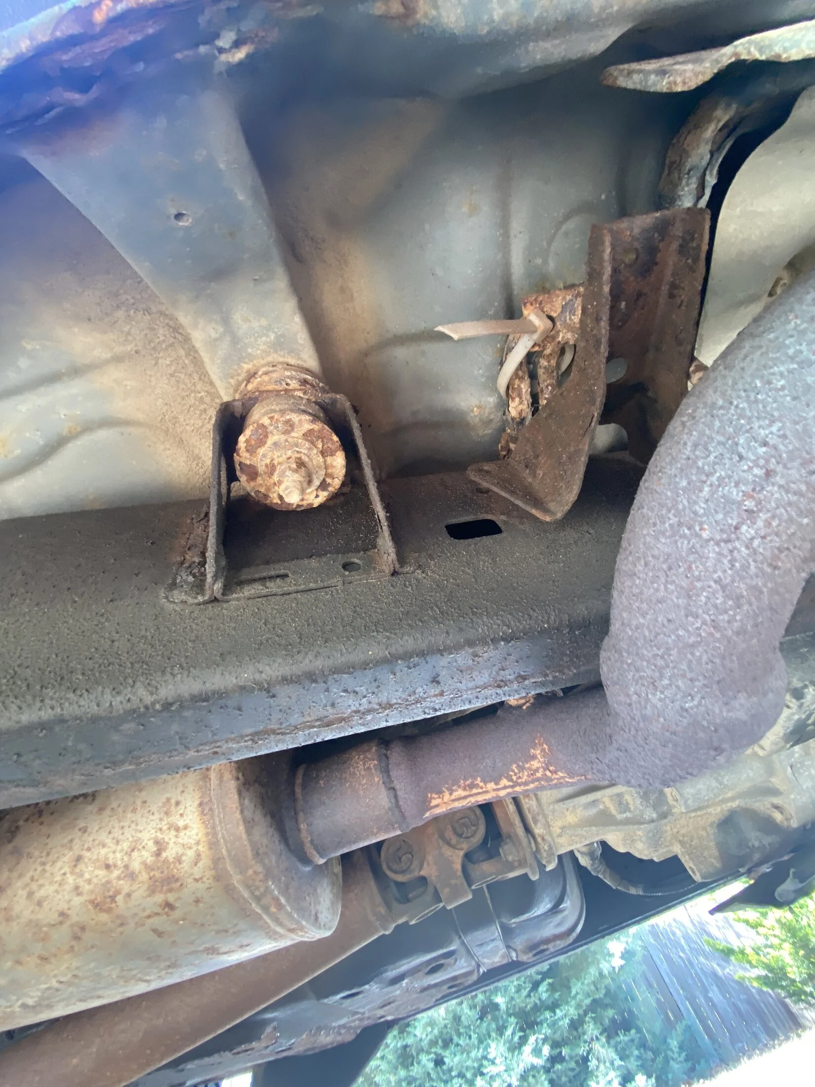

What you think of this
Not concours d'elegance quality but can be restored. Looks like there's some exhaust mount work ahead of you. Looks like someone is too cool for catalytic converters. I wonder how that 1FZ runs.
Ok, I am interested in this. I have a mostly garage stored 1994 that is being handed to my daughter from her 90 year old grandfather. In the process, it is moving to Denver where it will again live in a garage.
The other day a tech at Toyota pointed out that in the rear wheel wells much of the original coating of plasticy material is gone and he suggested I clean the area and get some Waxoyl to coat them as protection for stone chips and rust.

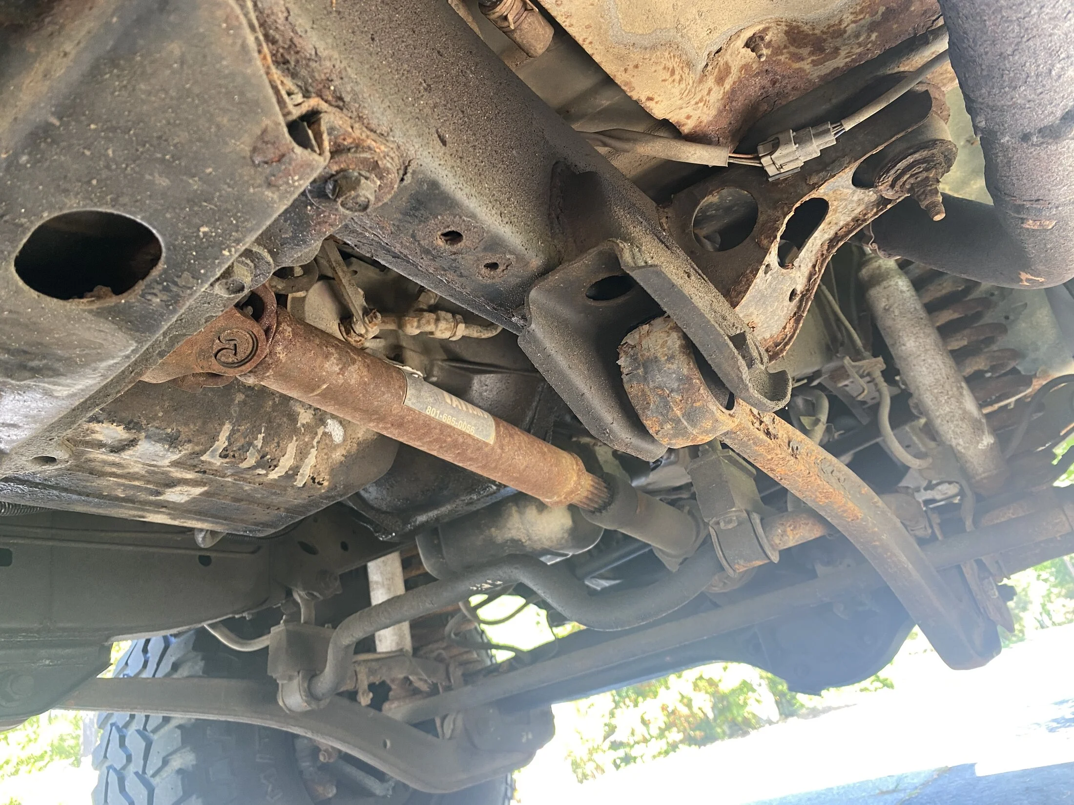

This photo is simply a generic view of the underside of the truck. No one has expressed much concern over the level of rust, but I am careful removing small bolts and start with PB Blaster.
Wouldn't hurt to treat that as long as the metal is still good. There are various products out there, wax, grease, bitumen based.

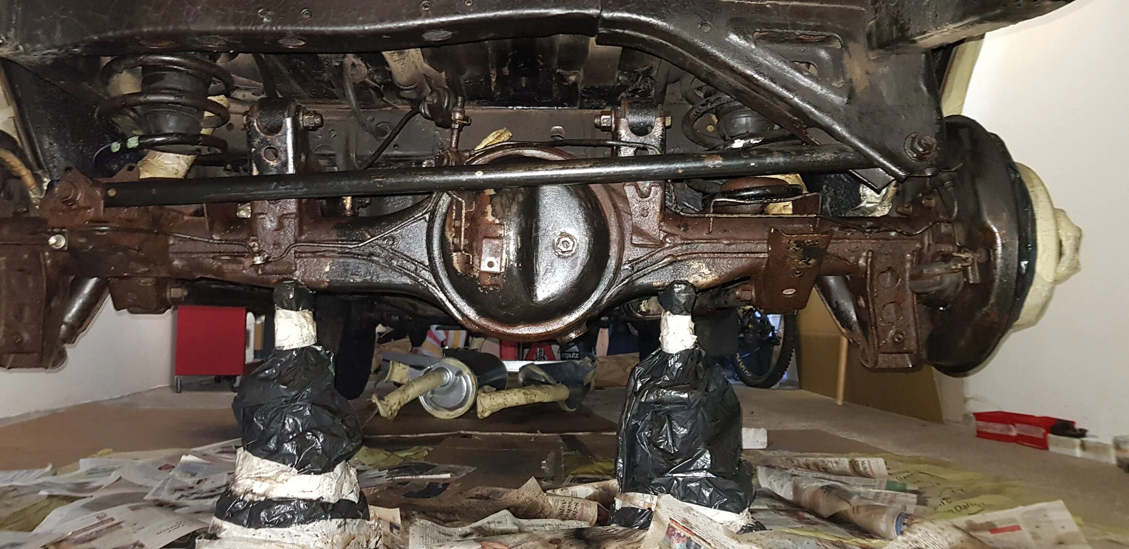

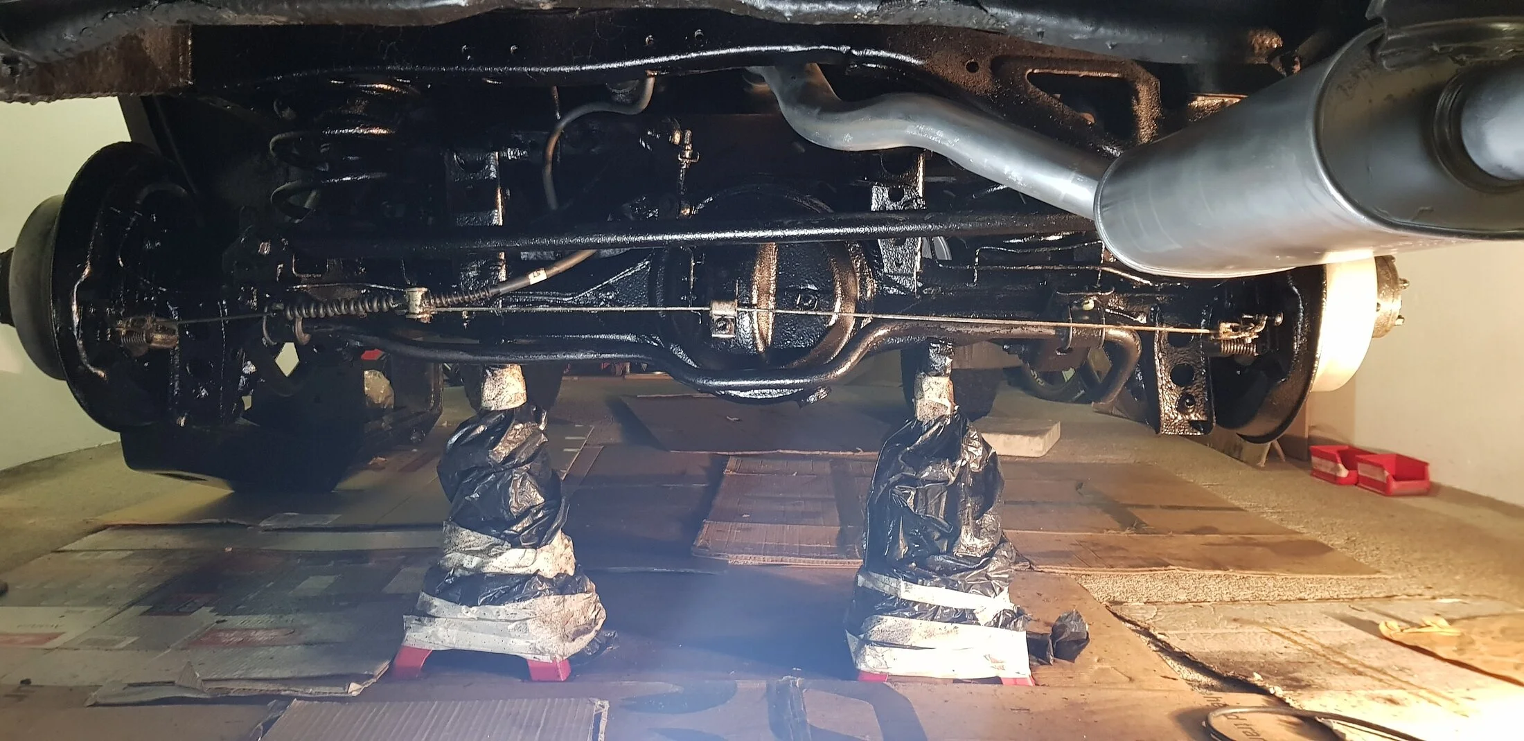

I recoated the rear axle and wheel wells over the winter with Dinitrol products (not sure if available in US but surely there's comparable stuff). We used that on heavy military trucks as additional rust protection from factory back when I worked in that industry.
It was a two-layer process, after cleaning (washing, ideally dry ice blasting) and removing surface rust (air needle scaler works great for that) the first layer is a thin, brownish penetrating oil
The second layer then is a thicker bitumen/wax based coat as a protective layer on top which dries up but stays elastic
