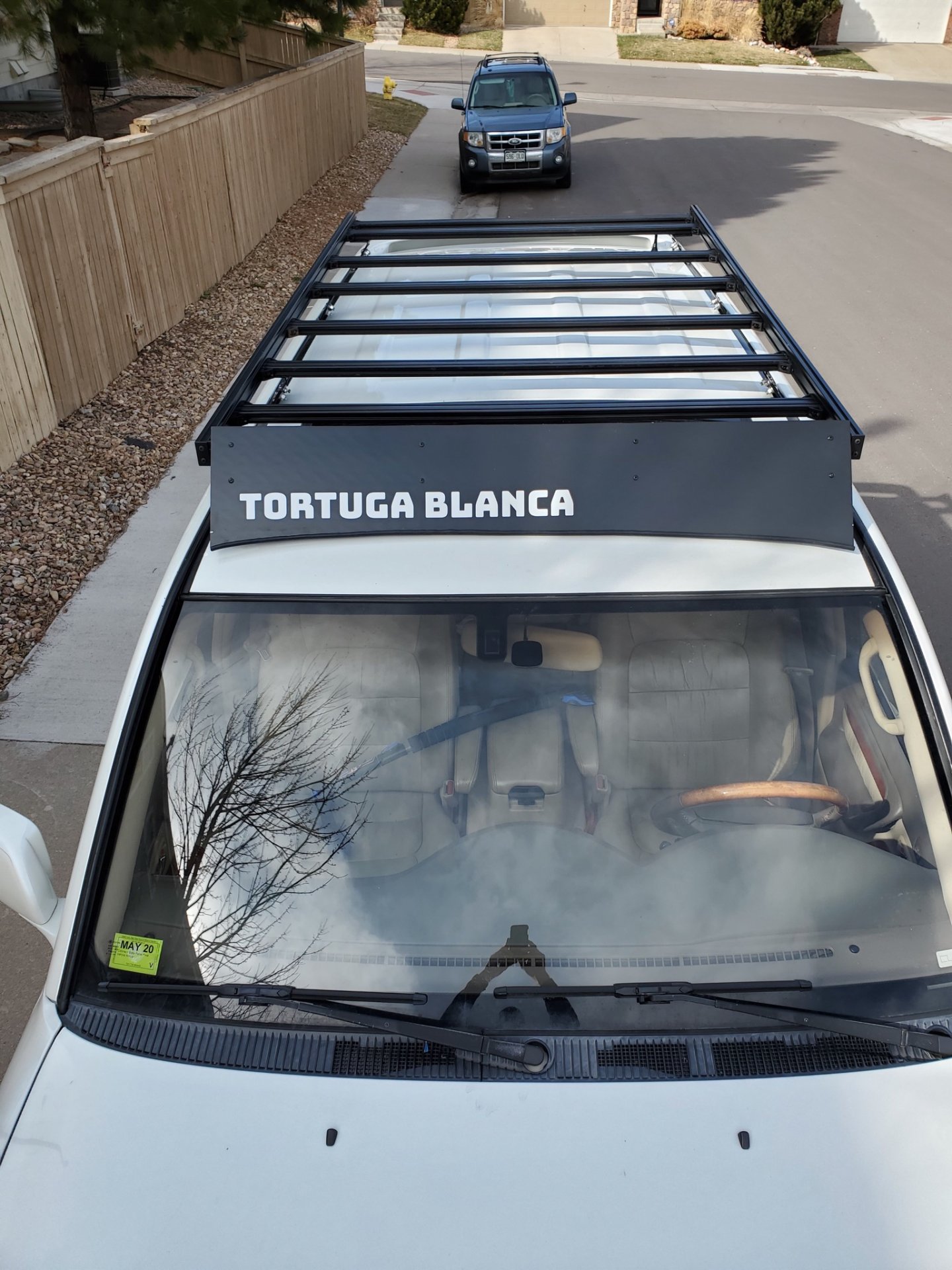

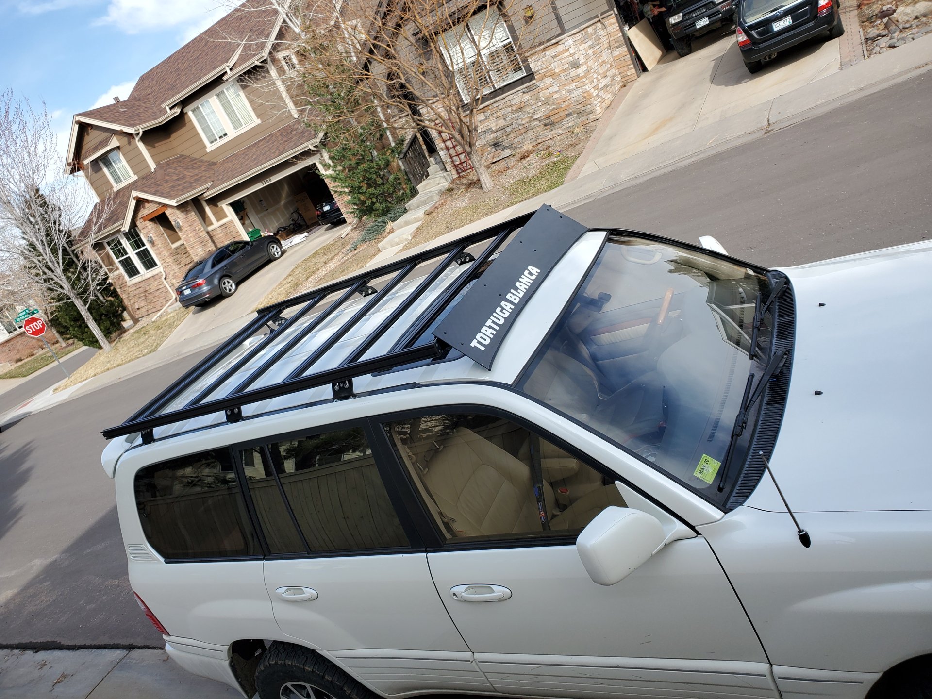

I've done it. I started with 80/20 in the factory rails, and bc I didn't want to throw away $800 of aluminum and hardware and swap out for a prinsu or whatever so I kept going with what I had and bought towers, rails, and more cross members. Also made my own wind fairing. yeah it's great that I can completely customize everything about it and it's strong af (series 15) but it was easily over double the cost of a prinsu and took some fiddling to get everything to work due to the curvature of the roof line.

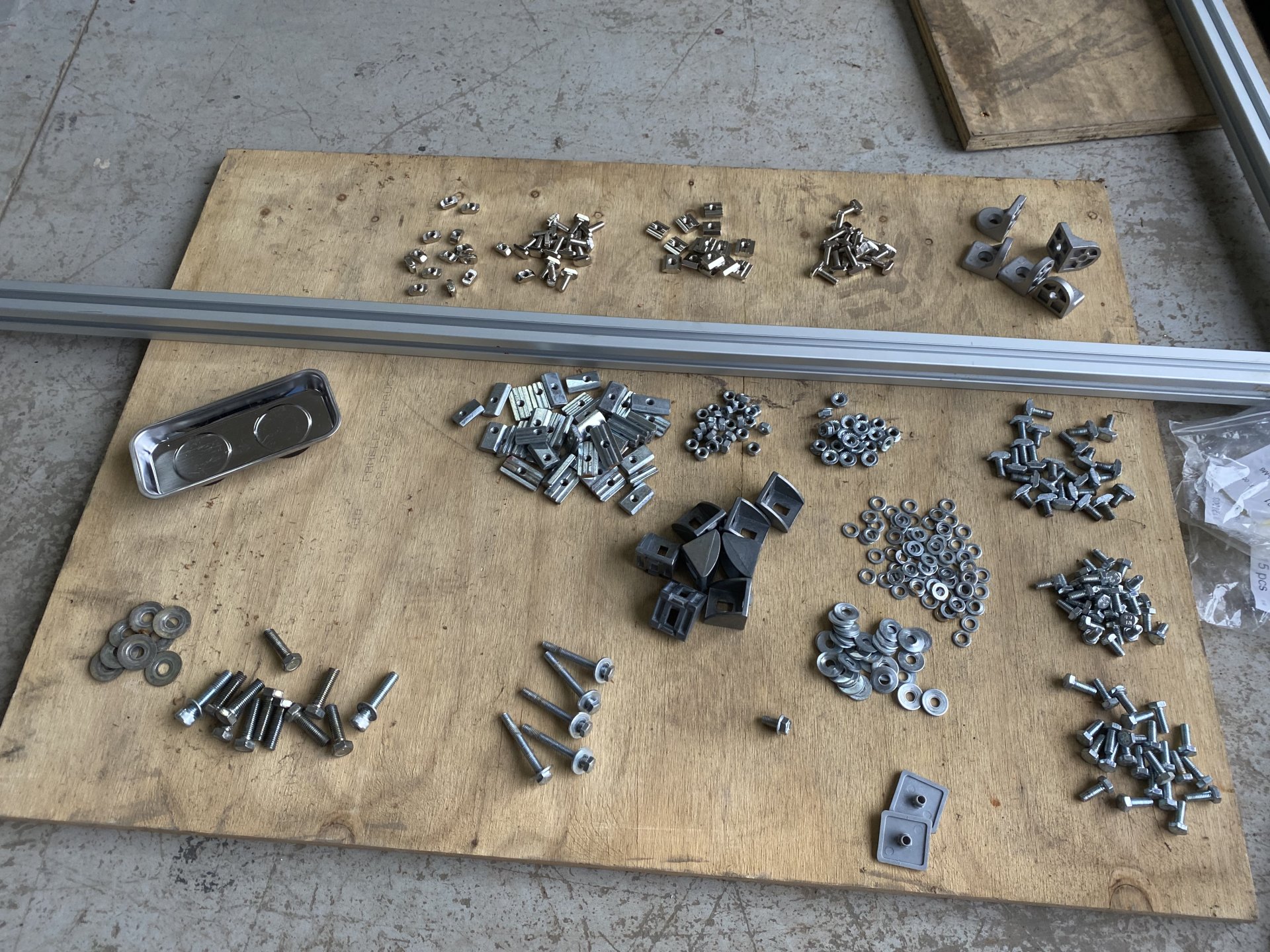

I built a rack and also built the towers. Unlike seemingly everybody else, I hated 8020. It costs too much, it's too fiddly and it needs a ton of fasteners. It's all fun and games until you find out you have to add a fastener in the middle of it and take everything apart to insert it.
If you can get regular aluminum welded it will come up much, much cheaper and easier. The only good thing about 8020 is that you can assemble it in your yard with no welding.
Just one correction, you don't need to take it apart to add new nuts if you just use drop in T-nuts.

Do you have a wind noise issue? Looks like some who go this route opt to buy or make a fairing.

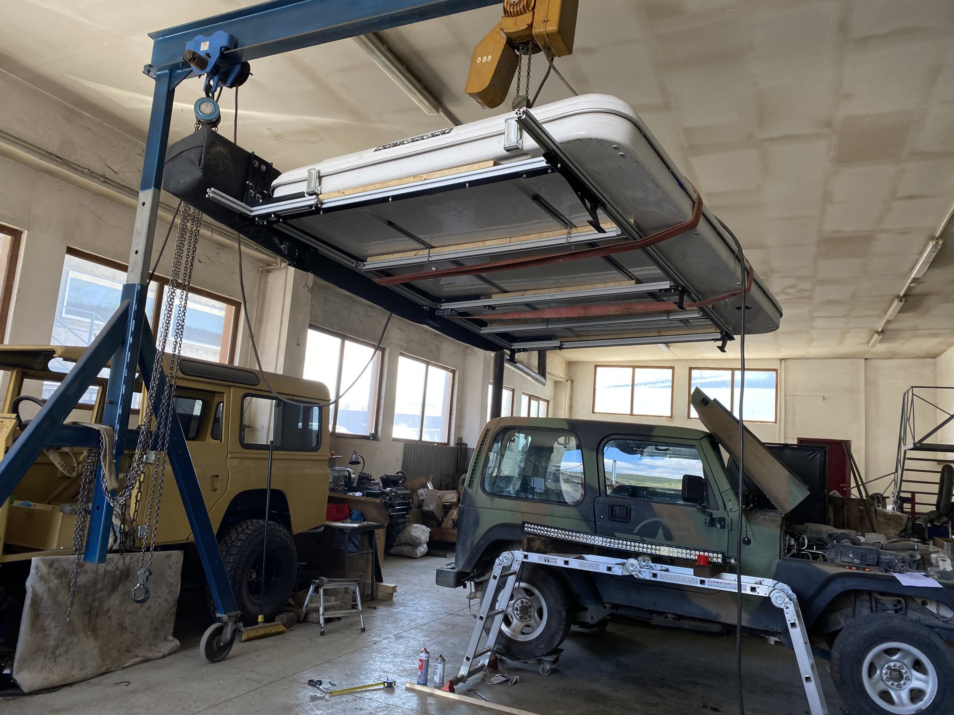

Rhino backbone rails work well with 8020. The Terrrapod RTT comes with 3 8020ish slotted aluminum extrusions. I pulled my tent off for the summer and left the load bars on.

On my 100 I had no real extra wind noise, on my wife’s gx460 there was but I taped the front of the bar to cover the front 8020 channel and that helped a lot
