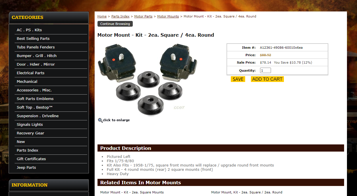

My experience with the 2F is that when the fan hits the radiator shroud on acceleration there is a bad motor mount that lets the engine lift and make contact.
Not sure if that is the same with a B motor?
Thinking outside the box. I’ll definitely look at the motor mounts. Thank you!
Your fan does not expand with RPM. Look carefully at the motor mounts. That is the most likely problem. Pretty standard and smack dab in the middle of the box. ;)
