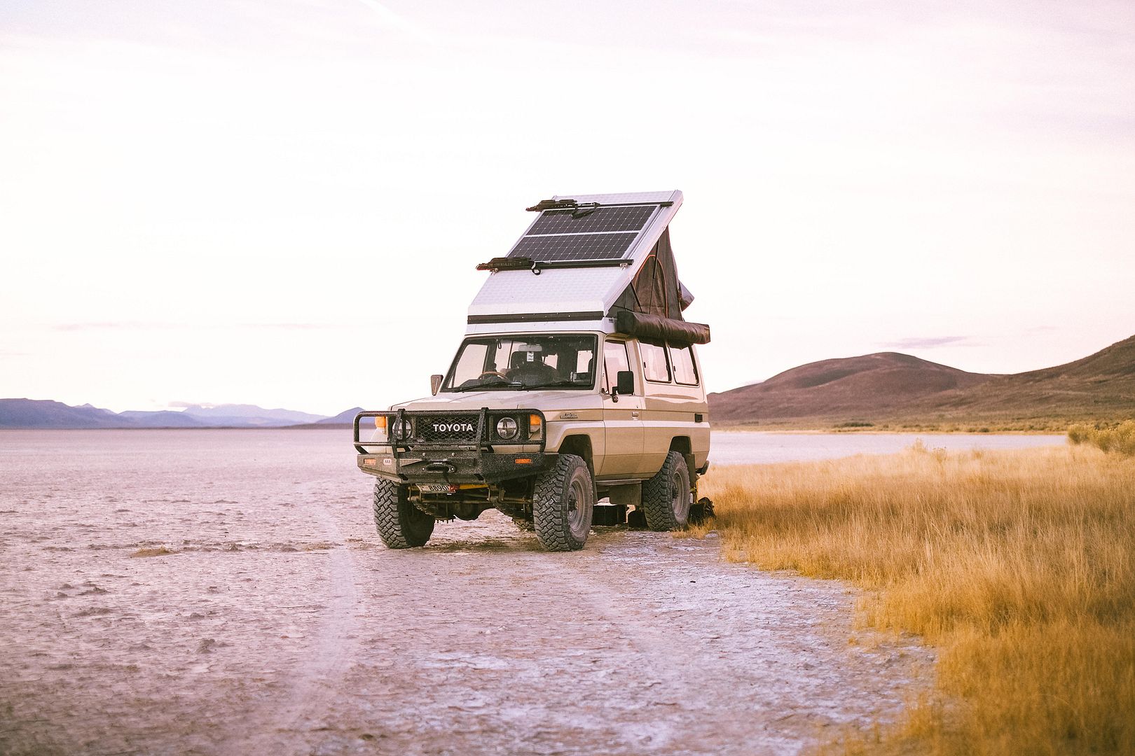

I put a PSP expedition top on it from the Netherlands and am very happy with it . Looks a lot better then Alucab to me
A friend is putting a PSP top on his over an AluCab too. The guy is coming here to fit it. Cost is much higher than Alucab, but I'll admit it looks so much better.

Alu cab doesn't look bad the PSP just looks better to me, we all have different preferences luckily ;-)
got any pics of the finished product?!
